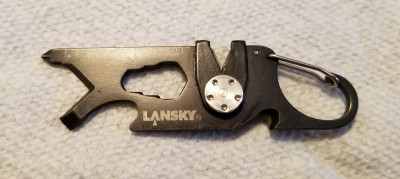

fergusontd wrote:This is a handy little item from Lansky I picked up at a gun shop. ftdPicsArt_02-07-09.15.20.jpg
I just purchased one of those.....haven't used it yet.

I had the impression that those V sharpeners are quick but they peel off too much metal.fergusontd wrote:This is a handy little item from Lansky I picked up at a gun shop. ftdPicsArt_02-07-09.15.20.jpg
Good suggestions! Thanks.

I just use it for touch up, usually 4-5 swipes works great in a pinch. I keep it on my keys for my new Ram. ftdEdgewise wrote:I had the impression that those V sharpeners are quick but they peel off too much metal.fergusontd wrote:This is a handy little item from Lansky I picked up at a gun shop. ftdPicsArt_02-07-09.15.20.jpg

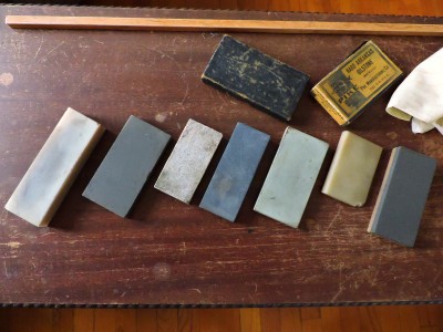

My advice is to scour the earth and flea markets and like venues for small stones.Edgewise wrote:I need some advice on sharpenening my edc pocket knives.
Can you recommend a small pocket sharpener that sharpens dry for touch up on the go?
Do sharpening stones need water or oil or do they sharpen dry?
Thanks!
There are many out there as well as larger stone that you should not ignore.
Here are some of my smaller stones. Not all of them are for touch up, as you desire.
The carborundum stones are better for that. The others are too hard but will refine a edge. Probably similar to your Dads stones.
I, personally, don't use oil. Water works quite well as would coffee or tea. Or oil.
Left to right ...........
1. This is perhaps a Lilly White Arkansas stone. 1 5/8" X 4 3/4"
2. White hard Arkansas. 2 X 3 7/8"
3. Ouachita stone. (Washita) 1 5/8" X 3 3/8"
4. Carborundum, coarse/fine. 1 1/2" X 4"
5. Carborundum razor hone. 2" X 4"
6. Hard Arkansas slip stone. 2" X 3"
7. Carborundum stone. 1 3/4" X 4"
Number 7 is a stone I keep in a bag that I carry from time to time.

Joe, like you I enjoy using old stones. They are not too hard to find at reasonable prices.

Don't dismiss all v sharpeners, some are ceramic rods and don't remove a lot of metal.

I can get Chinese ceramic V sharpeners for three or four dollars, free international shipping. Are they good enough?

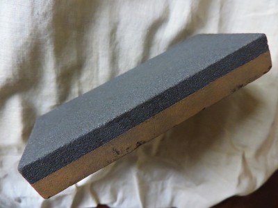

Meanwhile I shall do like FRJ suggests and dig up a small old carborundum stone. Dad's large one looks like the grey half of #7 and a smaller one looks like #6 but still too large for pocket carry.

For me, pull through sharpeners do not produce satisfactory results (I'm very picky). At 3-4 dollars though it wouldn't hurt to try one and see if they work out for you.Edgewise wrote:I can get Chinese ceramic V sharpeners for three or four dollars, free international shipping. Are they good enough?

Thank you, Paul. They are very affordable. I would be surprised if I have 18 or 20 dollars in those 7 stones.KnifeSlinger#81 wrote:Joe, like you I enjoy using old stones. They are not too hard to find at reasonable prices.
Lots of grits - lots of sizes = lots of options.

Thanks for the tip. I realized that you can't choose your edge angle with a pull through.KnifeSlinger#81 wrote:

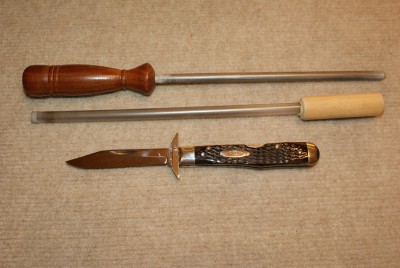

I just read this post about knife sharpeners. Forgive me if I have posted this Info. before. I put the correct edge angle on a knife that I want to sharpen with a Lanskey knife sharpening system. When I have the basic edge that I want, I finish the edge with, first a ceramic Rod, and then, for the razor edge that I want, i use a home fashioned quartz rod. The quartz rods are better than any of the several diamond sharpeners that I own, to get that razor edge I want. I found out about the quartz rods, while working in the electric trade, many years ago. The quartz rods are found in mercury vapor bulbs, and also in high pressure sodium bulbs. They are 1/4" in diameter, and range in length, from 4" to 12" in. depending on the size of the bulb. They have the bonus, of being obtainable free. You only have to find a electrician changing burned out bulbs in parking lot lights, and beg a few. Carefully break the outer glass of the bulb, and fashion a handle, to use them. They will touch up the edge on a razor knife, or a carpet knife, or filet knife, sharper than factory new with a few strokes.

Sut, back in my street light changing day those quartz rods were a popular item. Wish I had saved a couple. LED's kinda ruined that.Sut Tatersaul wrote:I just read this post about knife sharpeners. Forgive me if I have posted this Info. before. I put the correct edge angle on a knife that I want to sharpen with a Lanskey knife sharpening system. When I have the basic edge that I want, I finish the edge with, first a ceramic Rod, and then, for the razor edge that I want, i use a home fashioned quartz rod. The quartz rods are better than any of the several diamond sharpeners that I own, to get that razor edge I want. I found out about the quartz rods, while working in the electric trade, many years ago. The quartz rods are found in mercury vapor bulbs, and also in high pressure sodium bulbs. They are 1/4" in diameter, and range in length, from 4" to 12" in. depending on the size of the bulb. They have the bonus, of being obtainable free. You only have to find a electrician changing burned out bulbs in parking lot lights, and beg a few. Carefully break the outer glass of the bulb, and fashion a handle, to use them. They will touch up the edge on a razor knife, or a carpet knife, or filet knife, sharper than factory new with a few strokes.

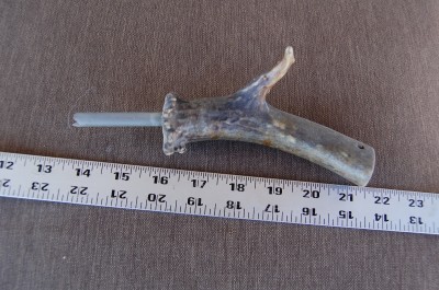

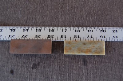

Here is a quartz rod that I put a piece of antler on for a handle, too big for a pocket user (rod is 9" long) Works really good in the shop. I have several 3" stones that I carry for field use, the white one is a Arkansas stone and the dark brown one is a ceramic stone (hard). I'm still a believer in some type of lub, spit, water, oil, or even Coleman fuel to keep the metal particles out of the stone pores. Be careful with the quartz rod , they break if dropped! I used to have a 6 incher which is now about 2 inches! see last photo
