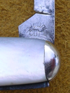

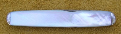

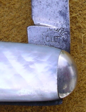

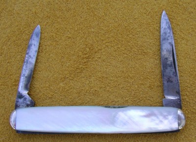

Here is a 3" pearl senator pen with sunk joints and milled liners. This was a top end knife. The tangs are worn but might be "Case Bros" in arch, over "Cut" and on secondary there looks to be something under the "Cut". It could be the top portion of "CO" ? but looks more like 3 characters, not 2.
I would like to know how you read these markings and what date range would you assign to it.
If it is Case Bros. Cut. is this a fairly rare marking ? Not directly related to the Big Case ?
I obviously need help here. Thanks,
kj

Nice knife KJ. Looks like a rare early Case marking. Is there anything under the word CUT? perhaps "CO." That would be c.1912 or earlier. Looks like the bolsters are beveled to help retain the pearl handles, is that correct?

Thanks for this help. I think my knife has the same stamping as more easily seen on Greg's knife. I can just see the top bit of what likely is "CO". Yes the bolsters are slanted to allow edge of pearl to slide under.
You can feel that it is a very well made knife. 1900-1912 according to Goins.
Is this company related to W.R. Case ? or to Cattaraugus Knife Co. ? Early on there seems to have been quite a few different knife companies all with "Case" in their name.
