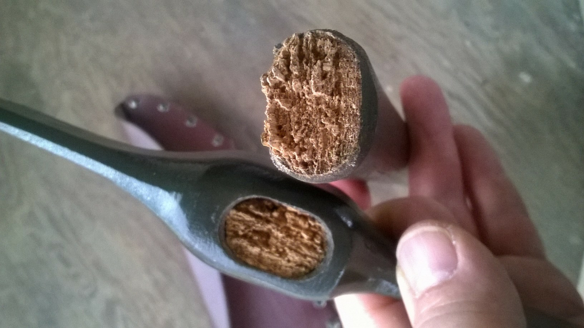

Dukie (the German Shorthaired Pointer) and I decided to do some mountain hiking today to check out 24 acres my brother just bought that abutts our farm property. Upon checking the survey markers I stumbled on an old fence post with 3 square nails in it. The bottom nail pulled out easily by hand so I figured I could use the pointed end of my American Tomahawk Co. to free another nail that was already in a stress crack. Well, the nail was more secured than I imagined and even using a piece of wood to baton the point in next to the nail didn't loosen it. In fact, I ended up breaking the handle out of my tomahawk and the nail eventually broke off before coming out.
Arriving back home I was determimed to fix the tomahawk. First I used a big punch and hammer to get the broken handle piece out of the hawk head. Then I scored the handle with my trusty Remington 100B pocket knife to the place where I felt the head needed to seat on the handle. Turning to the Remington for use as a whittler, I sized the handle so it could be inserted tightly back into the head. A rubber hammer worked for that and then I hammered the wedge back in, added some wood glue and waited for it to dry.
Everything turned out well enough to get my tomahawk back in business without beating all the paint off of it. Tomorrow I will see just how durable my fix was. The remaining handle, though an inch shorter, seems to have decent integrity so I expect it will remain as my user for odd cutting jobs around the farm when carry a chainsaw would be too exhausting.

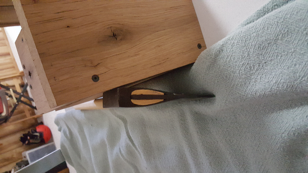

When I got the basic shape down I traced the profile of the head on the handle. Make sure you leave extra handle sticking through, and a little extra on the shoulders, I screwed up cutting the wedge grove in the handle, and had to cut it off and set it lower. A good hand saw would probably be best for the wedge slot, but, I wound up doing it with a band saw slow and easy.

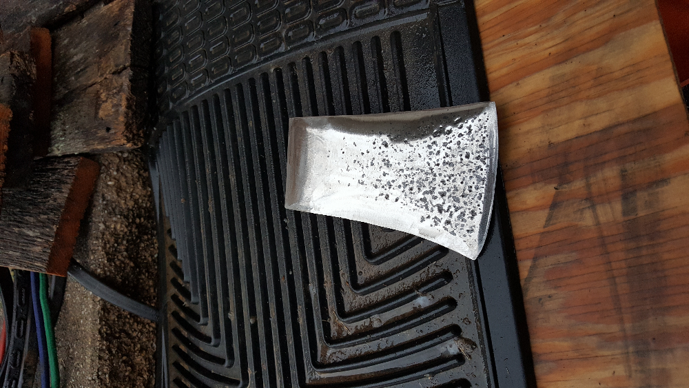

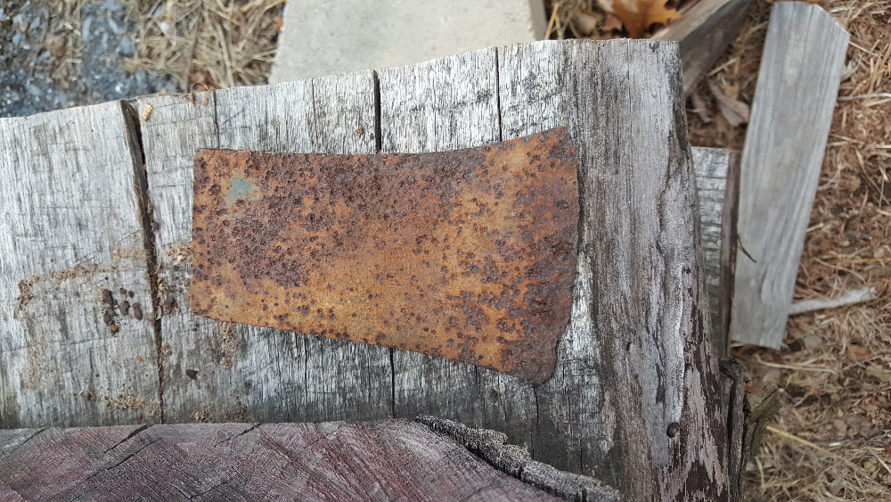

The final project turned out well, I left a bit of a knob on the end so it won't come flying out of my grip when throwing. I used a piece of Black Walnut for the wedge, and shaped it on a little belt sander, just matched it to a Poplar wedge that came with a store bought handle. Mounting this head was harder than it should have been. When I found the head it was a solid chunk of rust. I ground over 8 ounces of steel off of it to polish it. In the process I ground too much off one side, so the head had to be fit deeper on one side than the other. When i screwed up on the wedge slot, and had to set the head down mre, I didn't have enough shoulder left to get it tighter on one side, but it's close. Then I hand rube several coats of boiled linseed oil, and a final coat of Johnsons floor wax. I put an edge on it that will shave hair of your arm. Since this is a Boys Ax head, on a hatchet length handle, it's a little head heavy, but it throws well. I chopped down a little Gum tree in my woods and it was throwing chips almost the size of my palm, but was tiring to swing one handed, and too short to get two hands on it. It does make a good camp ax too, works good on chopping kindling. But, you have to be real careful. With the extra weight of the Boys ax, and super sharp, it will take a finger off in a blink.

Sorry for getting back to you so late but excellent work!rarefish383 wrote:Here's where it started, Joe
