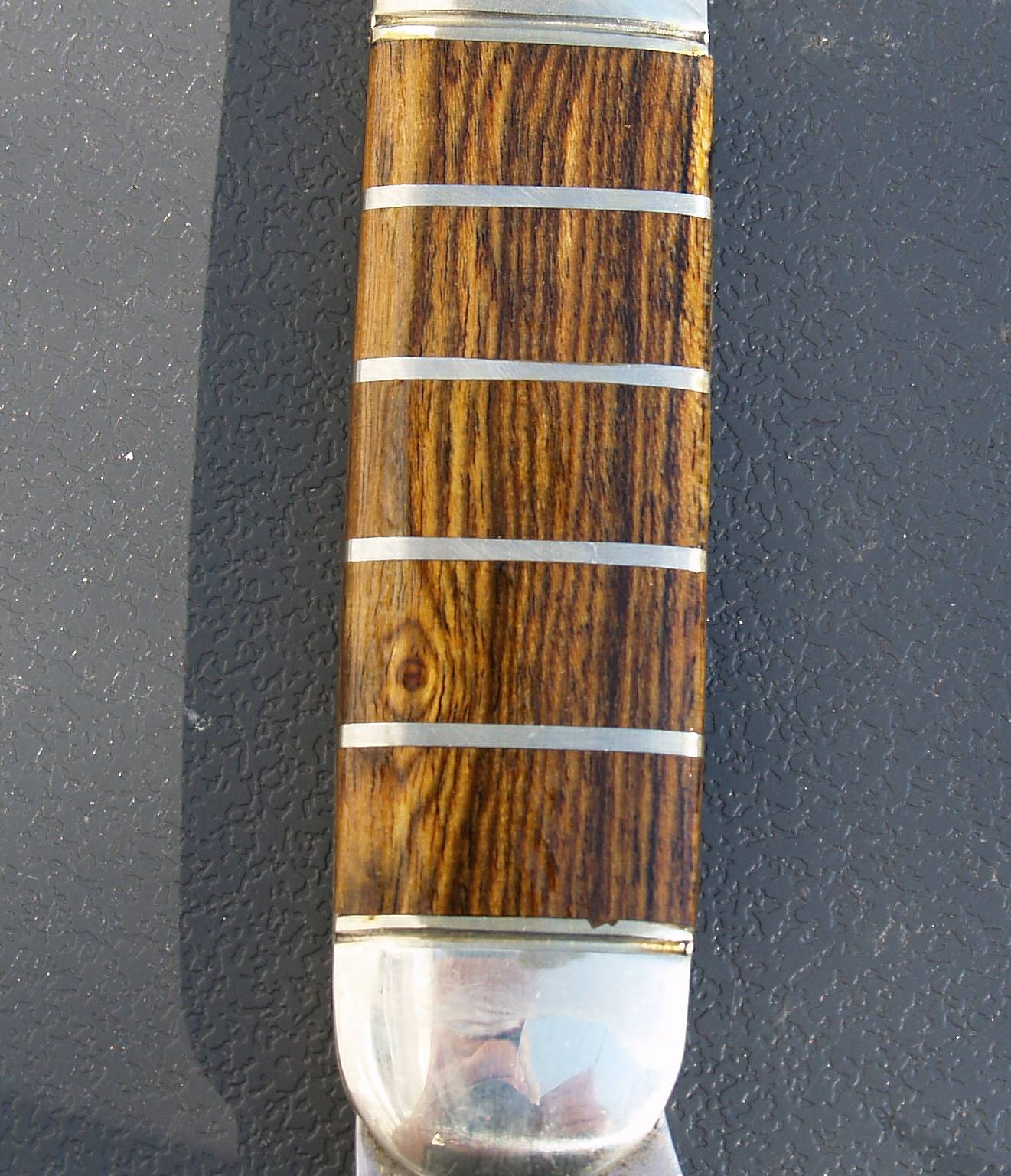

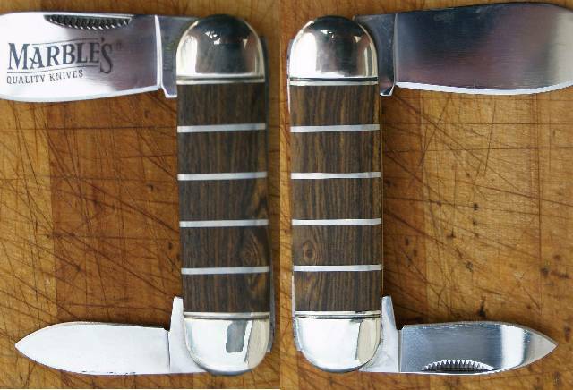

MM, please don't take offense, this is your idea and imitation is the truest form of flattery. After seeing one of your pieces of art I decided to try and came up with this. As it has been stated there are several types of Cordia and I haven't a clue which one this is. I only have a slight idea of how difficult it was for you to make the original. Practice makes perfect and I really love this stuff.

mike, that looks real good. Couldn't take offense if I wanted to becuase I didn't do the original,. that was Darksevs idea and looks great.

Looks good ::tu:: Looks like Bocote though there are more than one species of Bocote also. ::tu:: ::tu::

Then, my apologies go to Darksev for stealing his idea. Thought I saw the original on your site. Now I have to get the other side but it should be much easier since I figured out how to solve all the probs on the first . Clean up and fine finish will be the frosting on the cake.

I think it looks great the way you kept the grain in line thats outstanding work.

Yeah, it looks good, I like Bocote with a tight grain. Lets see there's Cordia elatinoides and Cordia elaegnoides that I know of. ::dang:: Of course you know I had to look it up. Why memorize something you can look up? Maybe that explains my memory or lack of one. :roll: :roll: :lol:
Nice looking knife there - keep it going. Just curious, what adhesive are you using? I have several that I favor and I like to ask what others are using. ::tu:: ::tu::

The adhesive I use is loctite quick set 5 min. It allows me to hold the pieces in place for the hardening cycle. Don't think any of my knives are going to endure extreme durability tests or I would probably use some other epoxy. Will post more pics when final finish is complete. Thx for the compliments re; grain. That made it a little more complicated. Had to allow for the nickle silver spacers and try to make all segments equal in size. What I cut out for the spacers was equal to their width,,, 1/16", ie; kerf cut plus polish 2 wood sawcut edges= .066. All wood segments are .474 wide

I glued/epoxied each side individually. I was afraid the 2 sides of the knife weren't identical and wasn't smart enough to make 1 big slab. Also, my scraps mtl only allowed me to make it "ladder style" Worked out better tho, the second side was much easier since I had worked up the dimension problems for the first side. The pic doesn't really show it but all segments are equal; .474" and parallel. Some slight "fisheye effect" with closeup lens.
