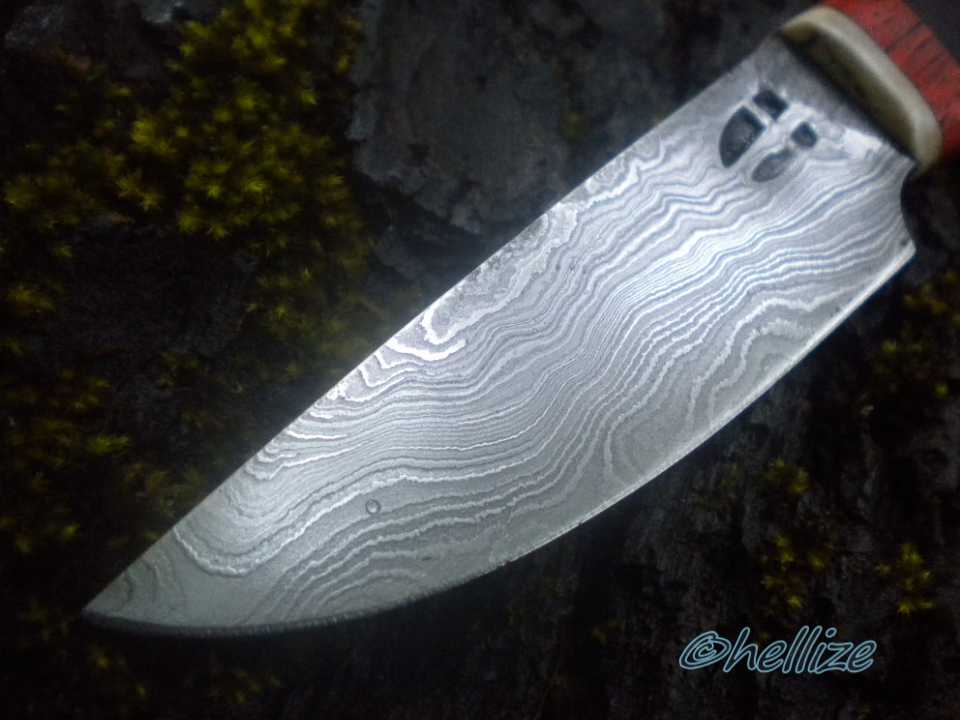

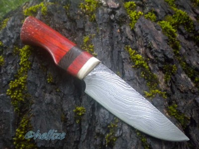

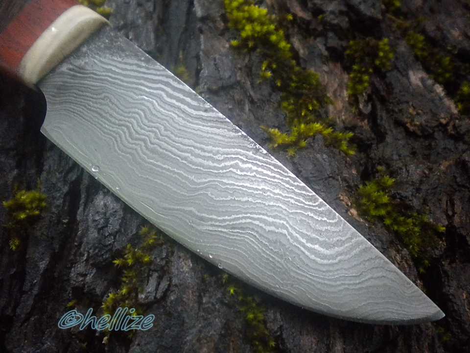

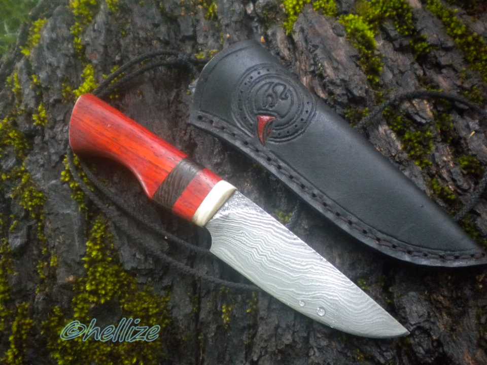

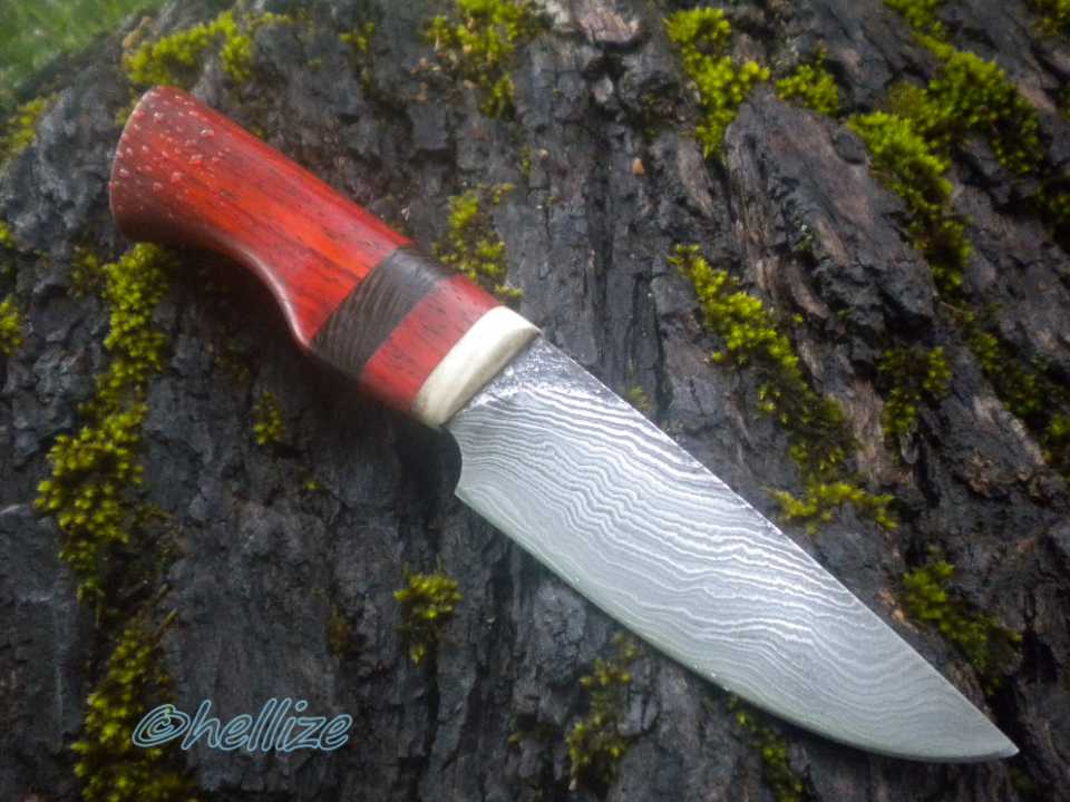

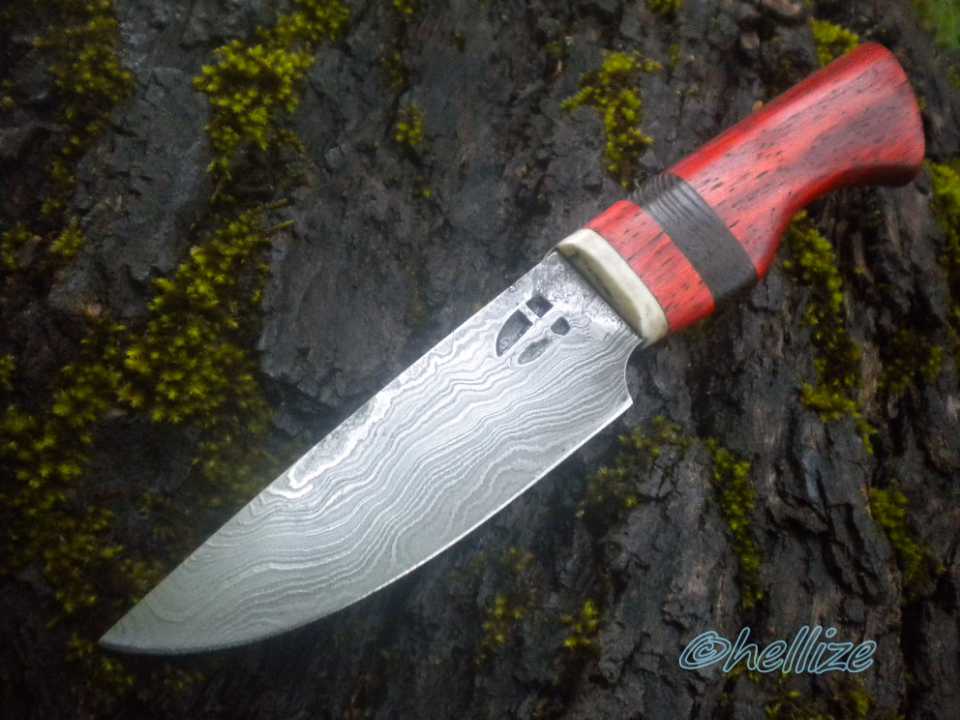

The knife is 21.5 cm long. The blade is 10.5 cm long 3.2 cm wide and 5 mm thick at its base, which gets gradually thinner till the tip. I forged it of 5160, 1.2516 and L6 steels, with about 200 layers.

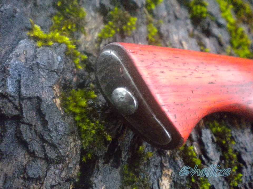

Its handle is made of antler, padouk and wenge, with iron accessories.

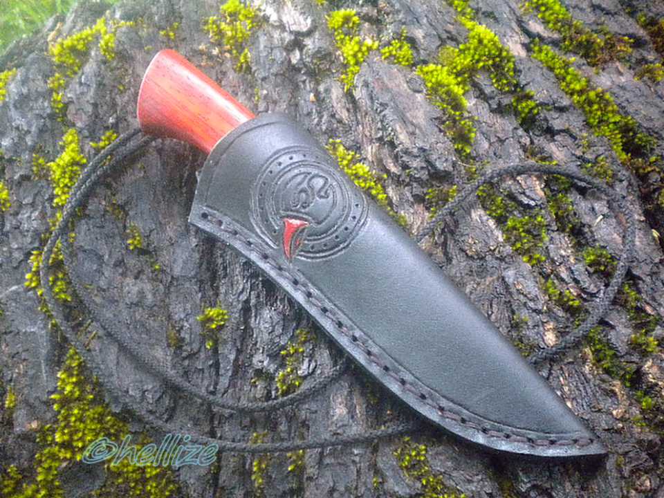

The sheath is made of thick cowhide.

hellize, A beautiful piece of work. The pattern on the blade is super. Love everything about it.

Well, it is a weirdly un-wild pattern, compared to what I usually make. But I like them all anyway

Well we already know your forging skills are amazing !!!
But how bout the shape of the handle on this one....
new ground for you bud...how does it feel in the hand ???
I gotta know, very unique and interesting...and I meant to
ask you in one of the other pieces you done, I take that is
your mark on the front rather than your name or initials hey ???

Well, the handle is a not new design. I have made several other like this one some time ago, although with different materials, but the shape was largely the same.
It is not a "full grip" handle if you know what I mean. This design of mine is mostly used at smaller neck knives, which are better for more delicate things, not for hacking around as my other robust examples.
It does have enough space for all 4 fingers, but it is a lotmore usable with 3-3.5 fingers.
My mark is a hoof print (my friends call me moose, hence the mark
