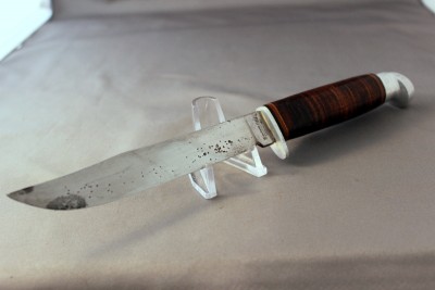

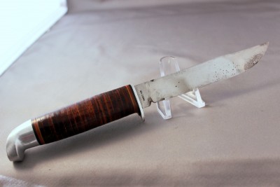

Guys, I am attaching photos of a Western Field fixed blade knife. I looks like it might have been made by Western but without the double tang, I doubt it was made by them.
Any ideas as to who might have made this for Montgomery Wards?

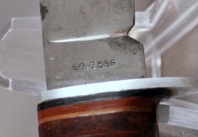

I have a bunch of Western reject blades and that one looks quite a bit like their L66 model. Even the designation on the back of yours seems to cooberate that.Look at the top two blades in the picture.

Gut reaction is .... Western.
Note - edited to add pics
While MOST of the fixed blades Western produced from 1934 to 1990 were split-tangs, there were a significant number of models produced with "standard" full tang blades --- Bx54 Bushman, W49, W47, W45, W43, Westmark 701, 702, 702, all of the W-series fillet knives.
Here's my reasoning.
Western had a contract w/ Monkey Wards to make Western Field knives during the 1950s. This conclusion is based on split tang WF knives.
Western had a short-lived re-introduction of the WEST-CUT line with the K1/K2/K3/K5/645 knives in 1958. (Short-lived as they were NOT in the 1960 catalog pages.) The "K" knives were NOT made using split-tang. K1/K2/K3 were B&T knives, similar in size and shape to the (L/F) 58/48A/48B models.
The K1 = similar to the L58
And I can't find my K2 pic
- but it looks like an L48A
The K3 = similar to the L48B
The K5 is similar in size/shape of the 66 knives (L66/F66) of the same era.
The 645 was a 2 pin hunter resembling other companies 1940s/1950s hunters.
Without a flat picture with a ruler to show profile and blade/knife length clearly, it APPEARS that your knife is about 9" OAL. If so, it would be a twin sister to the K1 - 9-3/8" OAL, which was a single pin, non-split-tang B&T. If it's about 8" OAL, the K2 and if a tad over 7", the K3.

Thanks for all the help on this and apologies for failing to provide measurements. I got it at 9¼ inches OAL.
I think now it is one of those 'if it quacks like a duck, it must be a duck' situations or in this case, a Western.
Again, thanks for the info on this one.
Ray
