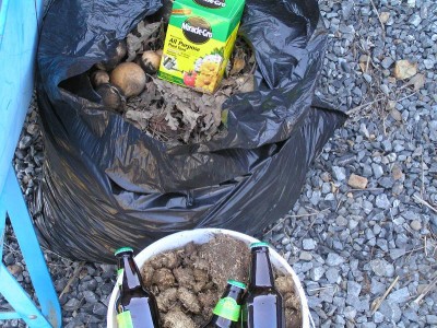

Well this picture kind of shows it all. :lol: :lol: The file comment says it all, much more than you want to know I'm sure.
Anyhow since I first read about spalting your own wood I have been waiting for the weather to warm up. This is the website where I first got this VERY WEIRD idea.
http://www.woodcentral.com/russ/russ4.shtml
The ingredients are all here except the wood, white oak in this case, it's still green and that was what was purchased for firewood. I just kept it in a moist environment to keep it from drying out.This process will take about 2 months.
I will double the "recipe" because of the amount of wood I have.
2-qt water in this case the wood has soaked in the water, black with tannins now.
4-scoops Miracle grow
4-cans beer, Actually I cultured yeast from this beer in the past, I may want to try again.
2-qt horse manure, fresh from the horses hind end :mrgreen:
2-qt dried oak leaves
Actually I could make this recipe 20 times over. The expensive part is the beer. :roll: :roll: Well, I guess we'll see what the wood looks like in 2 months. After 2 months ONE thing I know for sure is that it will stink something terrible.
Beer, Miracle Grow, Oak leaf mold, Black Oak and White Oak species, and horse manure fresh from the Horses Rump on 3-19.

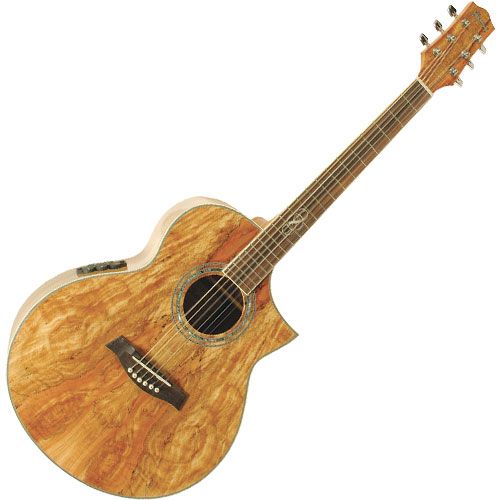

Spalting occurs when a fungus grows in the wood. It leaves beautiful patterns & colors in the wood.
Check out this link & see some pretty spalted wood.
http://www.hobbithouseinc.com/personal/ ... palted.htm
Below is a pic of a guitar made from spalted maple.
Spalted wood makes beautiful knife handles.
Ibanez guitar spalted maple.jpg (27.8 KiB) Viewed 2782 times

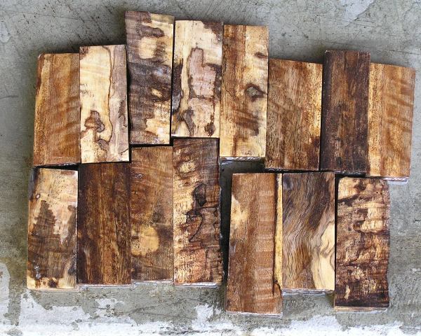

Sure, spalted wood is wood that has markings and discolorations that make it distinctive looking and splating is just before rot. Let it go to long, you end up with rotted wood. Spalted wood brings in way more $$ than plain wood, its in high demand.
Here's a good article on spalted wood: http://en.wikipedia.org/wiki/Spalting
So all I'm doing is getting the wood set up so that it will be attacked by fungi that will leave behind nice coloration - hopefully.
Her is a picture of spalted mango. Without any spalting, this would be a a rather plain pice of wood, most all the color is due to spalting.
Here's another good one:
http://images.google.com/imgres?imgurl= ... n%26sa%3DN
So what I'm doing is geeting the wood so that it is an atractive place for Fungus to live and so that it colors the wood. Spalt does weaken the wood
but I send spalted wood out for stabilization.
A $5.00 block of Maple can be spalted and if the colors look good, then the price can go $30 to $40.00 and up.
Spalted Mango
Spalted Mango
Spalted Mango 001 - Copy.JPG (93.98 KiB) Viewed 2778 times
