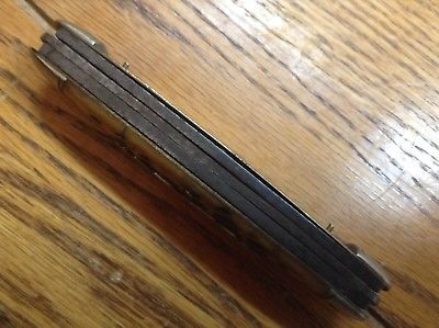

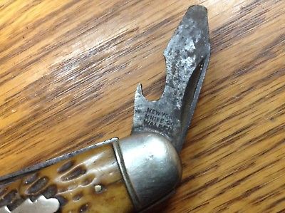

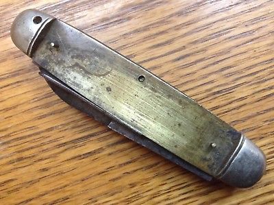

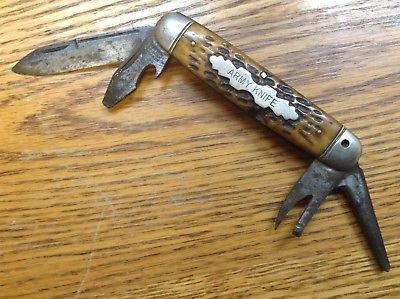

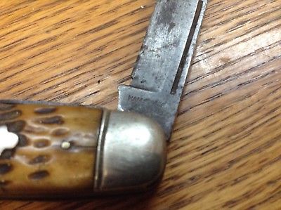

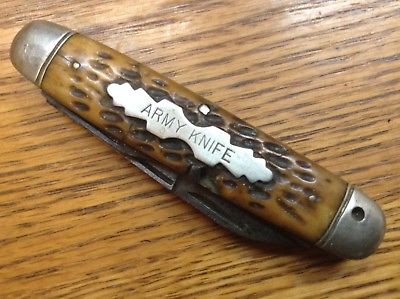

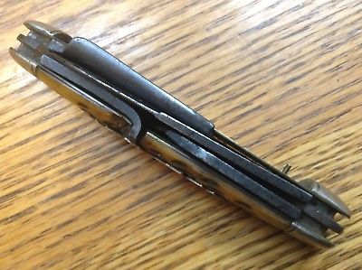

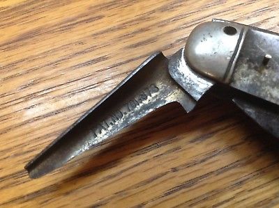

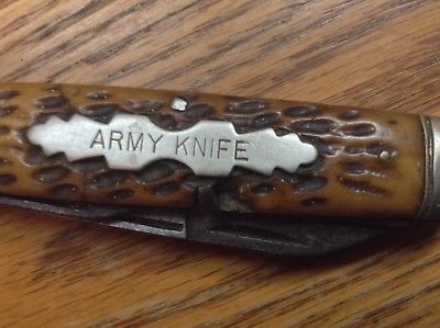

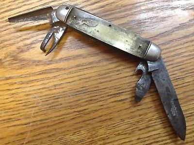

Can this knife be salvaged? It was my grandfather's and I'd love to have it restored as close to original as possible.
It is a New York Knife Co Walden Hammer Brand Army Pocket Knife. It is missing 1 complete grip and there is a
piece of the existing handle missing, below the "FE" in knife. Also the blade and tools have issues.

Absolutely! that knife can be restored to an acceptable condition. If you want to keep it original you need to find other knives like this with good parts. Maybe you can find a knife with a good front handle and then another with a good back handle. You might also look for a bail and punch and also have the blades cleaned up a bit. When you have found all of the parts you need it wouldn't be hard to reassemble the knife with better parts. A good way to find parts is to put an ad on AAPK and then also watch ebay for knives like yours that are damaged. The alternative is to buy modern handle material from a company like Culpepper and have the knife modified. Only my 2¢ but I would keep it original as possible and look for parts. It might surprise you but I don't think those parts would be that hard to find.

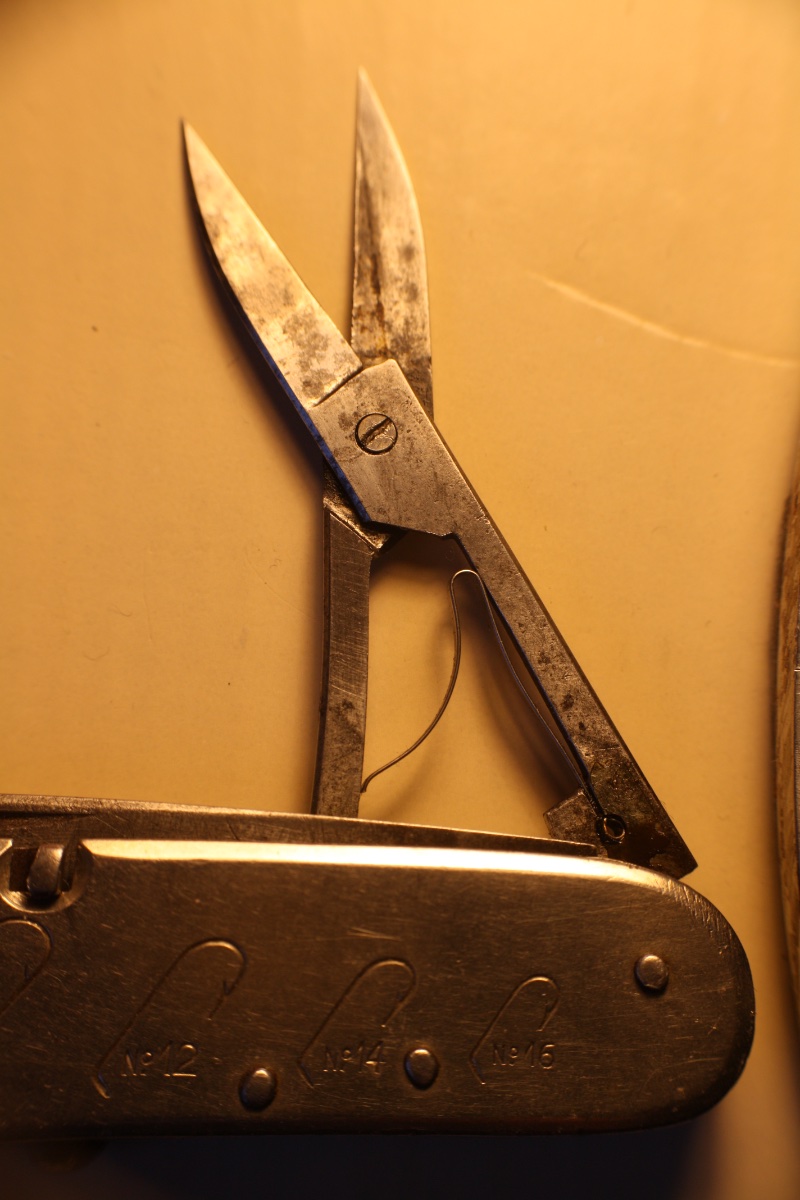

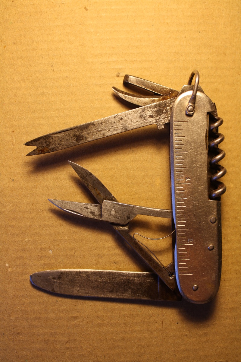

USING VICTORINOX SPARES ON KNIVES OF OTHER MAKES
I have a well-made fisherman's knife marked foreign on the tang. I assume from its quality it is of German manufacture. Whilst liking the knife, its scissors detracted from it, having lost their spring. Few manufacturers supply spares for their knives, with the exception of Victorinox, and not knowing the manufacturer I set about repairing the knife with a Swiss Army Knife spring.
I used a Victorinox A3757 91mm knife spring. Fitting required drilling the existing hole out to 1.5mm and pressing the spring into position. Discovering the spring was slightly too long, it was shortened by grinding its free end on a bench grinder. The spring was a tight enough fit not to need epoxy or Locktite.
A purist might not like the fact that the knife is now slightly non-standard but it works well and a missing spring doesn't draw the eye.
Its tools are a main blade, tin opener, disgorger/file, scissors and a corkscrew. It has stainless steel sides, no separate scales. One is engraved with a measuring scale in inches and the other with fishhooks of five different sizes, No 8 to No 15. A bale and a screwdriver tip are fitted.
The 'Foreign' marking and the scale in inches suggest the knife was of German manufacture for export.
The troubles in the Ukraine seem to have stopped the supply of a wider range of SAK spare parts on ebay. One hopes the situation will settle down and the business restart.
