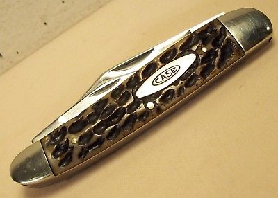

This one's a total disgrace! https://www.ebay.com/itm/atq-vtg-CASE-T ... Swa6Jb4OPk.
Note the shield from a 1970s knife. The routing job in the bone around the shield looks like it was done by a drunk! Bone jigging and color don't even remotely look like Case. Seller description says it's peach seed bone! ::rotflol::

I do not know enough about Case Tested to have an opinion about the handles other than that it obviously not peach seed jigging, or any Case jigging that I am familiar with. I will say that the seller has posted an extremely good set of photos of the knife. I wish more Ebay sellers posted as good of photos as his.

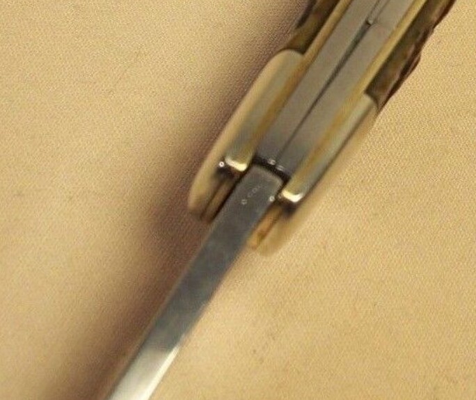

There is one thing that makes me think that the knife might be a genuine Case. Where the back of the main blade and springs meet, instead of a smooth transition there appears to be an uneven step down from backsprings to blade. That is something I only see in Case 6380s and some German whittlers, never in China knives.

It may be Case blades and frame. It's not Tested, and those handle covers don't look like a Case. The seller offers a refund so may not know what they're selling. ::shrug:: Doesn't mean the knife is right - it's not.

Other than the shield, no part of that knife is real Case. I don't know what it was made out of, but not a Case.

knifeaholic wrote:Other than the shield, no part of that knife is real Case. I don't know what it was made out of, but not a Case.
That's pretty much Gospel as far as I'm concerned.
I am certainly not going to argue the the man who wrote the book!
One thing that puzzles me: after going to the trouble to make a fake Case, why chose scales that are not like anything that Case used? I guess I just do not think like a counterfeiter.

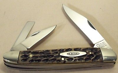

As far as fakes go, ive seen worse :) lol.
the 80 being a highly faked knife out of Kentucky usually has its own signature handle, which this is not.
Although this doesn't look as good as "pick bone" style from back in the day, maybe that the was the look it was going for.

The shield is a Case shield, but you would think they would use a tested era shield with the smaller, closed c, and put more realistic handles on it.

smokeon wrote:The shield is a Case shield, but you would think they would use a tested era shield with the smaller, closed c, and put more realistic handles on it.
Tested shields are more difficult to find. These counterfeiters rely on ignorant buyers who dont know the difference - too many uninformed collectors just read the letters on the stamp or shield without knowing how to read the rest of the knife. I was that gullible once myself. ::facepalm:: If you're not able to spot the other "tells", you're probably not knowledgeable enough to know the differences between shields either.
If you could come up with a source for realistic old Case greenbone,you would be counterfeiters best friend.
