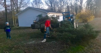

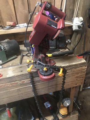

I never realized just how bad I was at free hand sharpening a chainsaw until tonight. I set up this el cheapo harbor freight chainsaw sharpener and touched up the chains I’d been free handing. What a difference!
I cut down and limbed this half dead fir tree and it went like a knife through hot butter. Not bad for less than $30 for the sharpener. I reckon it’ll pay for itself with about two sharpenings.

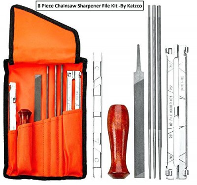

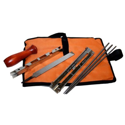

My uncle Tony bought one of these electric sharpener with the grinding wheel , this same type sharpeners but it wasn't an HF it was actually Made in Italy and who he ordered it from I could not say but they sure will up the saws performance in cutting because they automatically put the right angles in with a simple adjustment......I too learned this the hard way after fighting several jobs on evergreens.......I bought this set shown below, the only problem that I had was that I was sharpening it by eye sight too and not using the guide in my Kit you see here.......I also filed the raker's on the blade......if the raker's stick up to high this is what leads to you burning your blade and is usually why everyone scratches their heads and asks why isn't my saw cutting......this is why, the raker's are to high not allowing the tooth to cut........anyways I started using the Angle Guide ever since I caught on - makes a big difference - Nice Score on the Sharpener HF always has good deals at low prices and you can always get a free flashlight with the free flashlight add or a pair of scissors or something with each visit. My Dad gave me a Craftsman 18" 40 something CC engine and I use it all the time its my go to for bigger jobs around the house and ranch......I also have a Ryobi Pole Saw for hard to reach Limbs it is a Small Blade but it does the Job too.

You’re right about the rakers. Even on a new chain I usually take them down a bit. I like the saw to pull itself through the wood.Mountain Man Knives wrote:My uncle Tony bought one of these electric sharpener with the grinding wheel , this same type sharpeners but it wasn't an HF it was actually Made in Italy and who he ordered it from I could not say but they sure will up the saws performance in cutting because they automatically put the right angles in with a simple adjustment......I too learned this the hard way after fighting several jobs on evergreens.......I bought this set shown below, the only problem that I had was that I was sharpening it by eye sight too and not using the guide in my Kit you see here.......I also filed the raker's on the blade......if the raker's stick up to high this is what leads to you burning your blade and is usually why everyone scratches their heads and asks why isn't my saw cutting......this is why, the raker's are to high not allowing the tooth to cut........anyways I started using the Angle Guide ever since I caught on - makes a bug differnce - Nice Score on the Sharpener HF always has good deals at low prices and you can always get a free flashlight with the free flashlight add or a pair of scissors or something with each visit. My Dad gave me a Craftsman 18" 40 something CC engine and I use it all the time its my go to for bigger jobs around the house and ranch......I also have a Ryobi Pole Saw for hard to reach Limbs it is a Small Blade but it does the Job too.

After having several brands of chain saws over the years I finally bought a Stihl. Best chainsaw by far! With it I got one of those sharpener kits like Mountain Man showed. Very quick and easy to touch up the chain with it. The key is to use the angle guide. And you don’t have to remove the chain from the bar to use it!
I do keep a sharpened spare chain in the case with the saw, so I can quickly change to sharp chain when needed.

..........maybe this is what I need to get, mine doesn't cut good anymore , either!!!..........Colonel26 wrote:I never realized just how bad I was at free hand sharpening a chainsaw until tonight. I set up this el cheapo harbor freight chainsaw sharpener and touched up the chains I’d been free handing. What a difference!

They work really well. I was impressed.carrmillus wrote:..........maybe this is what I need to get, mine doesn't cut good anymore , either!!!..........Colonel26 wrote:I never realized just how bad I was at free hand sharpening a chainsaw until tonight. I set up this el cheapo harbor freight chainsaw sharpener and touched up the chains I’d been free handing. What a difference!
