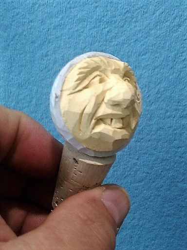

https://www.dropbox.com/s/0u4038cul7xj5 ... 1.jpg?dl=0
https://www.dropbox.com/s/q9po25mhhicet ... 2.jpg?dl=0
https://www.dropbox.com/s/g421rx22c4j9g ... 1.jpg?dl=0
Here are a couple of golf ball "trolls" that I made.
One has been mounted on a cork - with a dowel through it, and the other one is still on the handle.
Most golf balls these days are of two piece construction - the outer cover and the rubber inner core. (some are made differently)
There are lots of different colors in the inner part depending on the brand and compression and ??? of the balls. They take acrylic paint well too.

After drilling the hole and jamming in the handle (it is best if you make that handle a little oversize so that it is necessary to force it into place), draw a line around the ball, and then using a hacksaw, carefully cut all the way around the ball along the line. You will feel the saw go through the cover.
Then using a screw driver (hopefully a worn one without sharp corners) pry off the half of the cover. After a bit of fiddling it will pop off.
Then whittle away!

Actually, the rubber insides of most golf balls is easier to carve than basswood. No grain to contend with either.
One thing that is a bit of a concern is that when a cut is made and the knife removed, there is no visible line left! The cut is there, it is just almost impossible to see.

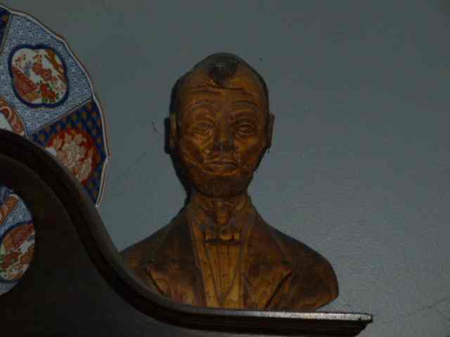

They actually sell a tool to cut the cover on golf balls for carving. They were making them at the Wood Carvers Round Up. Evert, Mich. As for figure carving, many draw or transfer a pattern then band saw out most of the waste. Just hold it in your hand. When I carved my bass wood Abe Lincoln's bust, I made a rotating stand to go in a wood workers bench vise. Long lag bolt to hold it. A friend had done a large clay model, that I looked at. Used a Detail Master to wood burn all the hair.

mrwatch wrote:They actually sell a tool to cut the cover on golf balls for carving. They were making them at the Wood Carvers Round Up. Evert, Mich. As for figure carving, many draw or transfer a pattern then band saw out most of the waste. Just hold it in your hand. When I carved my bass wood Abe Lincoln's bust, I made a rotating stand to go in a wood workers bench vise. Long lag bolt to hold it. A friend had done a large clay model, that I looked at. Used a Detail Master to wood burn all the hair.

I have not been there for some years. People even came from Texas. Where I learned about cotton wood bark carving.
Abe Lincoln
Abe Lincoln
