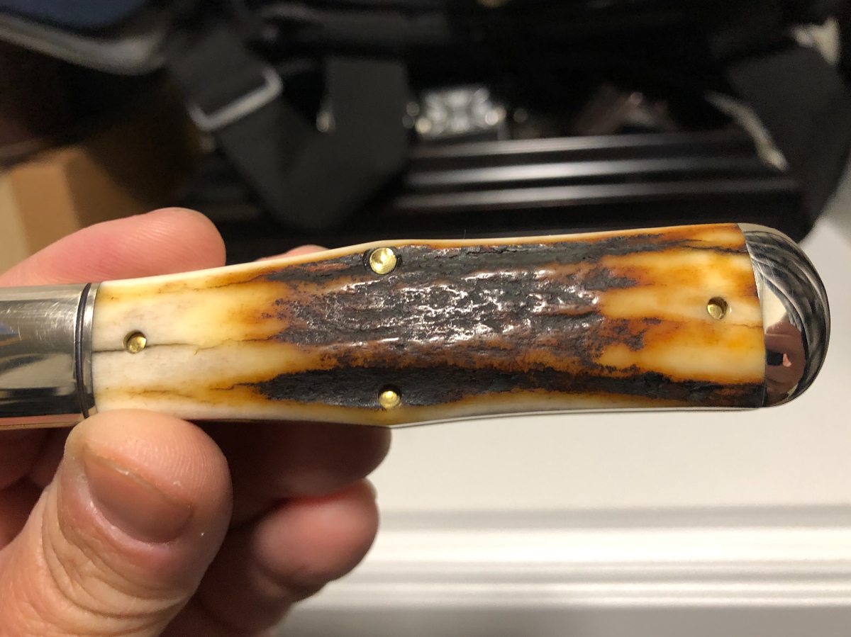

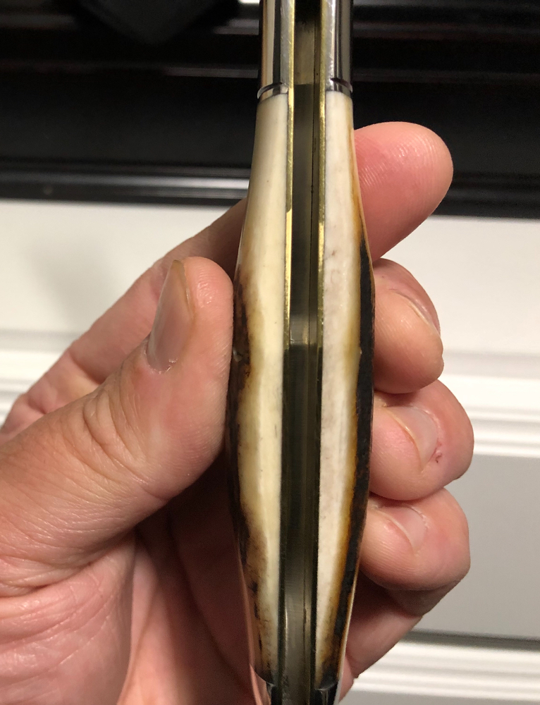

Thanks for all the feedback. I would return/exchange it, but as you all know, they are all sold out...and there’s no way I can justify spending $200+ on eBay for another!
No more stag for this guy!

Bax, i would still like to see a picture of whole knife.
kj

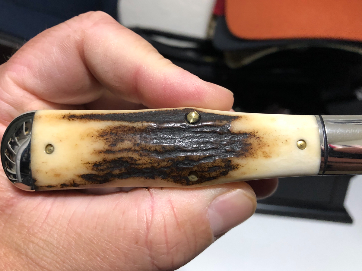

Well, it's certainly a beautiful knife. Like KJ said...I don't think it will ever affect function. In the context of the other craze lines, in your stag...I think it fits in pretty well. I don't think you would have trouble selling it, if you fell out of love
I certainly wouldn't give up on stag...because of that

I never thought you sounded petty. GECs are expensive knives and most of us expect quality and workmanship commensurate with the price. What is the point of using extra fine material like Sambar if the end product is flawed in suck a way as to impugn the maker's reputation?BAX229 wrote:kootenay joe wrote: I now realize how common this is and decided to keep and use it, like all my knives. Sorry for sounding petty.
That is some beautiful stag on your knife. If GEC glued the crack to keep it from spreading as you noted in your first post, then it probably will not affect use. Or even display if you put the crack on the back side.

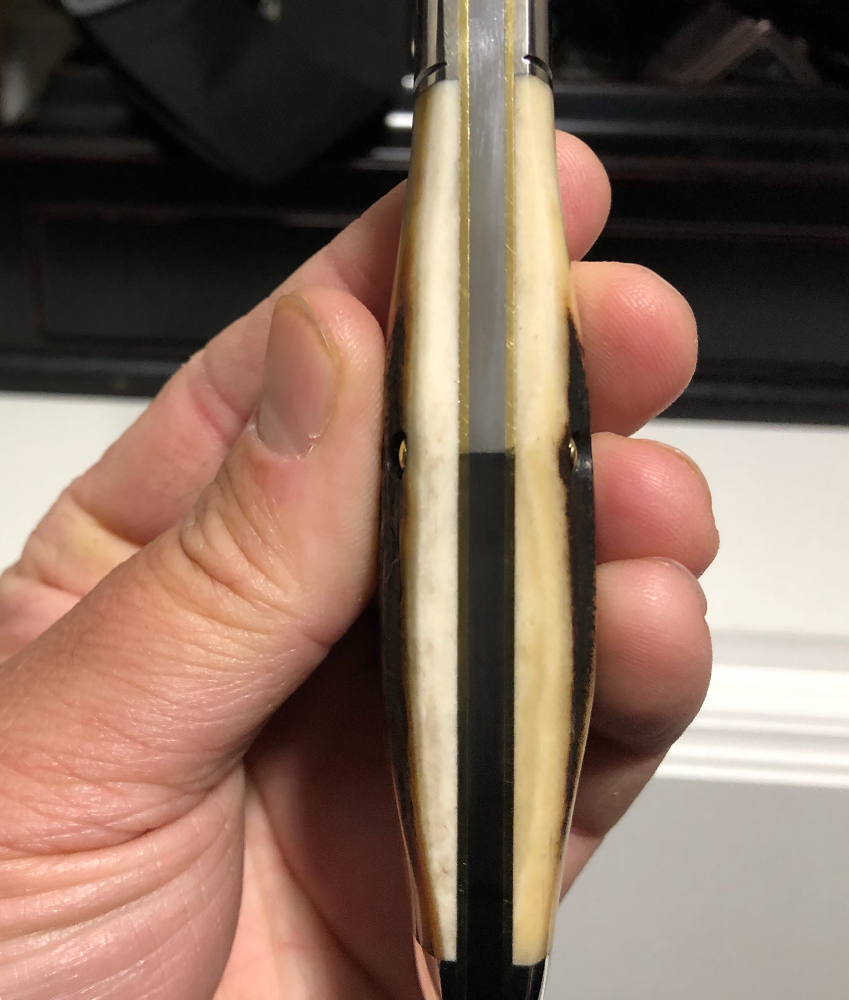

Thanks Doc B and Dinadan...I do love this knife, it's definitely staying in my rotation. I highly doubt this will be my last stag!Dinadan wrote: I never thought you sounded petty. GECs are expensive knives and most of us expect quality and workmanship commensurate with the price. What is the point of using extra fine material like Sambar if the end product is flawed in suck a way as to impugn the maker's reputation?

Thanks for the pictures. They tell us so much more than just seeing the crack. You have a good looking knife.
The real issue with the 97's is not cracks in stag. It is spring tension, or lack of it. I bought 4 97's: Micarta, Ebony, Stag, Yellow Rose. On 3 of them the spring is on the soft side but acceptable because function is not impaired. The Yellow Rose is snapless, even after flushing & lube. I am returning it for refund. Quite a few others here also received 97's with inadequate spring tension. If you are going to buy a 97, the question you should ask is "how is spring tension ?"
So, if O.P. knife with crack in stag, has good spring tension, then you really do have a good knife !
kj

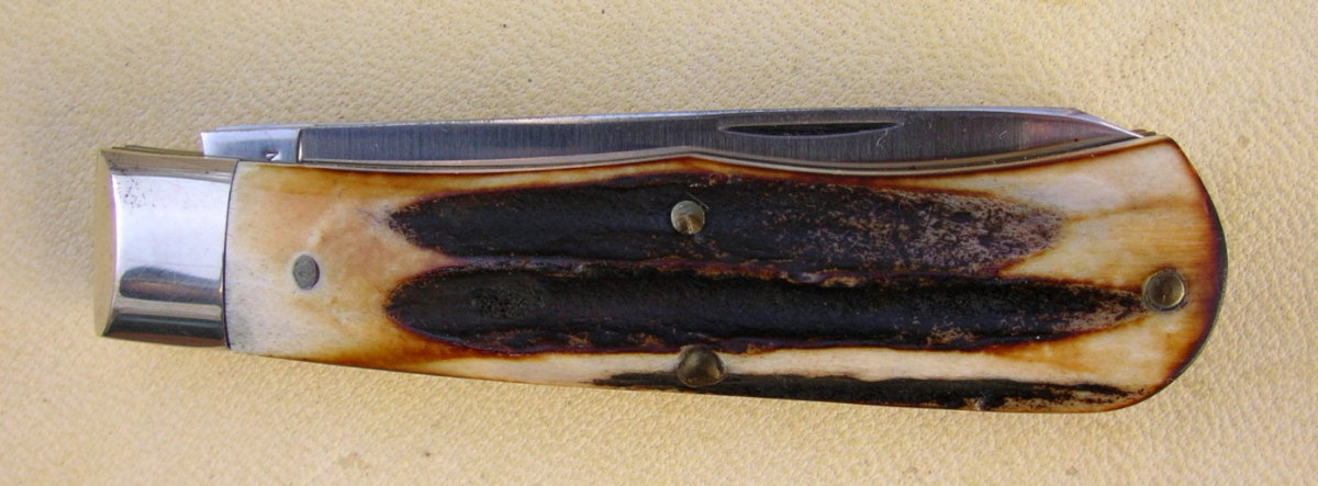

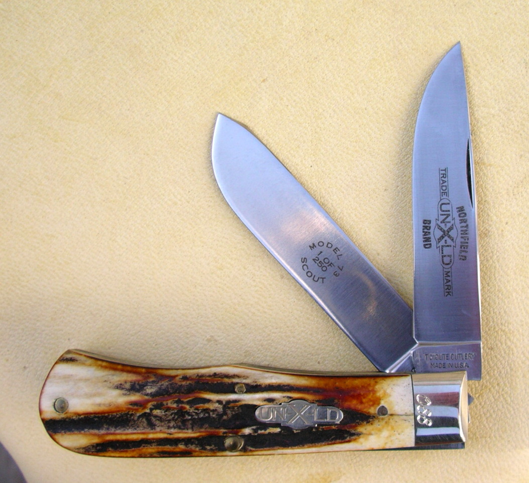

Here is my Stag #73 with similar crack to O.P. knife.
It was very early in 2007 when the first runs of #23 & #73 got to the dealers. I was on BF and waiting for my Stag 73 to arrive. Posts began to occur with complaints from those who had already received their first GEC knife. There had been some hype but no one knew how they would turn out because these were the very first GEC knives to get sold. The biggest complaint was 'nail breaker' springs, and they were 9-10 pull strength.
When mine arrived and i saw the pin crack, i thought: "should i return this ?" The answer was instant: "No Way. It's a beautiful knife". And spring tension is about a 6.5 on my scale, or, just right for this knife.
The flush & square joints are magnificent.
kj

These pin cracks occur during hafting. It could be that the stag available now is not as dense as older stag and thus cracks more easily ?
If a knife arrives with intact stag it is very unlikely to develop a crack.

Pin cracks occur when the pin is swelled,by spinning or hammering.They may not show much until hafted.kootenay joe wrote:These pin cracks occur during hafting. It could be that the stag available now is not as dense as older stag and thus cracks more easily ?

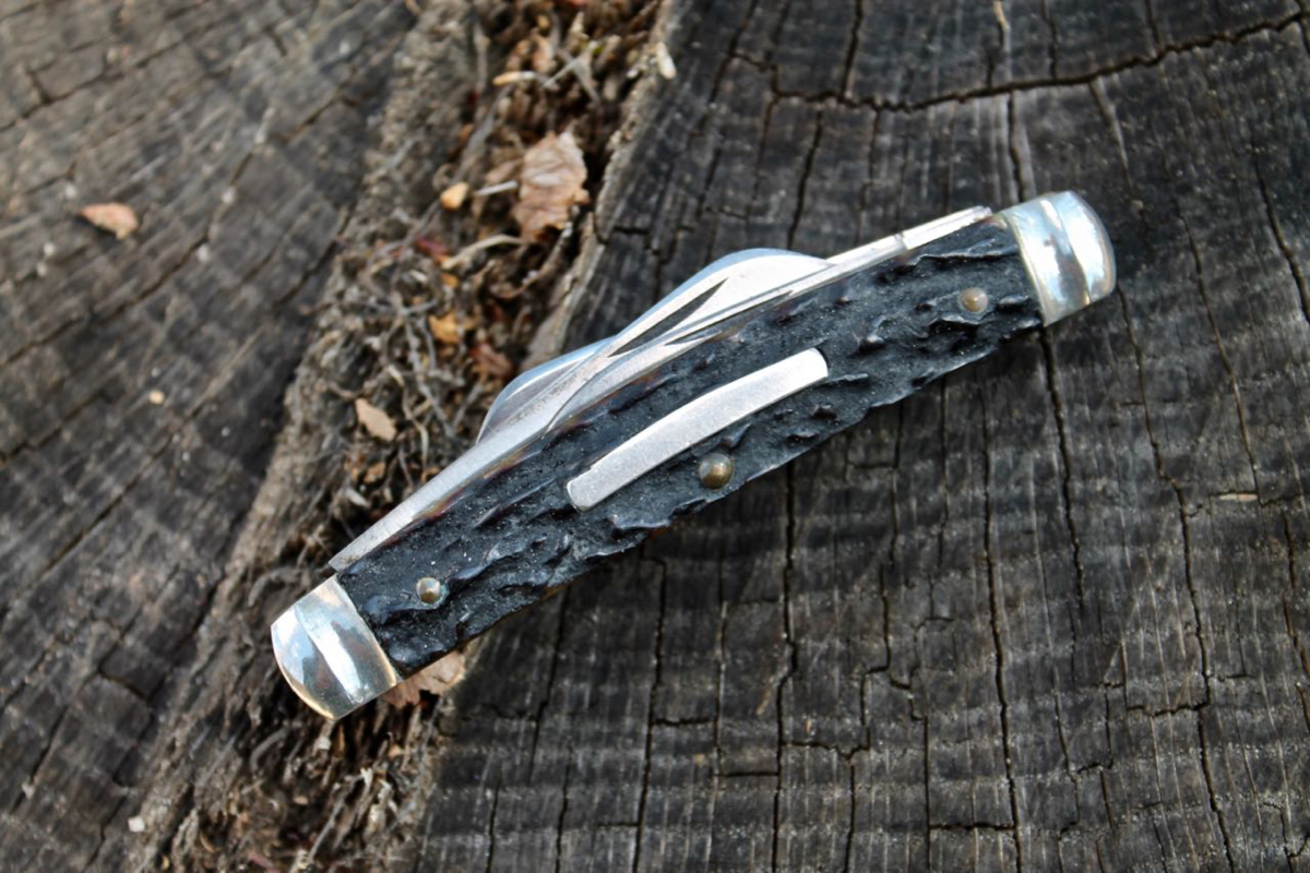

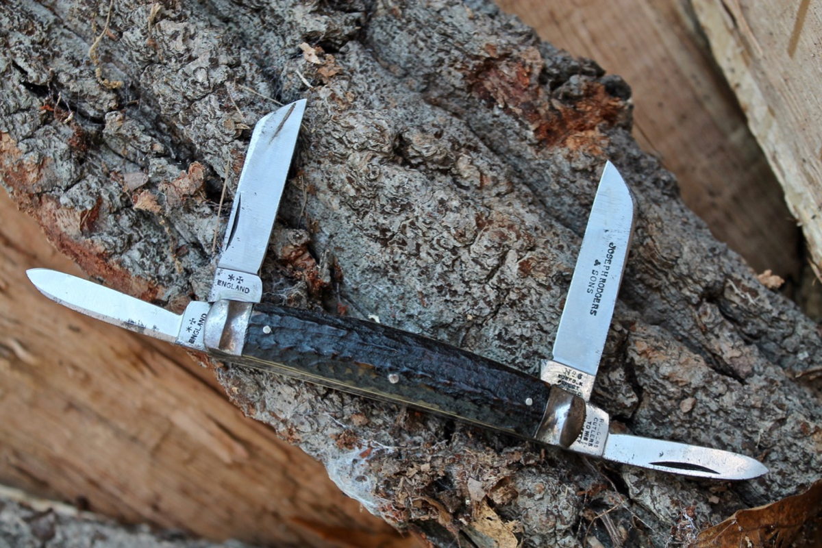

Yup, and that is why I much prefer how stag was hafted decades ago, bolster to bolster so if there is a crack you are less likely to see it. The way they do it nowadays exposes cracks when the stag is ground down to fit the bolsters. I still buy at least one of every stag knife GEC produces and am glad they are still using stag as I know it has been difficult for them to obtain quality stag.peanut740 wrote:Pin cracks occur when the pin is swelled,by spinning or hammering.They may not show much until hafted.kootenay joe wrote:These pin cracks occur during hafting. It could be that the stag available now is not as dense as older stag and thus cracks more easily ?
kj
Examples of how stag used to be hafted, probably too labor intensive to do it this way anymore on a production line. Custom makers still haft knives this way.
