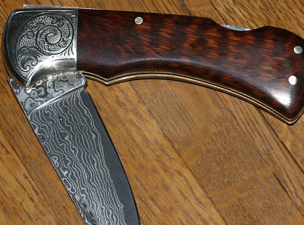

Any one have any experience/advise about working with these materials? I'm sure they would be more challenging than wood or ivory and would like to take my challenges up a step , or 3. I like to use wood and have several finished projects with it such as this damascus folder. I also MUST try to do some file work.

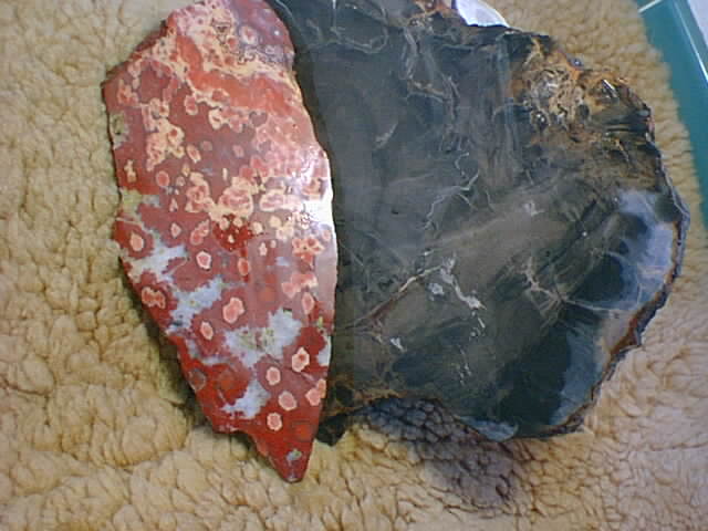

here is some petrified wood i cut a few years ago..in the garden now...keeps the flowers company..notice the cracks? i cut too fast...even with a wet saw...
