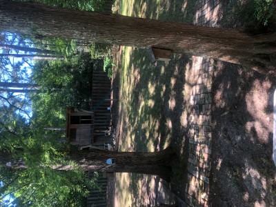

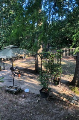

It is scoped and I zeroed it to the back fence, a distance I estimate to be about 25 yds. It is also the limit at which I would shoot a chipmunk in the back yard.
In about three weeks, I have shot 15 chipmunks and 15 squirrels, but the last few days, I have been missing.
I suspect I’m shooting high on the close ones and low on the far.
Have not dropped, bumped or done anything else to dislocate the scope.
Thinking about taking it off and using the iron sights.

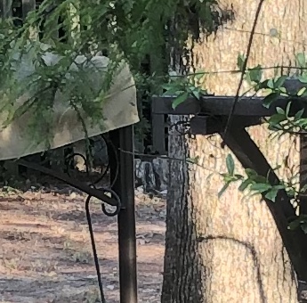

Bottom photo is my line of sight.

This is the view out the window of our master bathroom, my “Hidey-Hole” from which I generally shoot at the chipmunks.
On the zoomed photo, between the tree and the iron pole, there is a stump, back close to the end of the property.
This morning, I knocked a chipmunk off that stump.
My aim point was about four inches above the chipmunk and he went right over.
