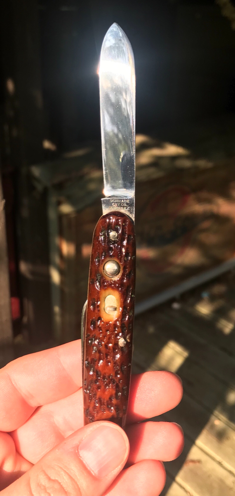

So, since I’ve been waiting for my bone to come in, I decided to fix something else. The original celluloid was torn buy the button, and I couldn’t leave it like that.
Before: After:
Before: After:

How did you make this repair?BFORSE wrote:So, since I’ve been waiting for my bone to come in, I decided to fix something else. The original celluloid was torn buy the button, and I couldn’t leave it like that.
After:
- Posts: 516
- Joined: Sun Jul 14, 2019 3:26 am
- Location: The Lone Star State
Re: Schrade switchblade celluloid - repair, remold, or replace with a different material
This is a “replace” fix. Searching online for celluloid with the proper thickness and pattern was a virtual bust.
Then there was the problem of forming that celluloid to the correct contour of the shell. It seemed like a hopeless case, especially the amount of effort for such an inexpensive knife; so finding a willing donor was the only option I had left. A perfect donor was found that had his tip snapped off, and fairly decent celluloid. Having some experience with shelled knife repair, I knew I had to be very careful when bending the tabs. The most nerve racking part was removing the celluloid. I started with the donor knife first just in case I tore the celluloid. I used a blow dryer on the lowest setting to help make it a little more flexible; take some of the brittleness out. Then I carefully, slowly, started to push the celluloid tabs on one side off the shell. Once that was accomplished, I removed all the celluloid from both knives so I wouldn’t have a mixed batch on my knife. Then I cut the tabs off of the original celluloid that had the tear, placed it on top of my donor piece, lined up the contours, taped them together and used the old celluloid holes as a template for cutting new holes in the donor piece. I used a Dremel with a very small engraver bit, and cut the holes out. Then I used a tapered sanding bit to fine tune my cuts. All cutting was done with the dremel on the lowest setting and without any force to minimize friction that could melt the celluloid.

Excellent job, and nice detailed tutorial! Very impressive!
If you have opportunity to pick up a Foredom, which is a rotary flex shaft tool, I'm certain you won't regret it if you do any amount of work with a Dremel at all. The Foredom can work at very low speeds and has lots of torque. Usually the Dremel needs extremely high speeds to be effective, the Foredom is the opposite; low speed, high torque.

Thanks orvet, I have never even heard of a tool like that. I’ll definitely have to look that up.

That's an interesting fix! You have more patience than I do.
