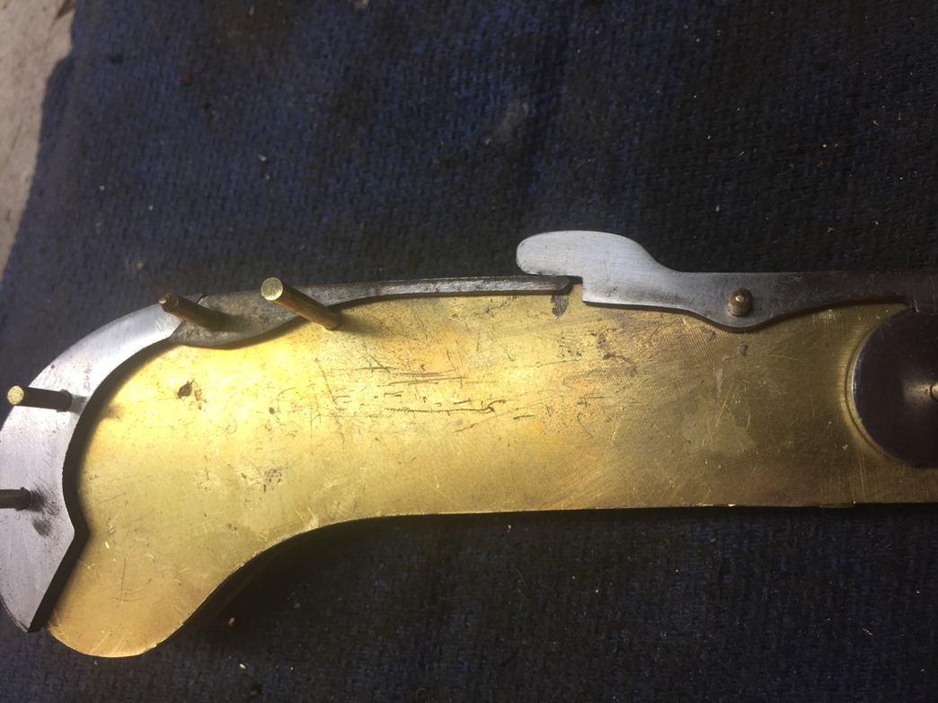

In between all the "hurry up and do's" last night, I got a chance to go back to my shop and take a picture of the WORKING (YAY!!!) Spring system. I had another thread where I was asking for help and (while looking back yesterday) Caleb was the one that had the idea that worked. SO.... without changing my pin locations I came up with this......
Because of the fact that pressing a lever in this position to release the blade didn't require much pressure, that meant the spring needed to be longer and thinner. So, now, onward toward the finishing of this knife.

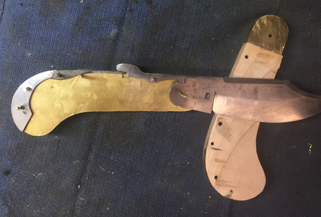

The whole system mocked up....
Onward!

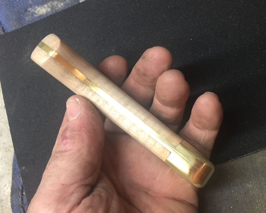

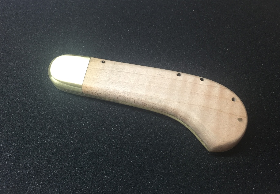

Well, as the curtain goes down on this build I have to say.... I learned a LOT and once the frustration with the spring situation was soothed, the build became fun again.
The more I worked out the final shape for the handle, the less I liked it. It just looked.... to phallic to me. SO.... I made a slight adjustment to the handle at the butt area.
This was after I did a lot of filing and sanding.
The basic final shape...
I pinned the 2 halves together temporarily and worked out the shape from there.
And so.... here she is...
(Please pardon my poor photographic skills...)
This joker is heavy in your pocket... SO, I will build a sheath for it at a later date.
Thanks for watching this build everyone!

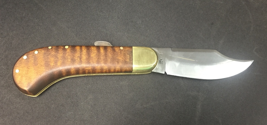

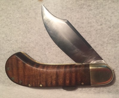

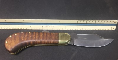

I forgot to show the real size of this knife.... It is just about 9" long when its open.
One more pic for the road......
Yes, it's big and it's heavy.... Just way I like it!
