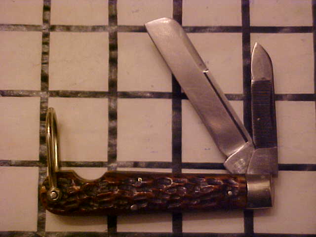

Hi and
to AAPK. First, I am not an expert or even slightly knowledgeable about anything to do with cutlery.

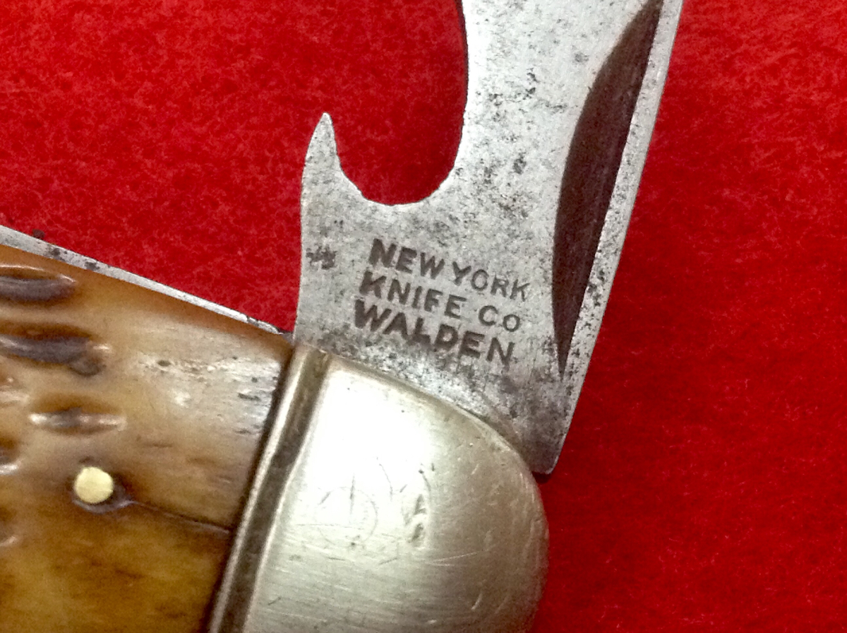

That being said, the knife below was my father's. He was a Technical Sergeant in the U.S. Army Air Corp from 1942 to 1945.
He was stationed in Iceland 1944-1945. When he received this knife, I have no idea. I'm sure someone will be along at some point and help you out much better than I can. If you find out what years are involved with the tang stamps that are shown, you might be able to narrow it down. Good luck, Skip.

- New_Windsor_NY
- Posts: 14056
Re: US Army Pocket Knives of WWII
Thank you Quick Steel. The handle on the other side is completely missing.Quick Steel wrote:Welcome aboard.Hope you will spend time here and share photos etc. I think it is likely that someone with the specialized info you need will eventually be along.
Skip, that is a very fine looking knife.
I'd like to eventually get it repaired.

Skip, your knife made by New York Knife Co could have been made no later than 1931 when the company went out of business. It is not an issued army knife, NYK just put that shield on there for marketing purposes. They are usually regarded as WW1 era knives but I have seen no info as to when they ceased making them. Your dad must have gotten it from somebody or somewhere before the war. I will have to dig around to find the earlier WW2 general purpose pocket knife, although I think others probably have photos of them already. There were no pocket knives issued to US troops before WW2 although the US Navy did issue folding knives since the mid-late 1800s.
- New_Windsor_NY
- Posts: 14056
Thank you for the information. I never asked my father about it. It was always in his workbench drawer. It could very well have belonged to my grandfather at some time also. I'll never know, but it's a nice knife anyway.Gunsil wrote:New Windsor, your knife made by New York Knife Co could have been made no later than 1931 when the company went out of business. It is not an issued army knife, NYK just put that shield on there for marketing purposes. Your dad must have gotten it from somebody or somewhere before the war. I will have to dig around to find the earlier WW2 general purpose pocket knife, although I think others probably have photos of them already. There were no pocket knives issued to US troops before WW2 although the US Navy did issue folding knives since the mid-late 1800s.
Oh, by the way, my name is Skip.

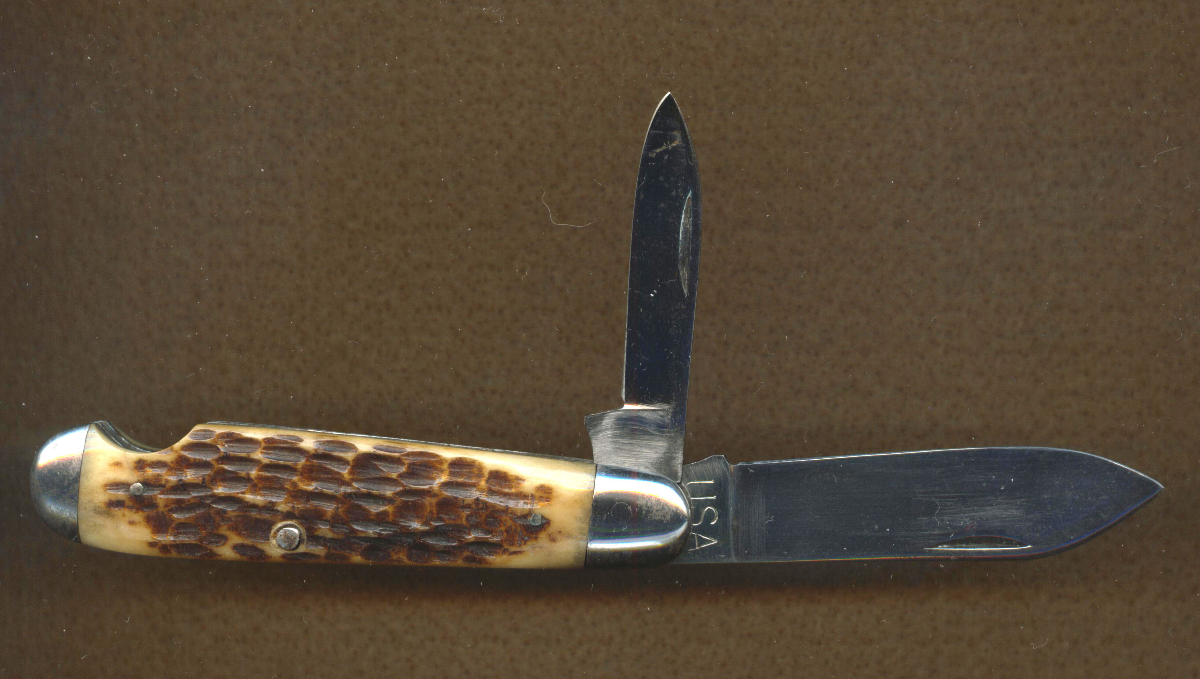

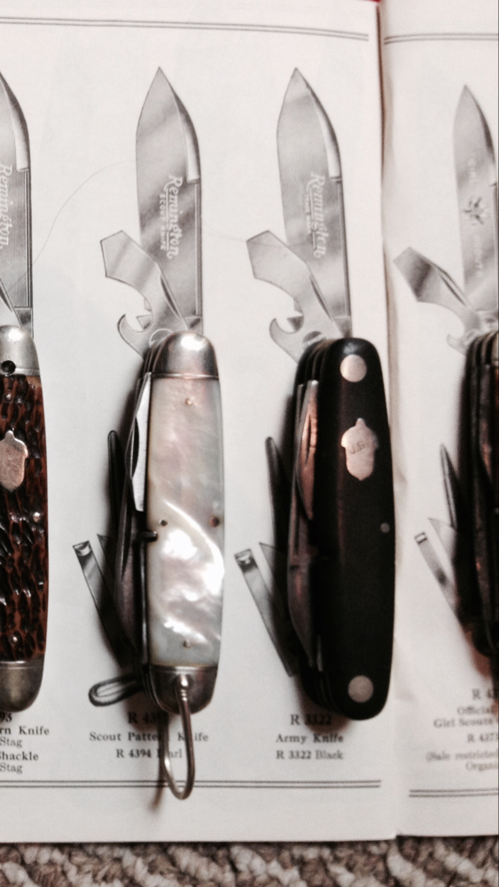

I have a very early Remington with acorn shield R3322 with USA on the shield . The C4 Remington catalog called it their Army knife .
I would date the knife in the late teens or early 20s .
Sorry for the bad picture, it’s all I have on file right now .

Scout, since Remington didn't start making knives until 1920 how could any have been from the teens?? Other than bayonets Remington never made any knives for the armed forces, and those bayonets were WW1 or earlier.

I believe the first year for Remington pocket knives was late 1919 but I could be wrong and I believe this knife to be very early . It also has the first generation tang stamp .
Either way it’s old and I’m only aware of a handful known to exist .

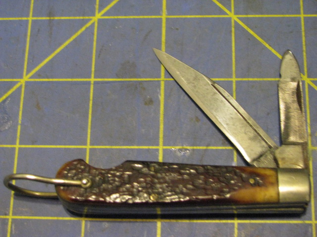

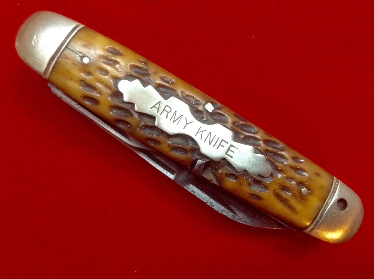

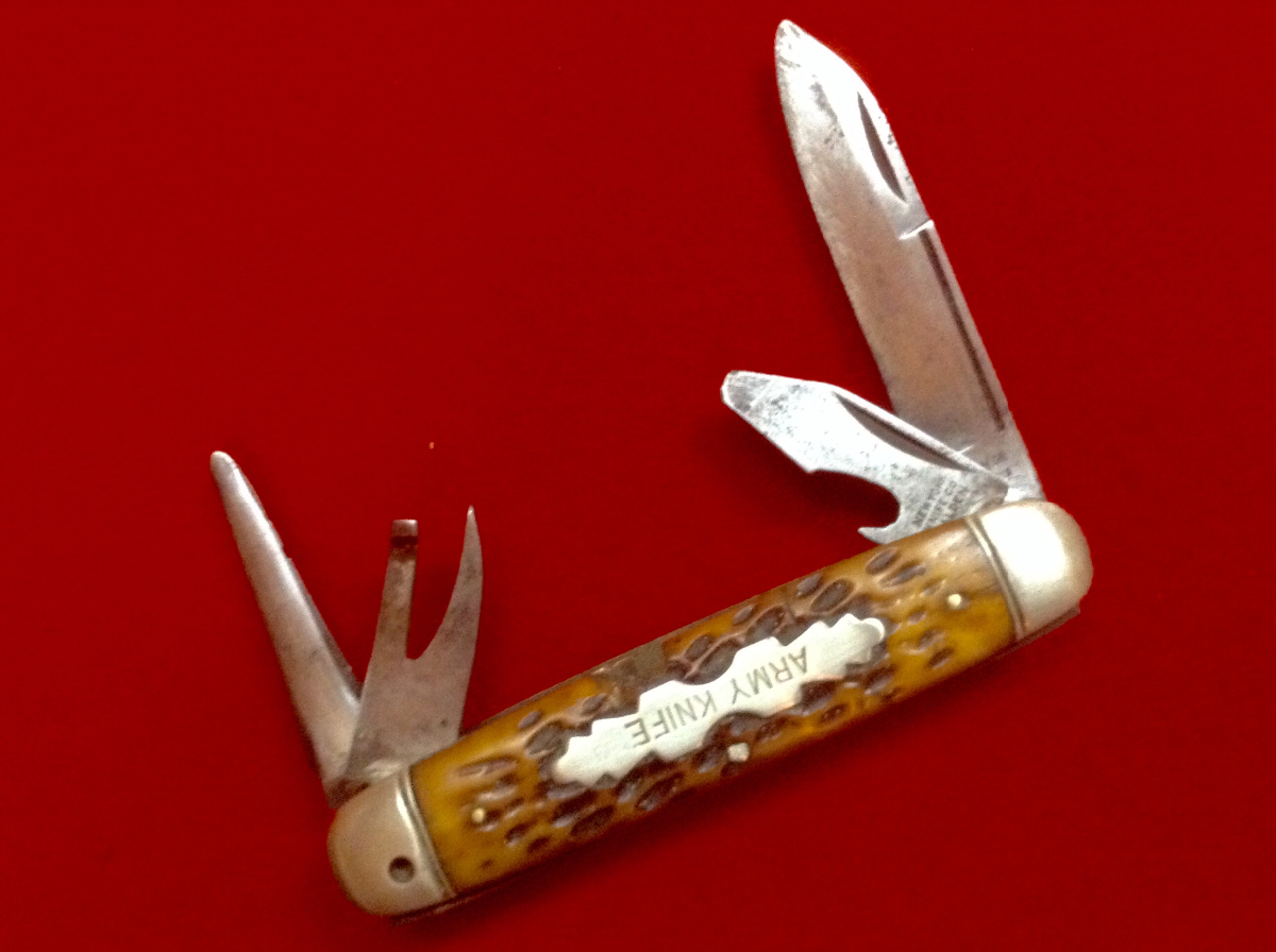

This Robeson two blade Easy Open Jack is stamped only "U.S.A."on the master blade. In this case, that stands for United States Army.
This Robeson three blade Scout/Utility is marked "U.S.A." on the shield. Three blade army issue knives are not common.
This four blade Scout/Utility is seriously considered to be an issue item.
Robeson also made the STEVENSON marked all metal four blade Scout/Utility knives. They were marked only on the bail. As you can see, the Stevenson retains the proprietary Robeson cap-lifter/can-opener and short screw-driver blades, so this knife predates the MIL-K requirements for the later knives. They did, however, utilize the required blades in their later Stevenson knives.

Charlie, does that all metal knife have brass liners? I had thought that all the military issue Stevensons had US MARINE CORPS on the scale just like the Kingstons.

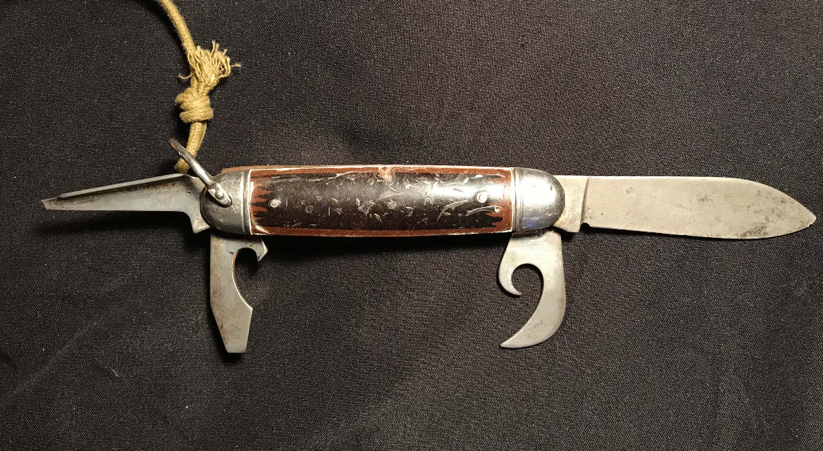

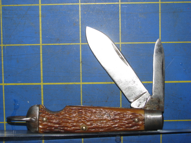

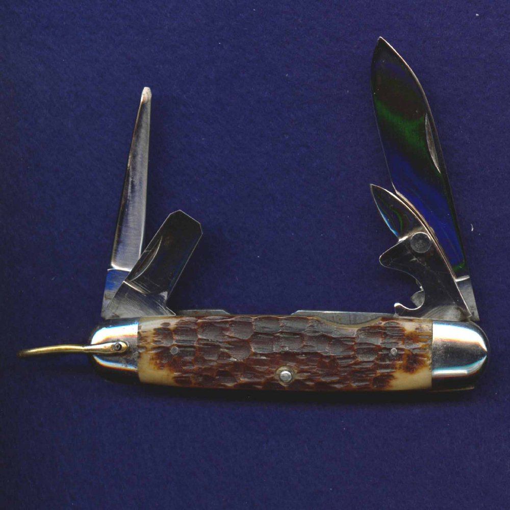

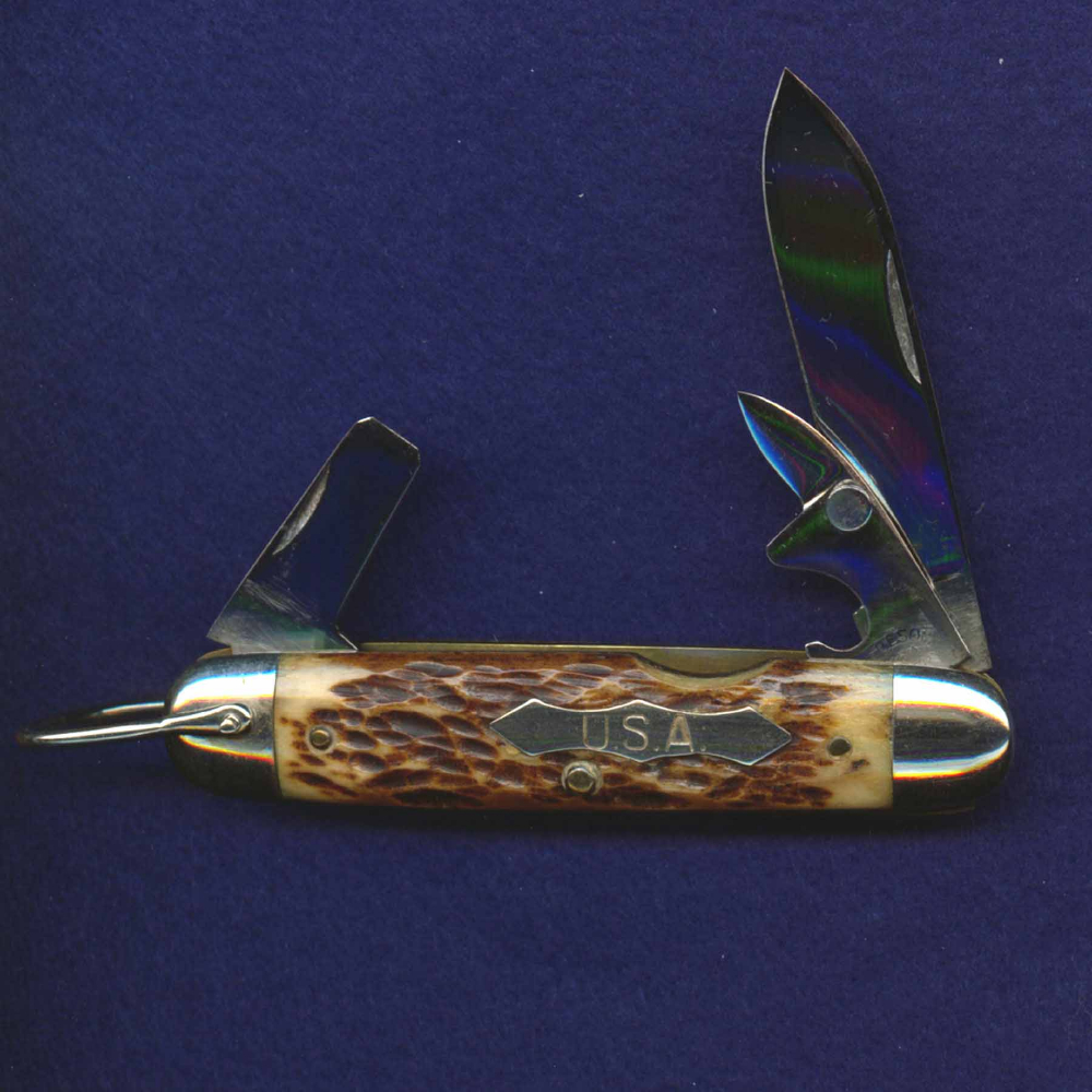

PvtRossi, here is a WW2 era Camillus utility knife made for the army. The USA on the shield is for US Army. These and ones by other companies were what preceded the all metal MIL-K knives. These would have been general issue knives, that is not made for specific units like the Ulster mountain troop knives. On the Robesons Charlie shows the USA on the tang is for US Army.

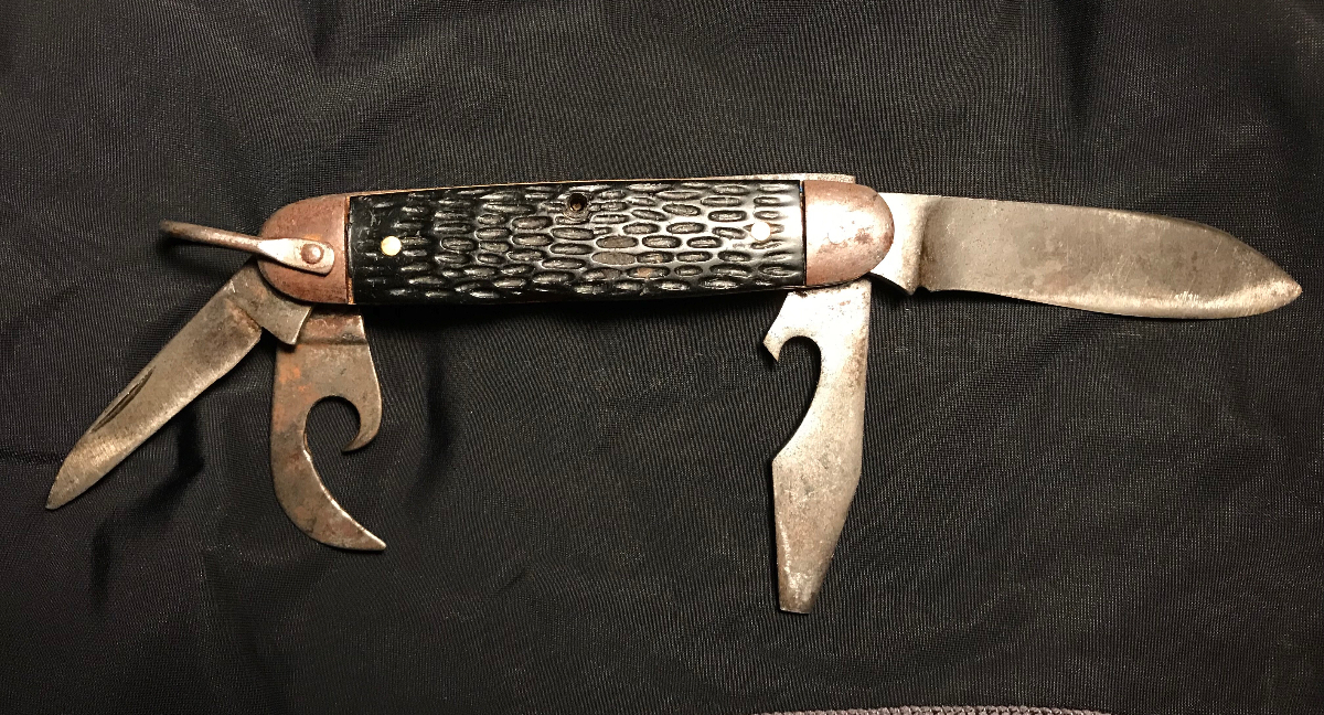

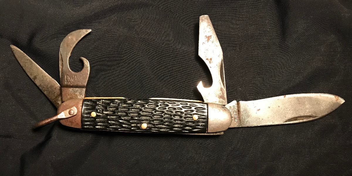

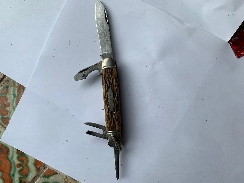

Meanwhile, I will submit to your judgment a couple of pocket knives that I have meanwhile used. I have not been able to identify with certainty the models and the manufacture years. Maybe you will help me to shed some light and help me out.
The first one I BELIEVE might be a Camco 450, which I think might be a model produced during the war years. Unfortunately one of the safeties is lacking (and I take the occasion to ask for help as to where to find a replacement or how to make one, please).
The blade is marked Imperial Knife - Providence, R.I. and the can opener is marked Can Open - PAT (and then I can't discern anymore). The second is a Barlow "Diamond Edge" possibly manufactured between the '30s and the early '50s. This is all I could find out. Blade is marked Imperial Knife - Providence, R.I.

Both knives you show would be classified as FARB, they were both made after WW2. No, the government did not just go out and buy a lot of pocket knives from all over and distribute them to troops. The government contracted with most but not all major American cutlery companies for specific knives. NONE of the issue utility knives had synthetic scales, you need a bone handled one with USA marks to be considered properly suited for re-enactment. If you can't afford books there are libraries, perhaps you should try going to your closest one. Libraries can get any book you wish for study. I should think other re-enactors in your group would also know which knives were actually available to troops in WW2.
