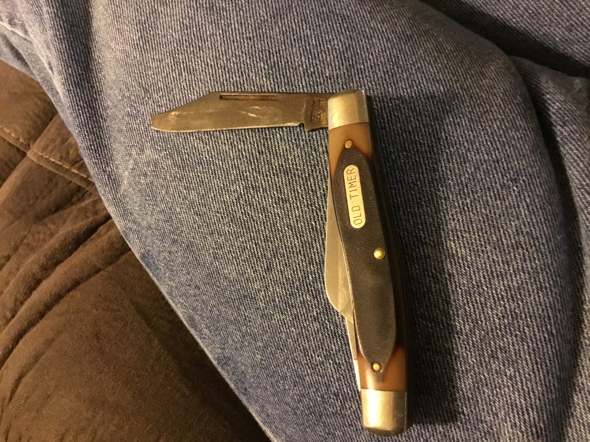

Schrade Old Timer Repair

Hoop19,
to AAPK.
If the blades still have snap or “walk and talk”, you could reshape the clip blade, clean it up and carry it.
On the other hand a replacement blade could be installed, if done by a knife mechanic you could probably buy another knife for what that might cost.
If it has sentimental value then it’s a keeper with a new blade or a modified blade.
Treefarmer

I think all knives are worth repairing but when the main blade is snapped off like that there’s not a lot of options available for repair.
If you can find a cheap donor knife for a replacement blade then you should attempt to repair it. Schrade knives are readily available so see if you can find a replacement blade and get it fixed!

Well said TF!treefarmer wrote: ↑Mon Oct 14, 2019 2:50 am Hoop19,to AAPK.
If it has sentimental value then it’s a keeper with a new blade or a modified blade.![]()

I picked it up for a dollar. It’s not sentimental or anything.

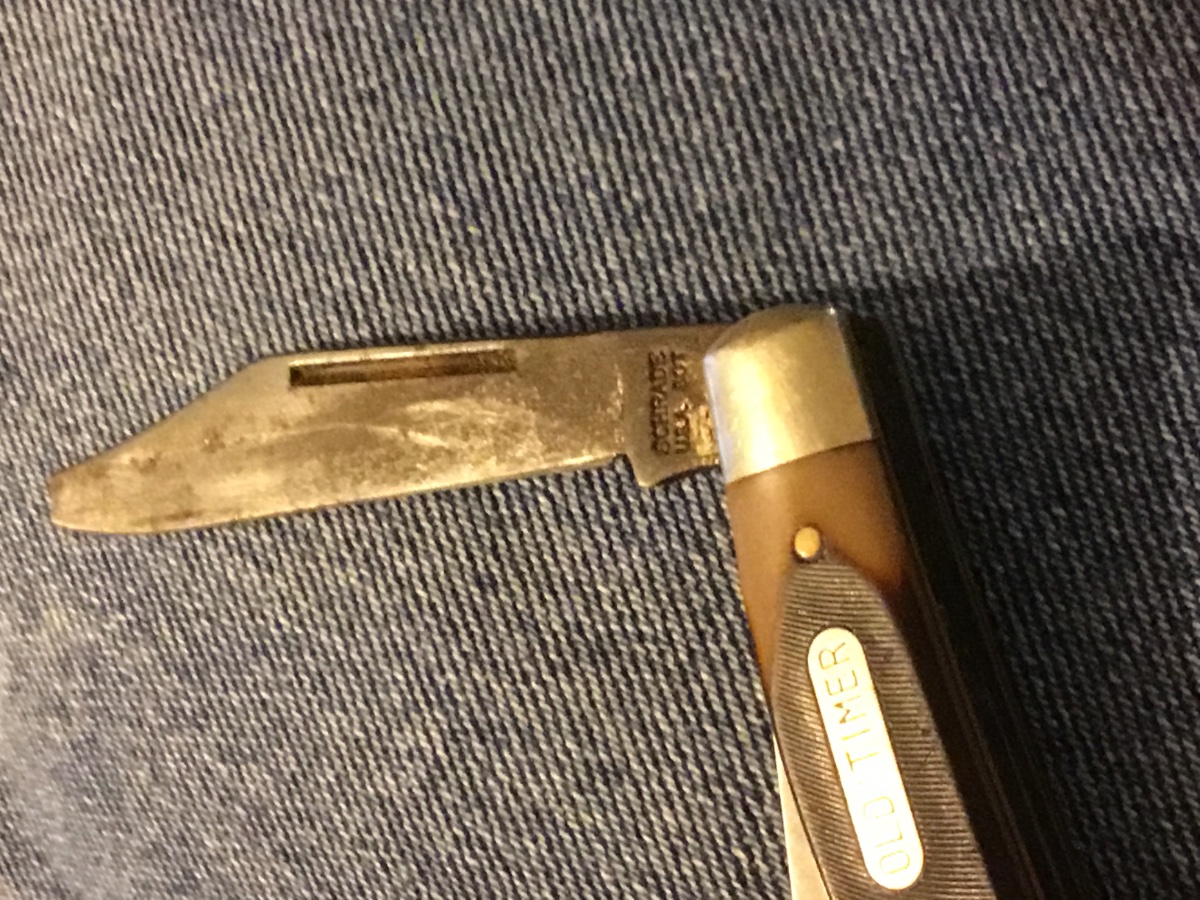

It's not really worth getting a blade replacement due to the difficulty of finding a new blade and the cost of having someone do it. You could easily reshape the tip back into a point and make use of it that way. USA 8ot's can often be found in much better condition for very little money. I have paid as little as $10 for them in like new condition.

I, too, vote for re-profiling the blade a bit...removing metal from the top only (not the cutting edge)...sharpening it up...and putting it to work!

It should also be noted that replacing a blade on this and other Old Timers is not as easy as just swapping out a blade. The blades/middle liner/springs are together as one assembly, using something called the Swinden rivet system. These knives do not use a typical pin-through-the-bolster construction. You can turn these into a through-bolster construction, but it would require taking the knife apart to do so.
As others have said, re-profiling the blade is probably the best choice.

I'm in total agreement with and talk Glenn and Doc!

Yep, I would re-profile the blade..... then clean it up good and tote it.
When I re-profile a blade, I try to make the tip be about where it was originally. IOW, the tip was MAYBE about half way between the top and bottom of the break. Take a marker and make a line about where you think the tip should be. Then close the blade. If the mark is below the top edge of the liner... then you are good to go. File (or grind if you are in a hurry....LOL) the new profile on the blade at the spot you marked.
Good luck!
