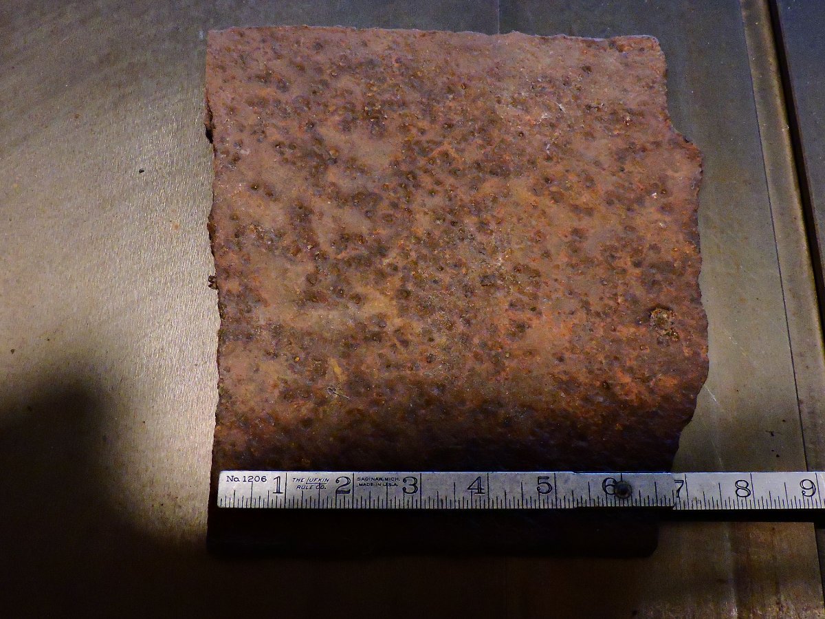

I got this plate steel from the old Northfield Cutlery site a few years ago.
I filed and stoned that one corner of it and it shined like a pewter dollar in a mud hole.
I thought it might be worth making fixed blades out of it but I don't know anything about that.
