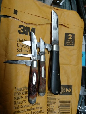

Just keep sharpening it. Don’t grind it. I use a coarse diamond bench stone. The two high spots will get longer and longer until they meet in the middle. I cannot stand recurve blades and I find it satisfying (almost therapeutic) to straighten the edge on an old worn knife. These three knives were all like yours when I got them.

Here is a good picture of a bellied out blade I sharpened out. You can see the two straight sections and the belly in the middle. As you sharpen the bellied out section gets smaller and smaller until it’s gone.
I get a great deal of satisfaction from this process I don’t always do it in one sitting.
