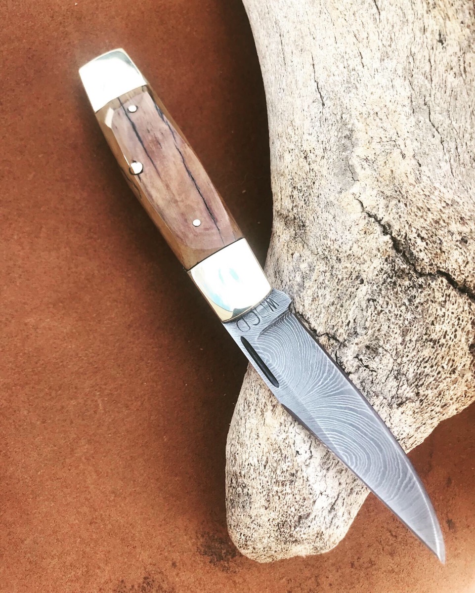

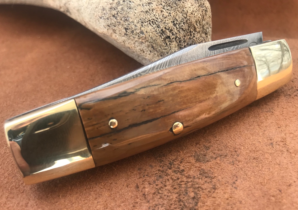

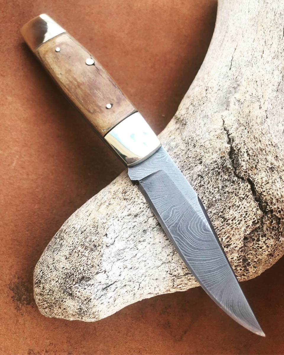

Climbing the Ladder
Ladder Damascus, that is. Not my billet, but a USA billet I was able to acquire.
Stainless liners, brass bolster, 1095/15n20 Damascus, and mammoth ivory.

Love the blade profile, love the scales...
Beautiful knife!

SWEET... that is a real killer Tony!
The blade material is very nice! It screams QUALITY DAMASCUS.... I think that pattern is the type I like the most.
The mammoth ivory is some really beautiful stuff. I keep thinking I want to give it a try but then..... I start thinking that it would be something like rock or petrified wood....LOL.
How does the mammoth ivory work?
Is it easy to cut, sand and drill?

Mammoth ivory is easy to drill, sand and work. It is prone to chipping and cracking. I use lots of super glue on the natural cracks and lines. The dark lines make it attractive to my eye, but are opportunities for failure. IMO it is easier to work than bone, but more fragile.

Very nice, Tony. I really like that blade shape!!!

Absolutely awesome beauty Tony! I love the pattern in that damascus and the mammoth ivory is gorgeous!

I don't know the measurements but it looks like you were able to get maximum blade length into the handle which i believe is more difficult than having the blade a bit shorter.

Thank you, Doc. So do I.
I milked the nail nick a bit too close to the pivot, but I will fix that in the next one.
Thank you Herb. I want to see your mammoth offerings as well. Post them up when you source and use some.
Yes sir, it is Joe. I have been leaving the blade a bit long in the initial grinding, and shortening it to fit the frame on the first temporary pinning.kootenay joe wrote: ↑Wed Mar 25, 2020 4:14 pm I don't know the measurements but it looks like you were able to get maximum blade length into the handle which i believe is more difficult than having the blade a bit shorter.

Still learning, some from error and some from trial.

Wow, that really does look great.
