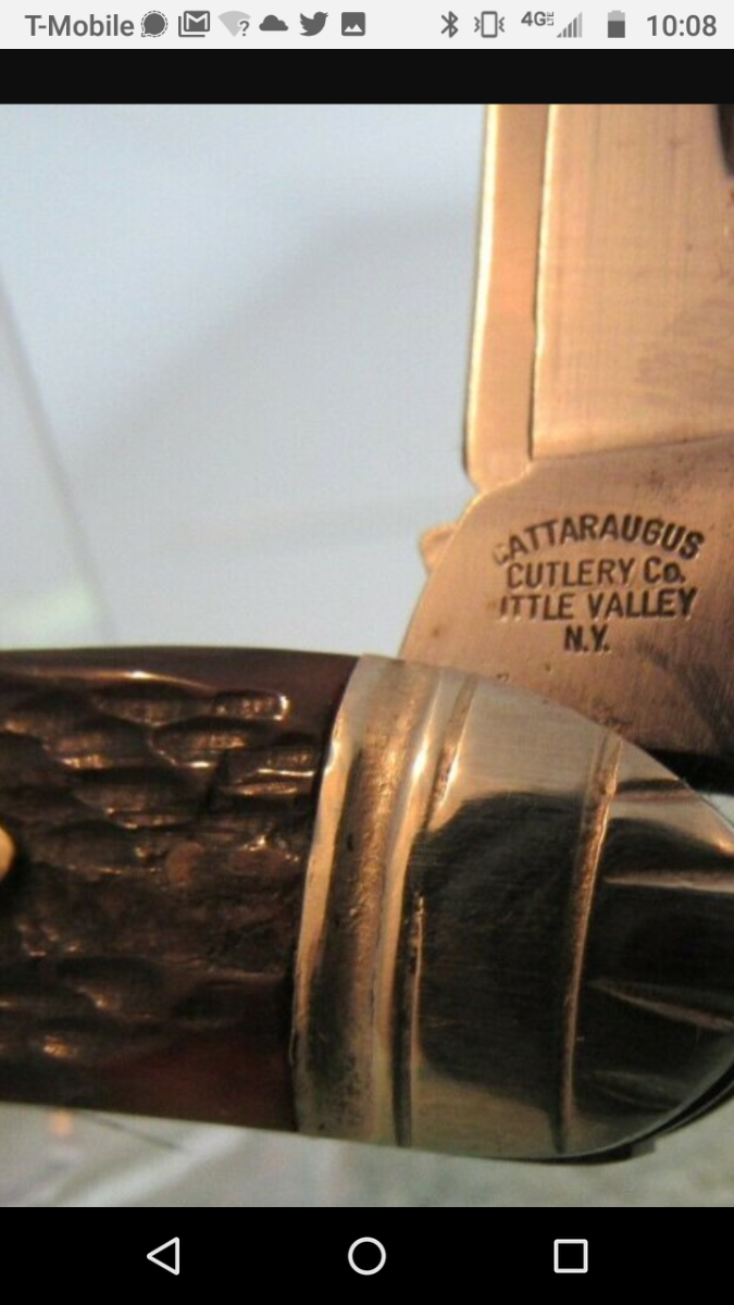

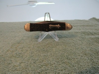

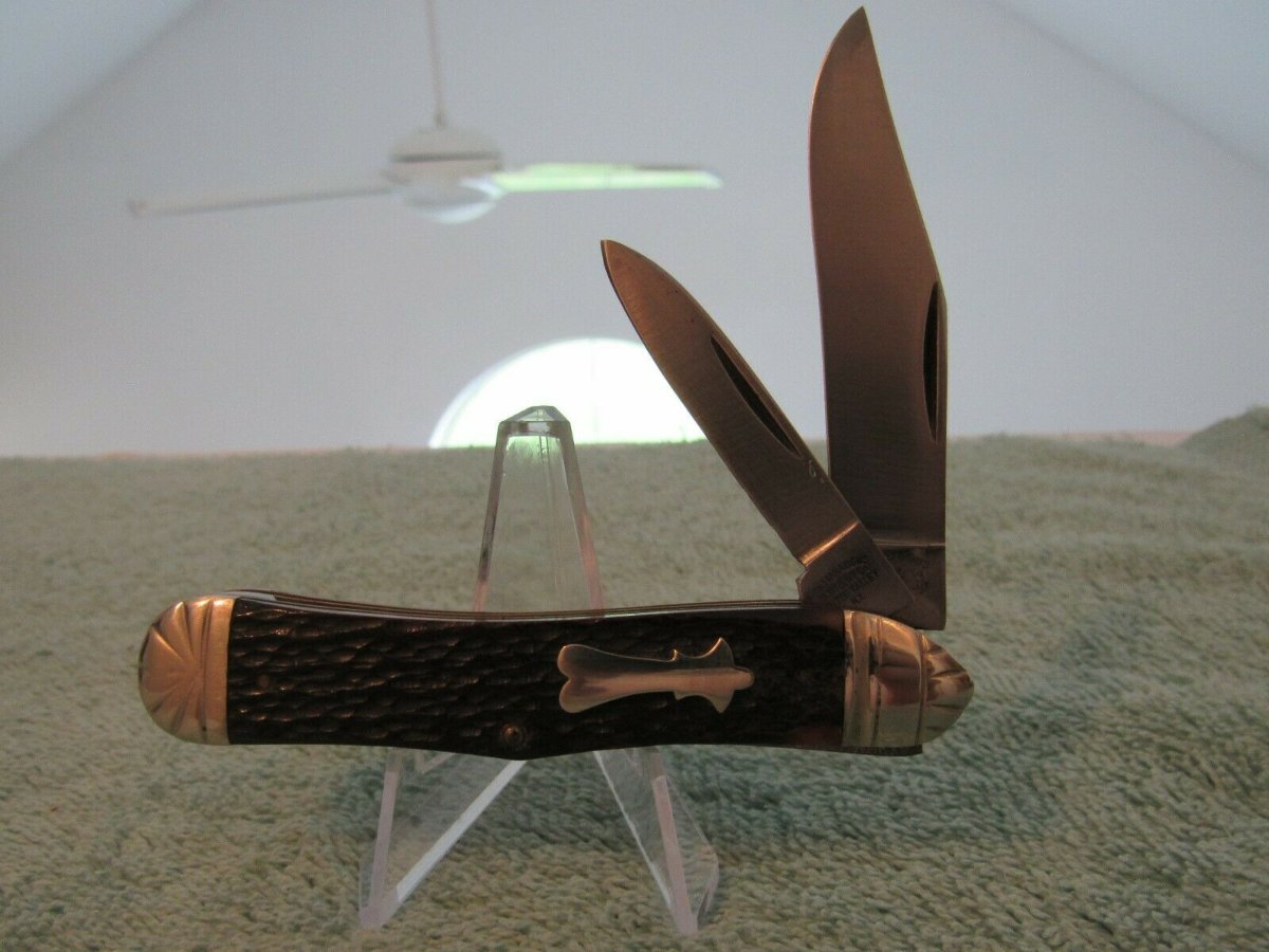

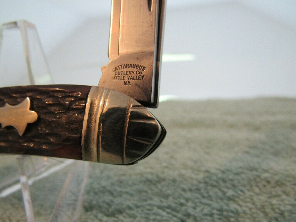

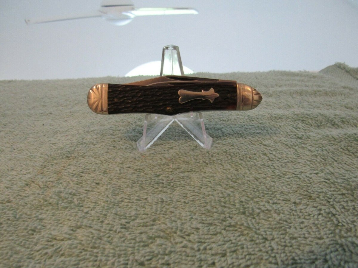

I just got this in the mail (ebay purchase) and have some suspicion about it being a fake. Can someone please take a look and let me know what you think? Any insight is much appreciated.
The listing can still be viewed via the link below:
https://www.ebay.com/itm/Vintage-Cattar ... true&rt=nc
Thanks!

Looks like a fake to me.

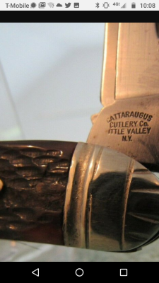

Modern stamp,nothing old about that knife,a pattern that is commonly faked.Actually I would call it a fantasy knife.
Likely make out of old Utica parts.

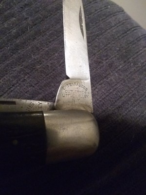

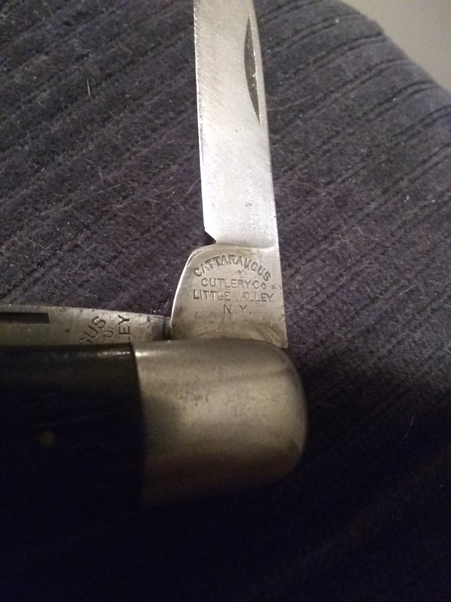

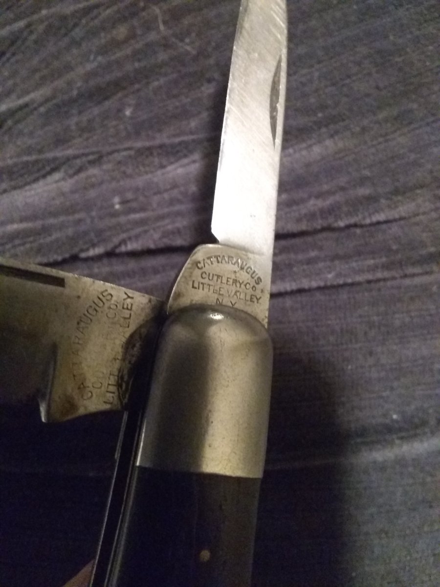

Check out the tang stamp and what's going on with that scale pin close to the bolster? Attaching a couple tang stamp pictures for comparison.

A quick check is to see if the shield is resting in top of the handles instead of inlaid into the bone. If the shield isn't sunk into the bone it's gonna be a stinker.
Many years a ago (25? 30?) I bought one of these at a show thinking it might be fun just to carry a dressy knife I could still beat around. The guy said he put them together from parts along with some other more honest knives that he had rehandled. He did nice work. Kinda pretty, but I never carried it and I still have it. I also have a worm grove rehandled Hibbard Spenser and Bartlett trapper I got from him.

The shield was one of the first things I noticed when I got it. It does sit on top of the bone, not inlaid. Despite some fit issues, it does have nice walk and talk and is fairly well built. Just doesn't feel like an old knife (since it's not). Funny because I had a similar thought to just keep it and make it a fancy user that I could beat up but for $300 that's a no go lol.Froe wrote: ↑Fri Apr 17, 2020 10:13 pm A quick check is to see if the shield is resting in top of the handles instead of inlaid into the bone. If the shield isn't sunk into the bone it's gonna be a stinker.

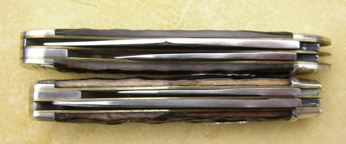

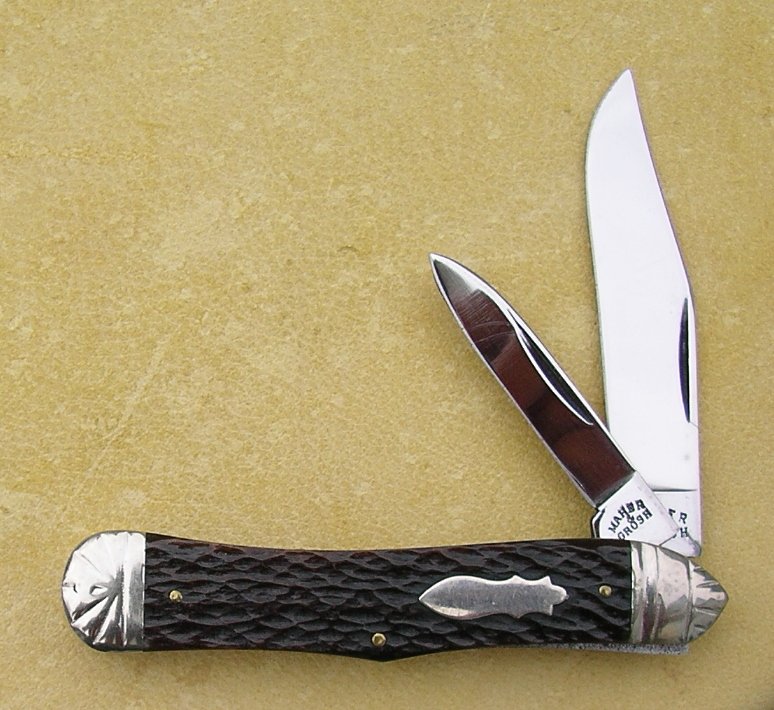

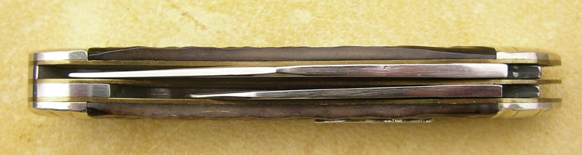

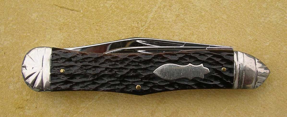

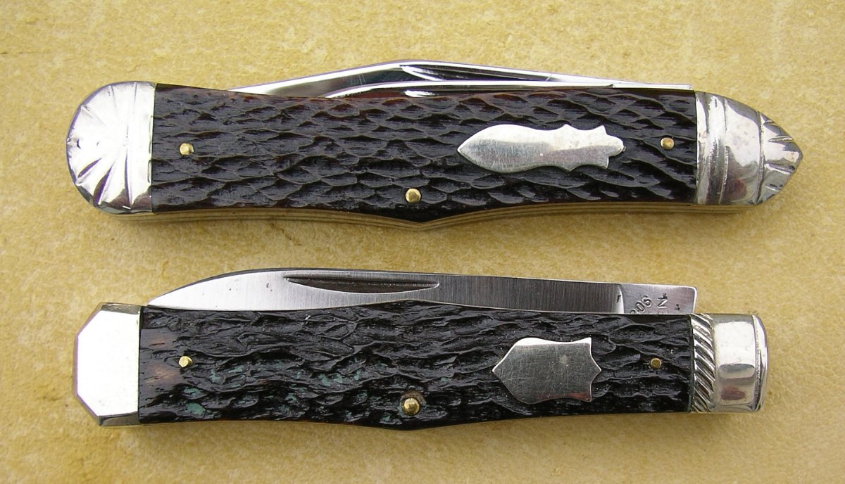

Here is my lovely Maher & Grosh Eureka Jack.
Note the wrap around spring and in same view, the proud shield.
This fake reminds me of the Queen Black Box Winchesters which also lack spine swages on the blades.
kj
kj

Thanks Joe for the extra pics,that has got to help identify this type of fake! Bill

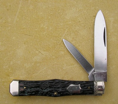

Thanks Bill.
Here is a "Miller Bros." Swell Center Jack. Note wrap around spring here as well.
kj

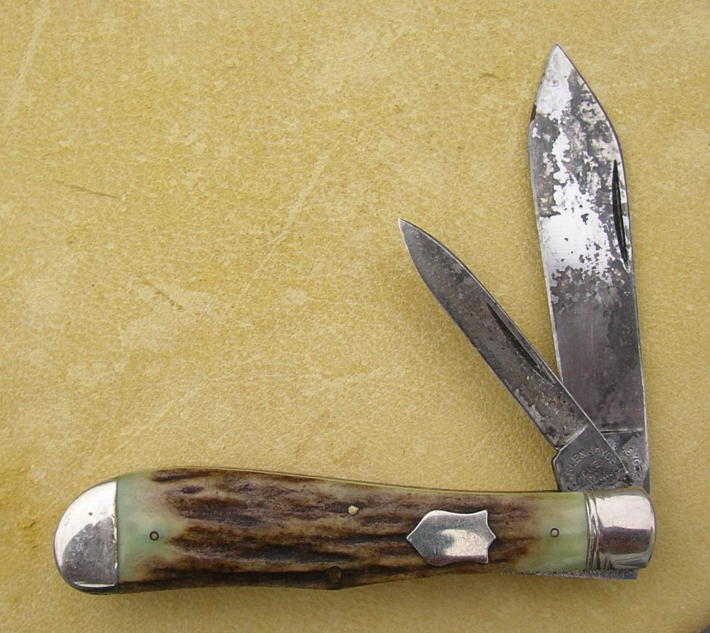

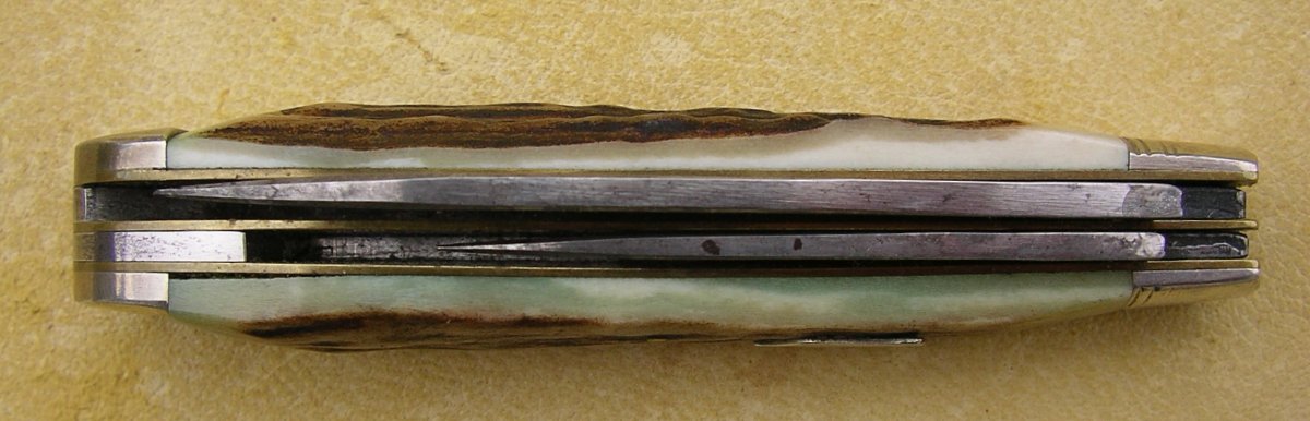

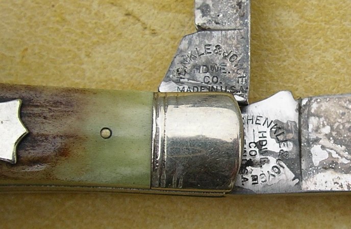

And one more, this one with stag handles, a Serpentine Jack marked "Henkle & Joyce", again with wrap around spring.
This one was 'minty' when i bought it but i have used it to peel & slice potatoes.
These are good very usable knives but no value otherwise. My 3 came from ebay for about $25-$35 each.
I think they may have been assembled using Queen parts and blades because of resemblance to the Queen Winchester knives.
kj

And all those examples have no swedges or top grinds. Don't even have to have in hand to inspect shield, it says modern knife from a mile away just by looking at the blades. KJ, I know a guy with the same as your bad Maher but marked New York Knife. These are the ones Parker had made in Germany, supposedly when they came through customs they had "Germany" inked on the back of a blade which Parker simply wiped off. They are actually pretty well made knives. Another "tell" from a mile away is that the detail on the fancy bolsters is blurry compared to the bolsters they imitate. Oh, they were available in some Parker catalogs back in the day.
