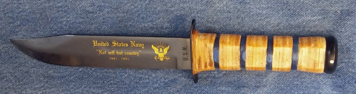

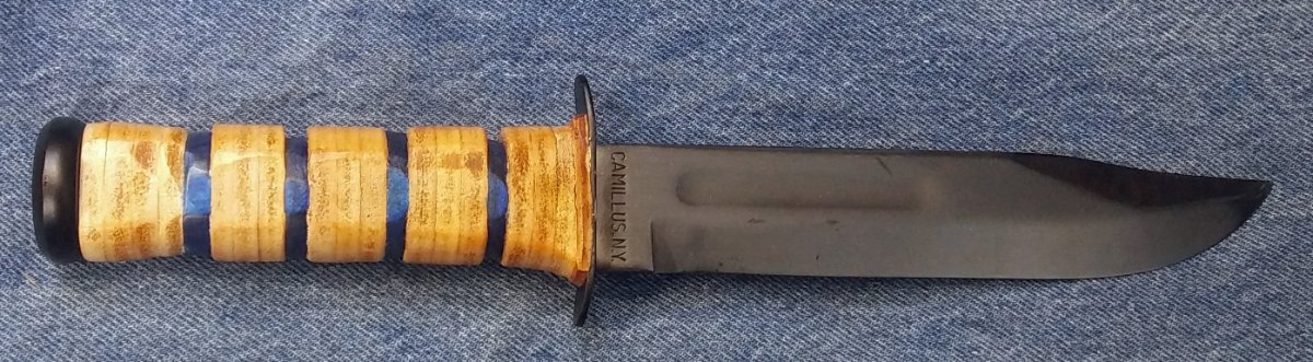

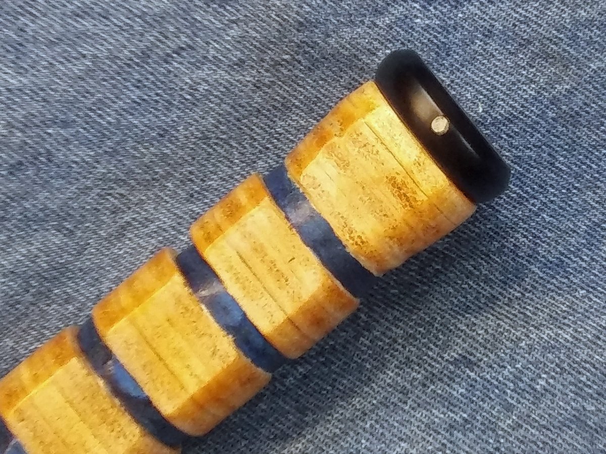

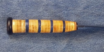

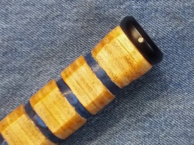

In the years following 9/11 there were some hard time for cutlery companies. United Cutlery went out of business circa 2002, Schrade closed in 2004 and Camillus in 2007. After each company closed there were lots of knives in various states of completion, tons of parts, blades, and unfinished fixed blade blanks.
I bought a lot of those, mostly Schrade and Camillus and still have a couple drawers full of blanks. One that I've wanted to complete for a long time is a Camillus Mark II U.S. Navy commemorative. I have not seen the original completed knife as it came from the factory and finding the exact pieces to complete it would probably be impossible at this date. Of all the many blades I purchased in that time frame, this one was one of the few blades that actually had some protection on it to keep it from getting scratched. That was good because the finish on the blade is in very good shape and the goldleaf lettering is still intact. However the combination of the shiny deep blue finish and the goldleaf exit very difficult to photograph them in make them look right.

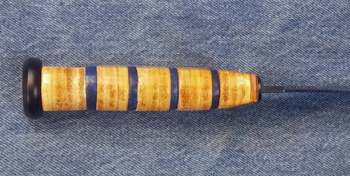

I used the leather rings for the handle and I used for smaller rings and dyed them blue and used to Kabar pommel disc. It required quite a bit of sanding because the leather rings were much larger to begin with. Along with sanding leather it creates a lot of dust and little frayed edges which took quite a bit of careful work with an X-Acto knife to clean up. The leather was then treated with a couple of different products to help firm it up a little bit and provide a finish and some water resistance to the leather.

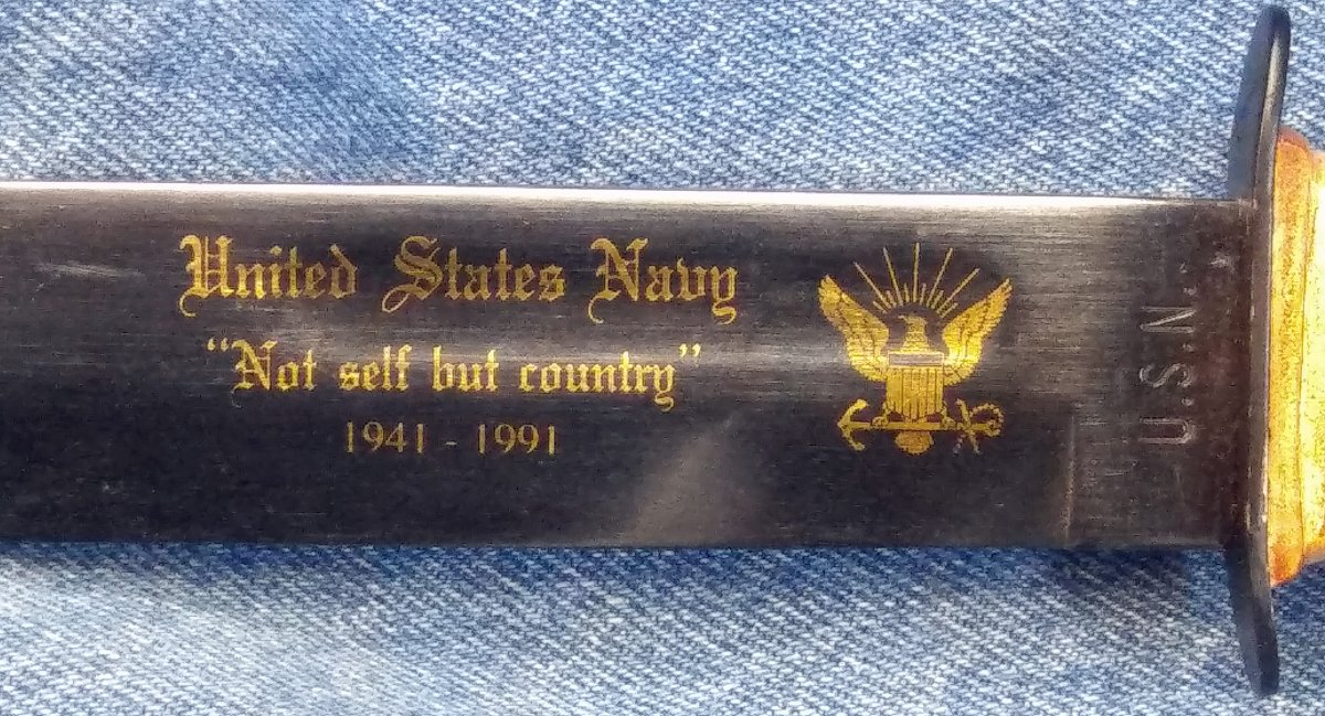

Given the dates of 1941-1991 on the blade, I think it is a Pearl Harbor 50 Commemorative but I have never seen a completed one. There is a pic in the 1990 Camillus catalog but I found it after I completed this knife.
I think I like contrast of the light and dark two-tone handle better than the factory version, but that is just me.
I hope you enjoy the pics.

Dale - that is a beauty!! You did a great job completing that knife.

I think it looks great Dale. You always do great work and that is an exceptionally good looking knife.

Beautiful work, as always Dale, and I am so glad to see that historic beauty properly finished!
What do you use for your final finish treatment on the leather rings?

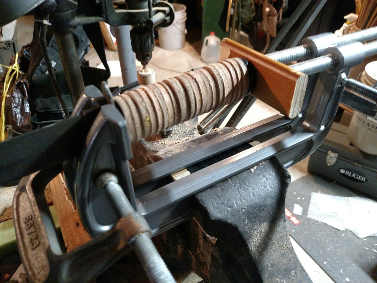

It came out great. When I did mine I glued the washers with wood glue and compressed them. They sanded like a piece of wood without the fraying issues you had. I used a carpenters belt sander, drum sanders in a drill press. Then I filed in the grooves colored them with sharpie. Then finished with cordovan shoe polish.
The glued compressed washers are much harder than I expected. No way it could be finished by hand.

Thanks for sharing your procedure for finishing your leather handle.eveled wrote: ↑Wed May 13, 2020 3:20 am When I did mine I glued the washers with wood glue and compressed them. They sanded like a piece of wood without the fraying issues you had. I used a carpenters belt sander, drum sanders in a drill press. Then I filed in the grooves colored them with sharpie. Then finished with cordovan shoe polish.

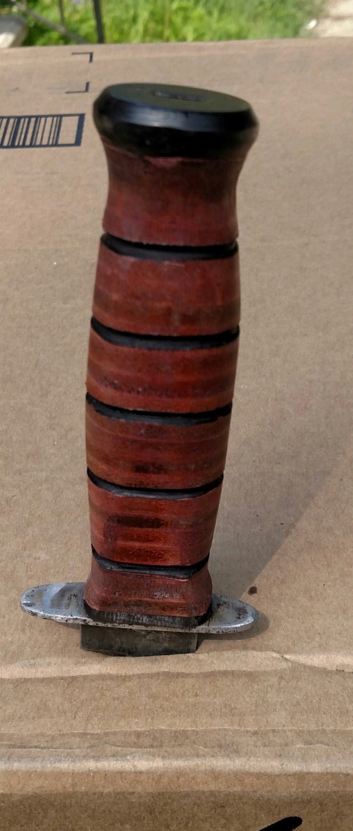

Thank you. If you ever do one I’ll be glad to answer any questions. Here is the way I compressed it.Meridian_Mike wrote: ↑Wed May 13, 2020 11:40 amThanks for sharing your procedure for finishing your leather handle.eveled wrote: ↑Wed May 13, 2020 3:20 am When I did mine I glued the washers with wood glue and compressed them. They sanded like a piece of wood without the fraying issues you had. I used a carpenters belt sander, drum sanders in a drill press. Then I filed in the grooves colored them with sharpie. Then finished with cordovan shoe polish.

The last coat I put on the handle was Fiebings Leather Balm.
I hope that helps Herb.
Y'all take care, and thanks again for the comments,
The first coding I put on was Gum Tragacanth, which is a burnishing compound. I burnishing the compound in by using strips of cloth dipping them in the compound and seesawing them back and forth on the handle. The gum is usually applied to the edge of the leather and then motion with friction is used to to set the gum up and harden the cut edges of the leather. I use it frequently on straps I cut and on the edge of sheaths. If you look up whether burnishing tools on eBay you can find their pretty inexpensive and quite varied in design.

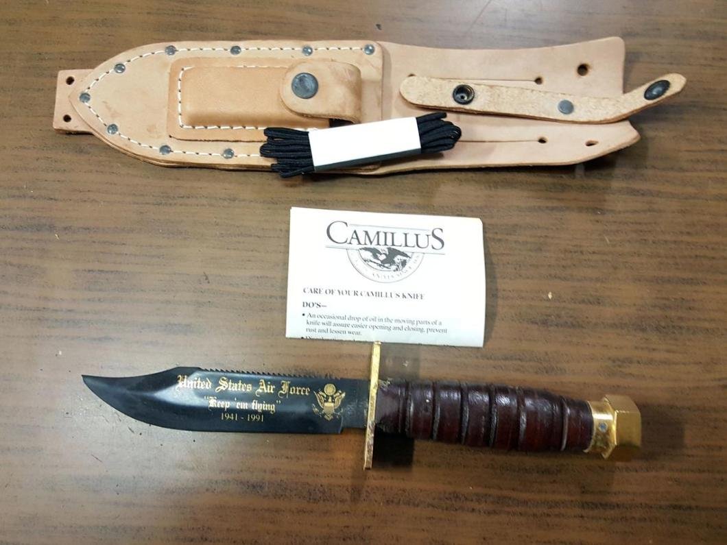

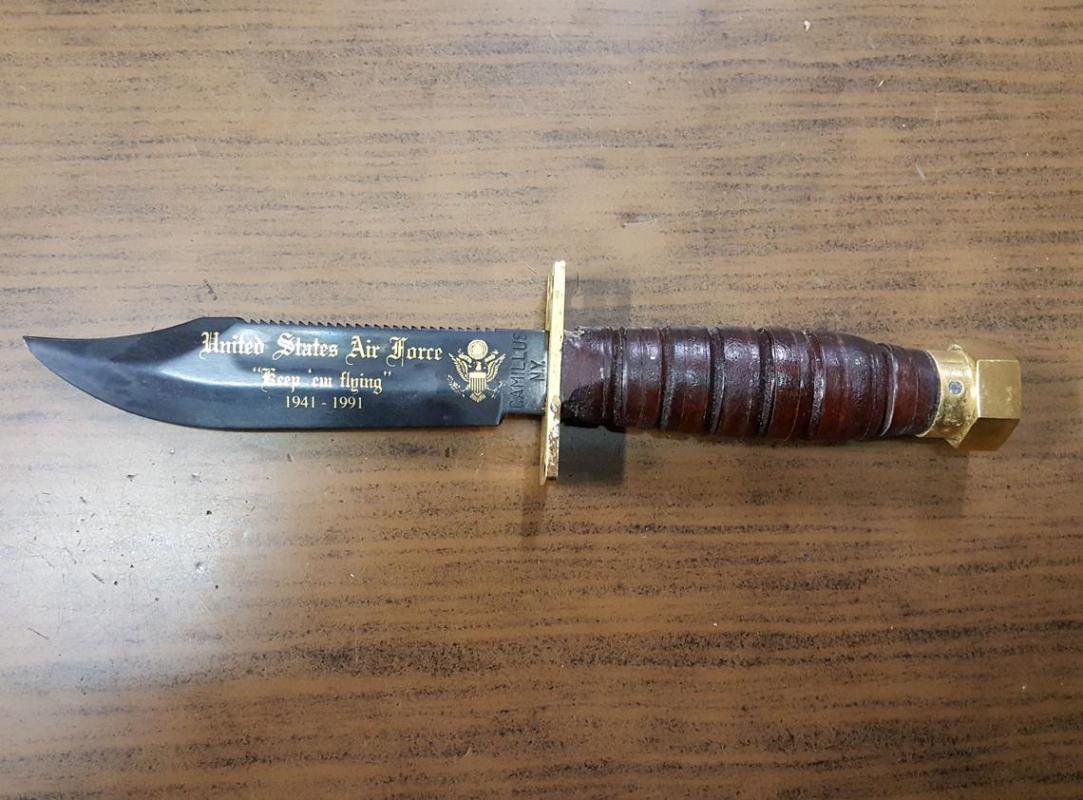

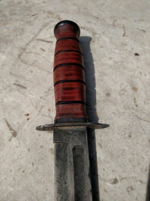

I found a couple of pics of a finished knife for sale.....
I Like the one you finished a LOT better Dale.
I noticed that the tang stamp is different on this one.....

It’s not the same blade. The logo fits differently, no saw back, different ricasso etc. The factory one is a Jet Pilot Survival Knife, Dales is a Mark2.
I wonder if it is a one off piece. Maybe the sample for the logo? Even cooler. It’s a one of a kind from the start.

Air Force vs Navy. Logo is different. Despite my upbringing...I like Dale's Navy one better.

Yep.... y'all are right..... This old man's eyes betrayed him. The tang stamp wasn't the only thing different.....LOL.
