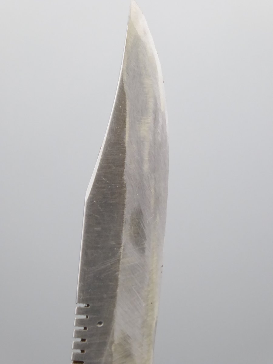

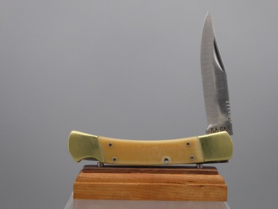

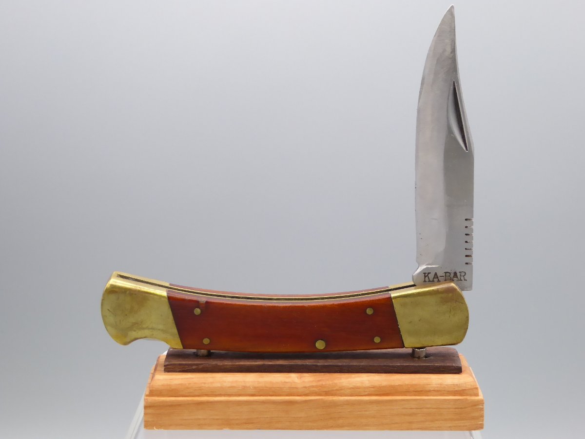

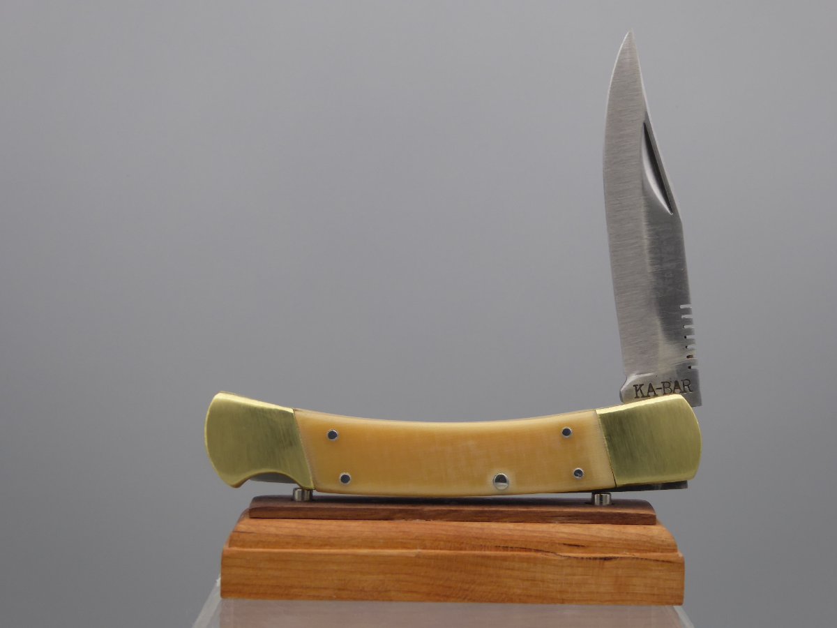

I had this well used Kabar knife in my store and since no-one was excited about it I decided to dress it up a bit.
The blade was heavily scratched from someone using a grinder to sharpen it along with numerous nicks in the blade edge. And the brass bolsters looked like they had been used as a hammer at some point. I had some bone colored linen micarta to use for the handles and decided to leave the brass bolsters and trim in a brushed finish (I'm just not a fan of brass bolsters). The brushed bolsters look better in person, the brushed look kinds disappears in the photo.
I resurfaced the blade and gave it a new edge with the Lansky sharpener.

Much improved.

Nice job Jeff!
HUGE change to a well deserving knife.
It's a beauty!

That turned out nice, Jeff! I especially like how much better you made the blade look!

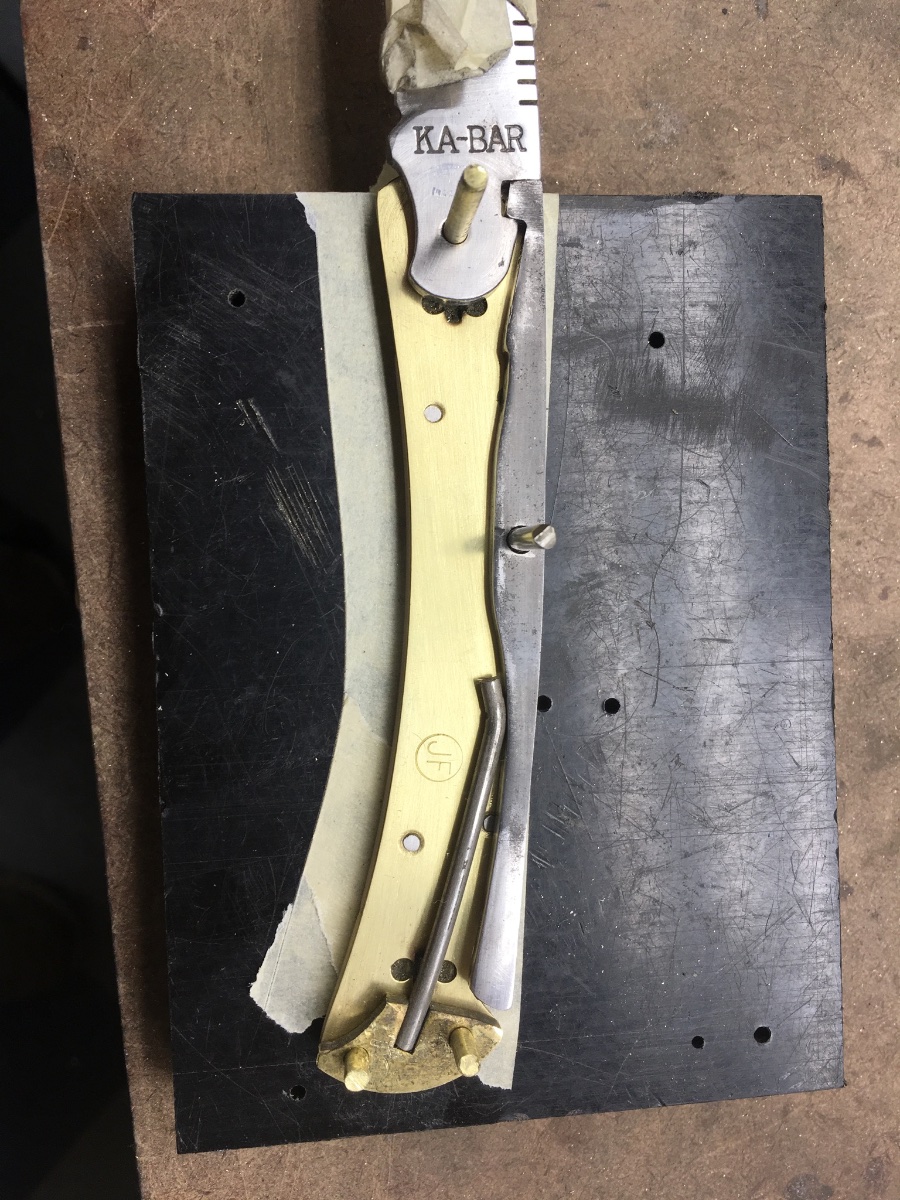

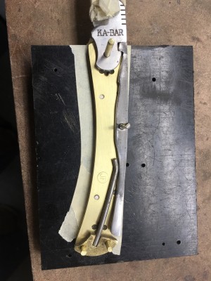

And I couldn’t help but notice that the spring arrangement for the Kabar folding hunter is a much stronger arrangement than the Schrade setup.
This one would also be easy to replace if it ever broke.

Nicely done Jeff! The cleanup of the blade made a drastic difference in the appearance.

I agree... a much better design!
