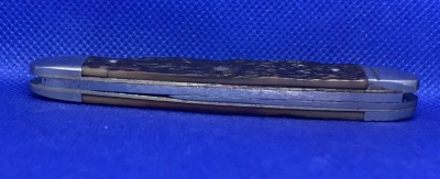

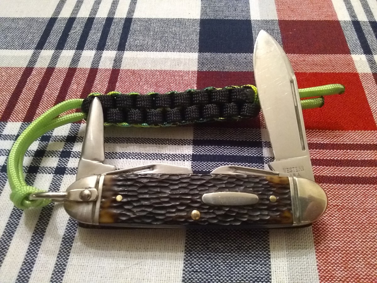

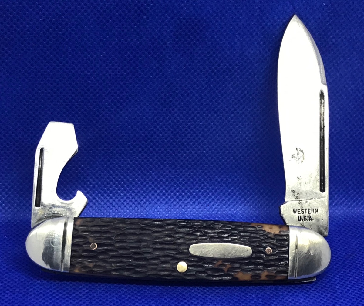

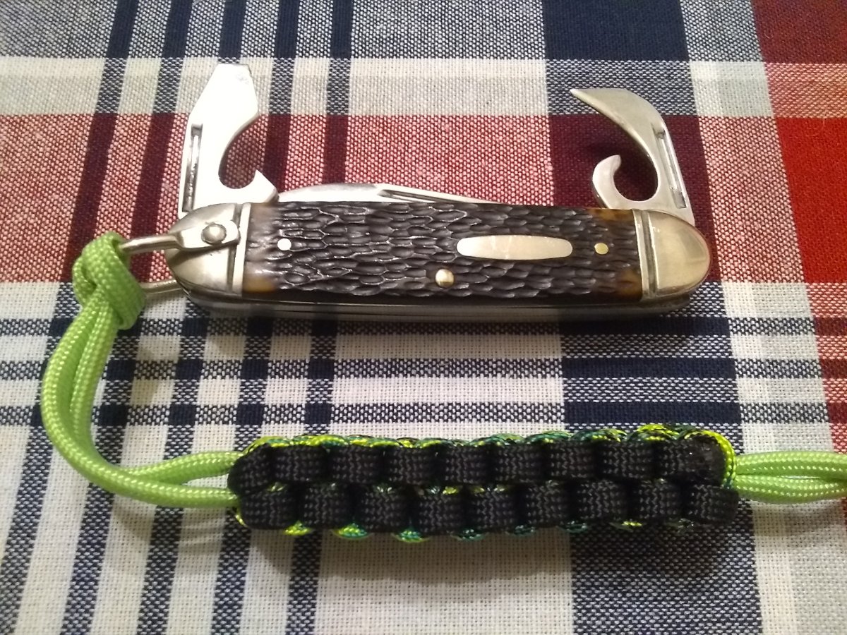

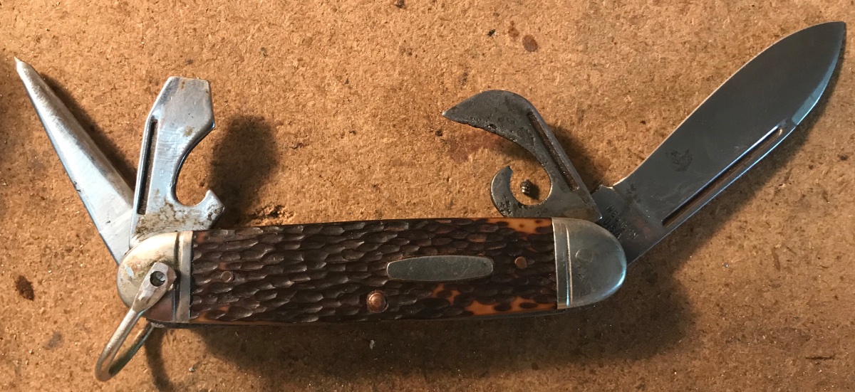

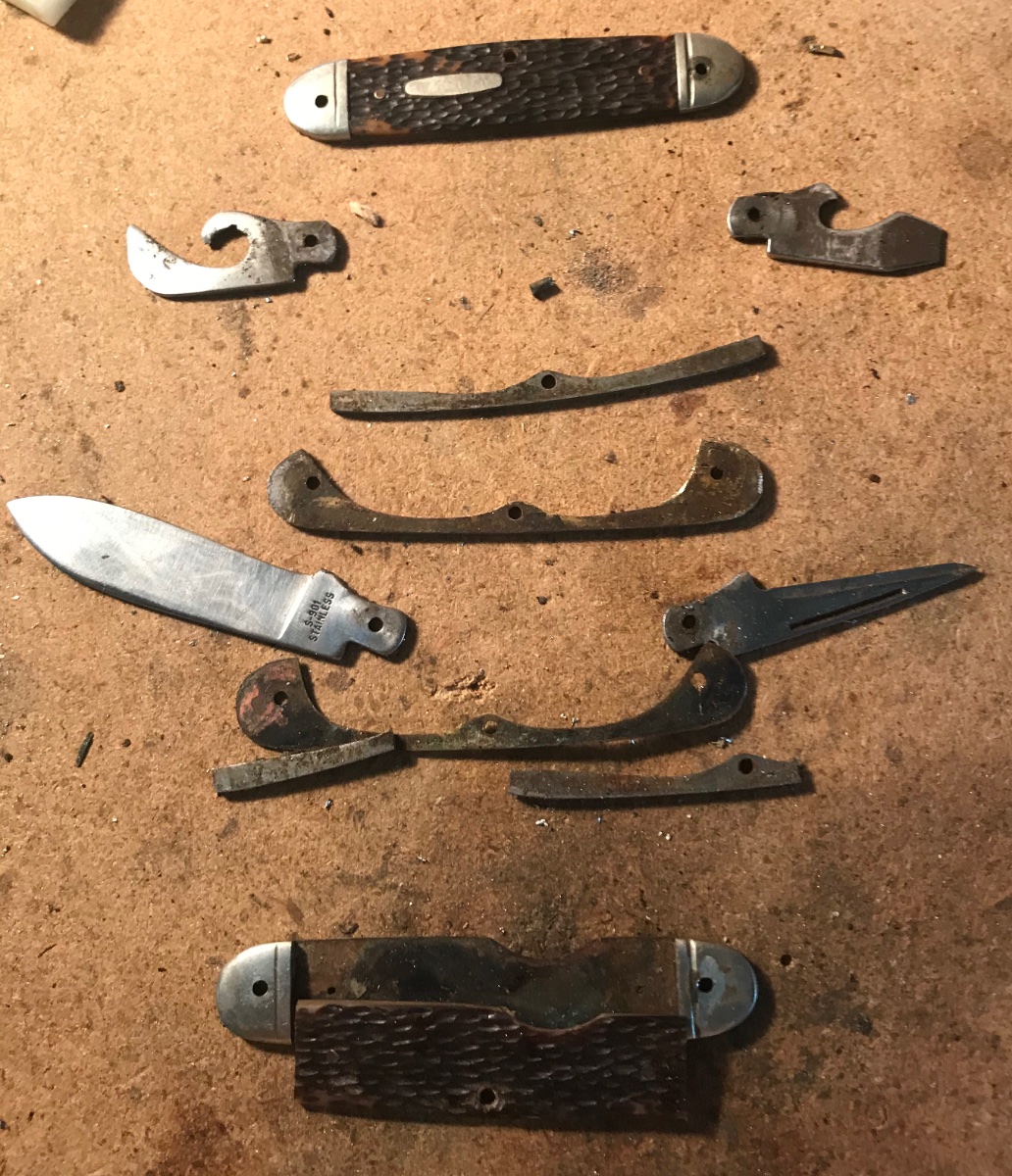

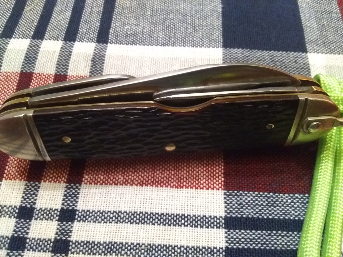

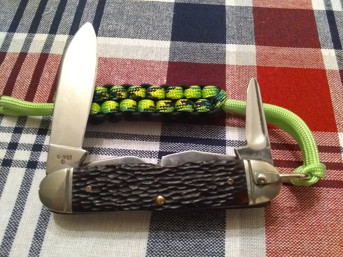

I got this Western camper knife with a broken spring for $0.99 plus shipping from eBay. I have not been able to do any "knife therapy" in months, but finally got the chance to go out to the shop today!

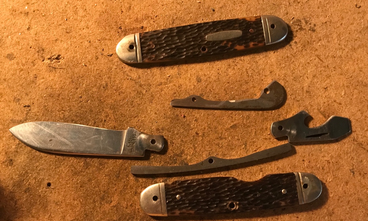

After studying it, I chose to remove some parts and go back with just the Main and screwdriver blades.
Of course, they did not line up well together, so I had to make a tapered spacer to give it some extra room, and then cut a new nail nick on the screwdriver blade. It would have been MUCH easier to have gone back with the punch blade instead of the screwdriver, but honestly I never use punch blades. I just wanted to make this into a decent EDC. It is not perfect, but it is certainly slim and much easier on the pocket than it used to be! After finishing I wish that I had rehandled it in bone, and put a small pen or sheepsfoot blade across from the main, but I am satisfied enough to just carry it as is.
