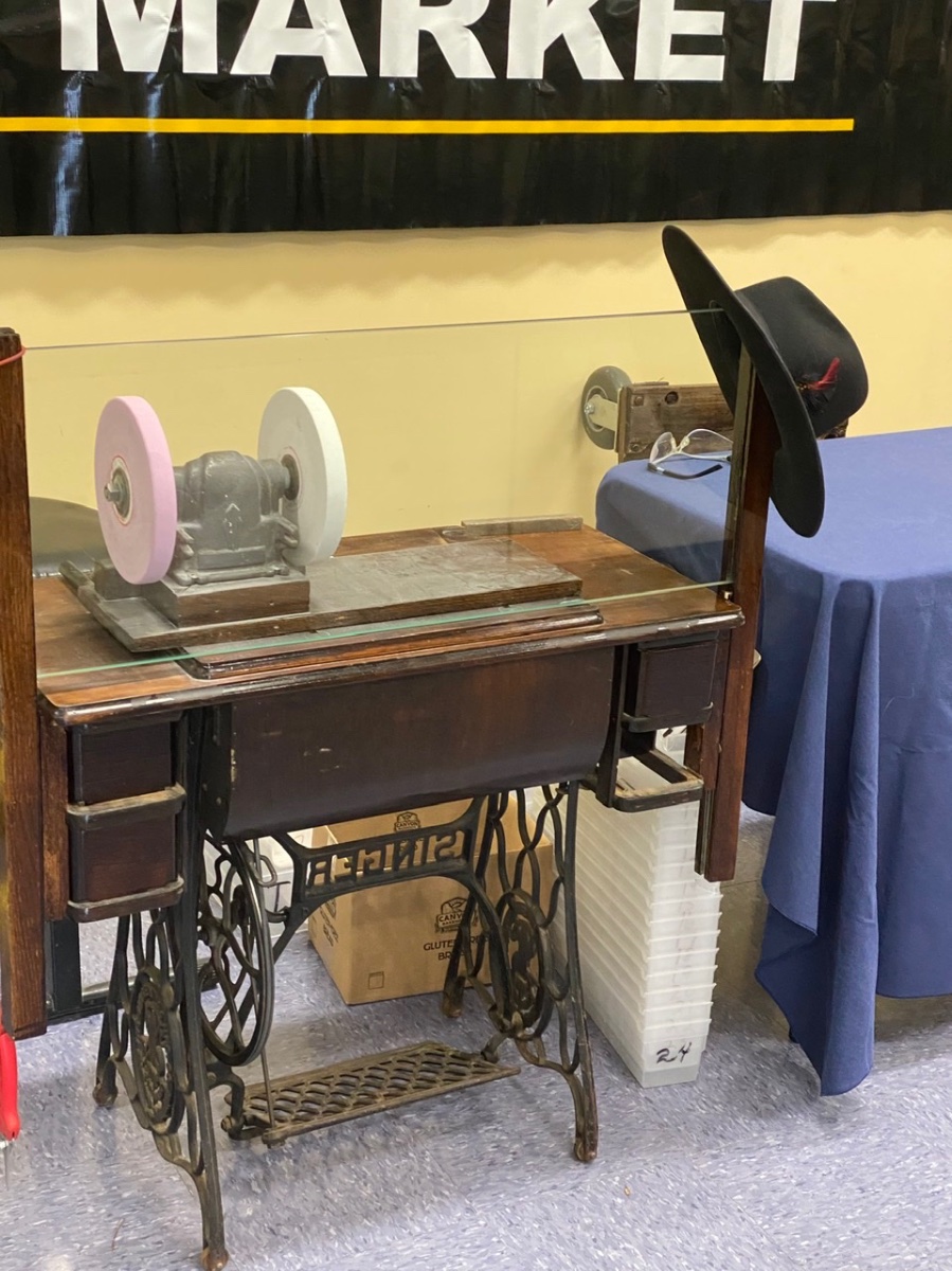

Not to be a wet blanket but you’re gonna have a hard time competing with guys who have automated sharpening equipment (belt sanders) and charge $2 a blade, $5 for a three-blade stockman. There’s a guy in a panel truck who comes to local trade days around here and sets up a workbench with three belt sanders, each a different grit, and a buffer. He will put a shaving edge on all three blades of a stockman knife, and lightly buff it if you want, in about 5 minutes, for $5. Since I sharpen my own, I don’t use his services myself but have talked with him and watched him work. Nice guy who knows his stuff.
I’ve seen guys (and a couple of women) doing the same at Cabalas, Bass Pro, at the stock show, etc.
Assuming you do it well your process sounds like it would be superior to his. But how many customers would care (or know) enough to pay the difference?
JMO

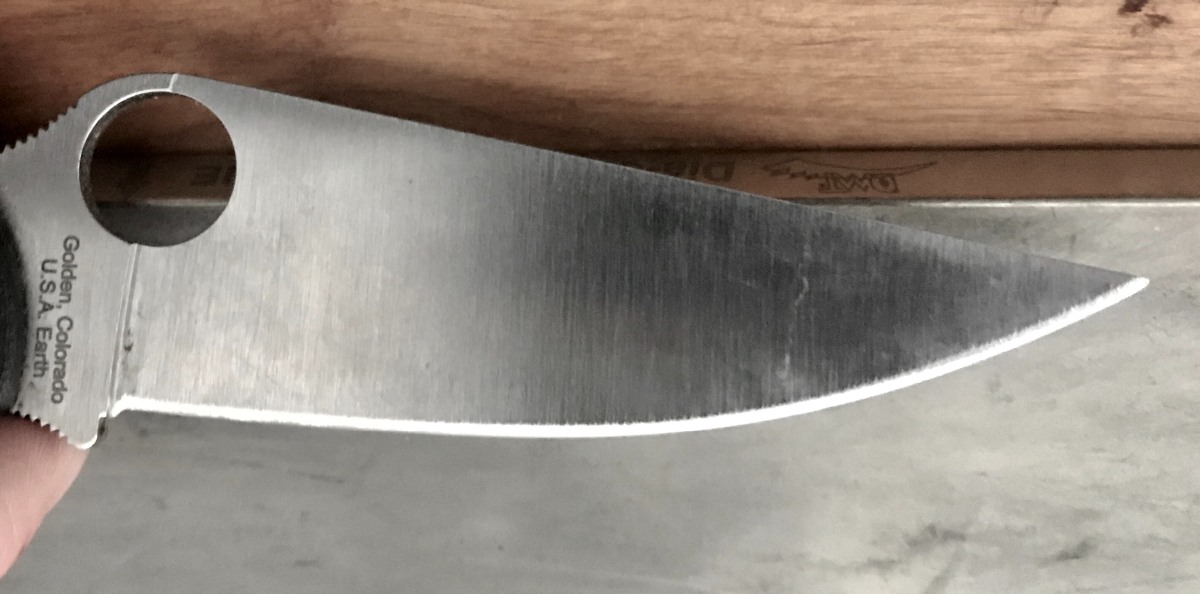

This is a Spyderco Military in S30V, a very hard steel that some folks have trouble sharpening. I had totally destroyed the edge stripping double coated wire and doing general farm chores. So today it was time for its first real sharpening. Three or four light passes on a 150 grit belt on my 1x30 belt sander followed by polishing it up for a few strokes on a DMT diamond hone 8k grit just to remove the wire edge and polish it up a might. It’s toothy, as in it’ll grab your finger when you test it, and it’ll shave hair with out pulling. No assorted series of complicated stones needed. And the total time including walking from my shop to the house to finish on the hone was about 10 minutes. If my hone were in the shop, maybe 5 if I hurried.Woody's Workshop wrote:I figured about $1 per inch on straight edged blades if you don't need to remove chip, dents (like someone used it as a screw driver) and other defects.

Well, let say it is an Amish Tormek. I took an old (1913) Singer sewing machine base and adapted an old belt driven pedestal to it. My wheels turn about 85-90 rpm.

Pictures??

Here is an old one but it will give you an idea of what I devised and use.
