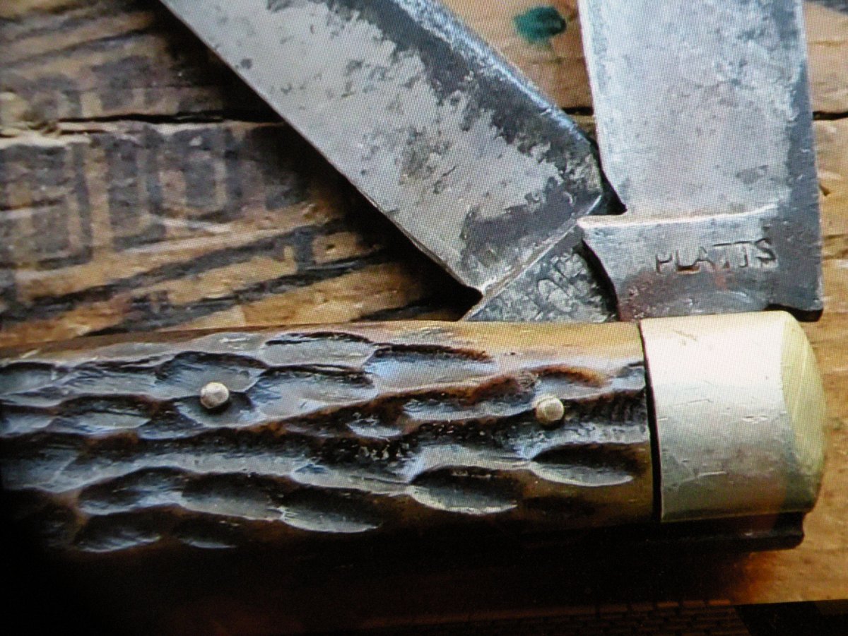

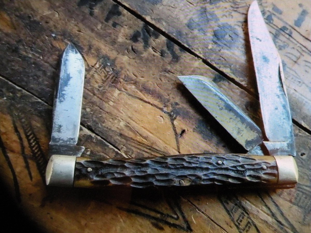

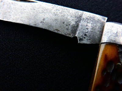

I'm skeptical, but just wondering if this could possibly be a genuine early Platts knife? I haven't been able to find examples of this knife or tang stamp in any of my reference books and would have expected a long pull on the clip. What do you think? ::hmm::
Herb

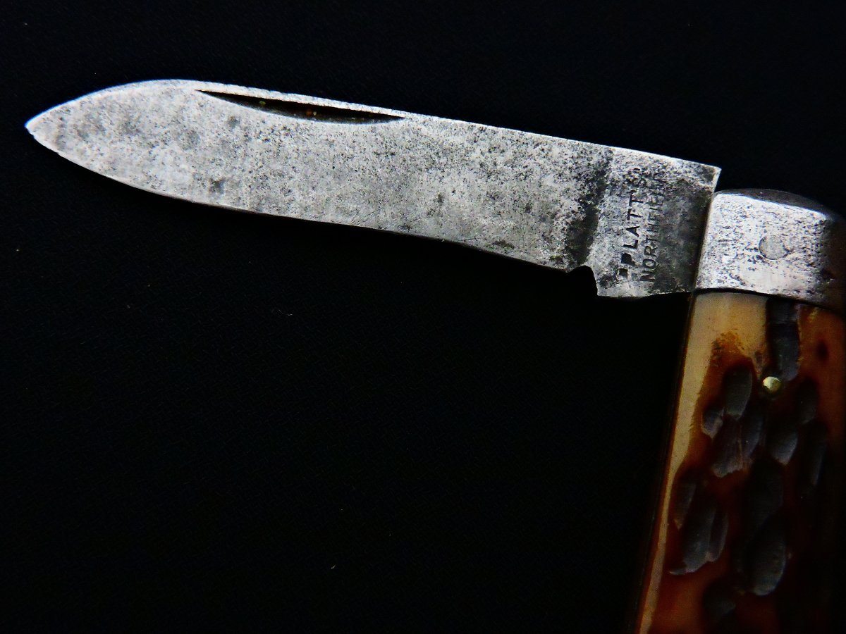

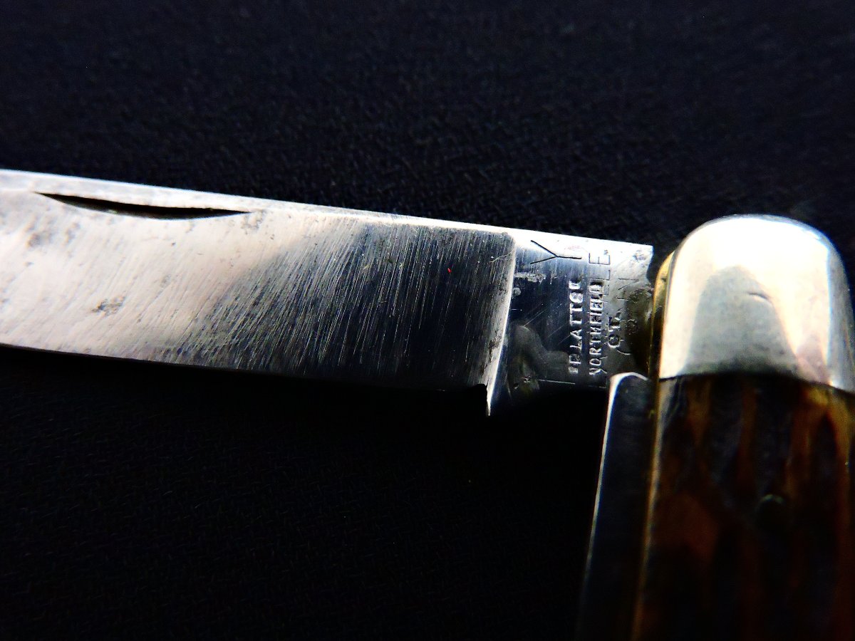

Hey...I bought s small jack a month ago....it is small.....but has the exact tang stamp...no body has any old Platts tang stamps....but your knife gives me hope that maybe just maybe we both scored 2 original Platts knives..FLEAS out

Are you guys referring to Platts Bros., or C Platts? I have not come across a stamping like this from their firm?

mcrunkin wrote: Fri Oct 23, 2020 8:43 pm Are you guys referring to Platts Bros., or C Platts? I have not come across a stamping like this from their firm?
I haven't seen this stamp either in any of the pictures I have looked at, and that is the main reason for my concern. But, I am wondering if this is an early stamp that Platts used. I know, "keep on wishing". :D

Is there a name on the sheepsfoot blade, I see what looks like letters but can't make them out.
Scott

The other blade has a different stamp on it.Maybe Holley.
Roger
Posts: 18949
Re: Platts Stockman - Could This Be Real???
I would guess HOLLEY too on the Sheepsfoot. Interesting how the scales are pinned too, wish I was home to look in Sargent's for it. ::shrug::

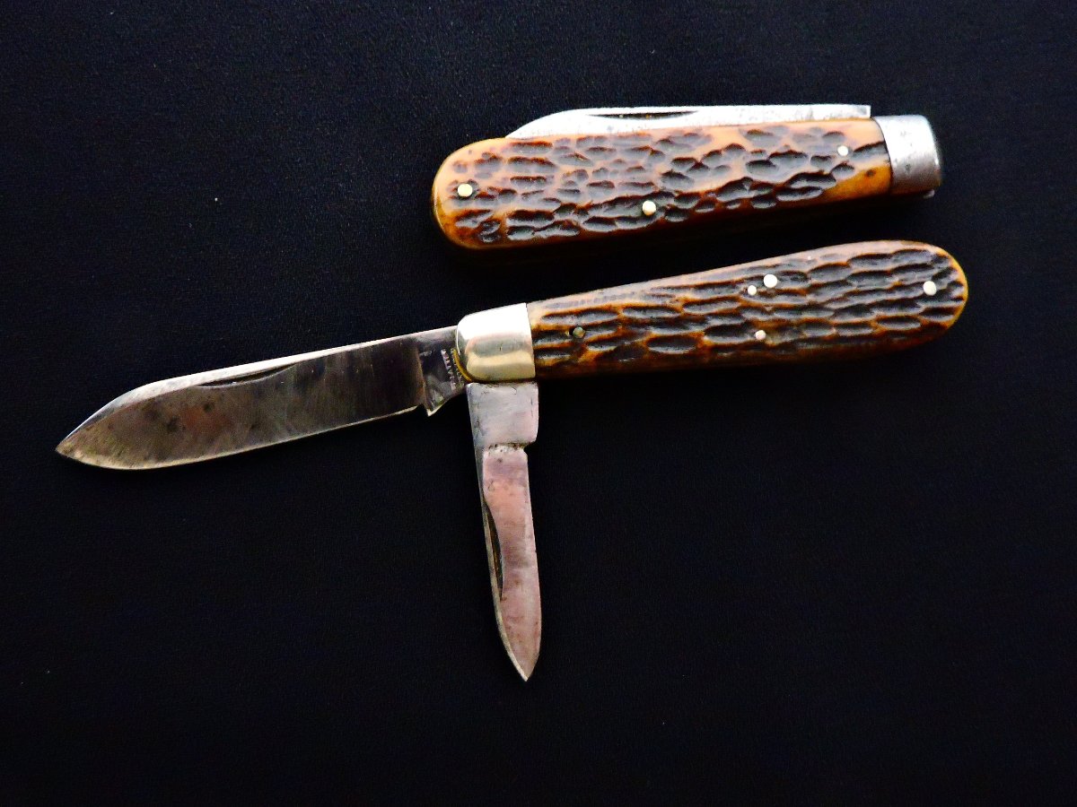

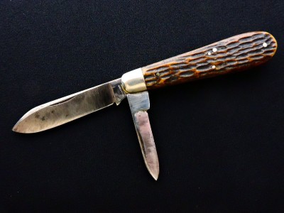

Here's a couple of boys knives that I have.
Two blade jack is 2 13/16" and the single blade is 2 7/8".
The little two blade knife was obviously made with Holley blades. He couldn't have gotten rid of all the stamping because it would have made the tang too thin. My theory.
The single blade knife doesn't appear to have been stamped.
These are sweet little knives that I treasure, and well made.
The print is from Goin's.

knifegnome wrote: Sat Oct 24, 2020 1:03 am Is there a name on the sheepsfoot blade, I see what looks like letters but can't make them out.
Scott
I also thought there was what possibly appears to be a tang stamp on the sheepfoot, and asked the seller about that. Here is the response I got:
"there s no other marks. if you research Platts you will see the connection. Thanks for your interest."
Sorry, I meant to include the link to the auction, but I probably forgot to do the paste part.
https://www.ebay.com/itm/Vintage-Case-P ... %7Ciid%3A1
Herb

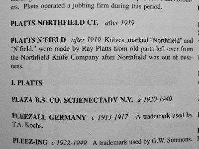

In the 1920’s , Ray Platts used that Stamp. He was putting knives together from parts and would grind the old stamp off and restamp it. Most authentic parts were from the old Northfield Plant according to what little information is out there.
Hope this helps.
Tom
herbva
Posts: 2030
Location: The Old Dominion
Post by herbva »
olderdogs1 wrote: Sat Oct 24, 2020 2:03 pm In the 1920’s , Ray Platts used that Stamp. He was putting knives together from parts and would grind the old stamp off and restamp it. Most authentic parts were from the old Northfield Plant according to what little information is out there.
Hope this helps.
Tom
Thanks Tom. Yes, that does help a lot. Goins does indicate that after 1919 knives were made by Ray Platts with parts left over from Northfield after they went out of business. The ebay seller got back to me after I inquired again about the apparent "HOLLEY" stamp, and he confirmed that is a Holley stamp on the sheepfoot. Goins also indicates that large scale production at Holley ended in 1915. So maybe this is why Ray was able to get some Holley parts to use with the Northfield parts. Very interesting stuff.
Herb

Well, I ended up discussing this knife at great length with the seller. He actually seems like quite a nice guy who wanted to learn about it, and is a knife enthusiast/ collector. He now understands that it is a Ray Platts concoction made from Northfield and Holley parts. I see it ended up selling for $179.50.
Herb
