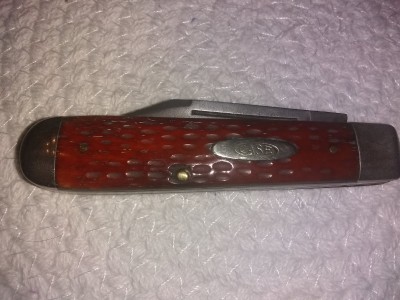

New to the forums and found this site after buying a Remington R1123 knife with a reddish jigged bone handle. I have been looking for other similar knives and haven't found any that have the fully reddish handle. I'm sure they are out there -- but my question is: what makes the handle reddish vs. brown like most knives ? Is it a natural occurrence or is it a man made feature.

If a knife is fitted with bone scales (handles), the cay be dyed any color the maker desires. Bone density plays a part in how much dye is absorbed, thus you may see variations in the shade of the color of dye on the same set of scales.

Remington bone isn't considered red,brown with a reddish tint maybe.But for the most part,it runs from very dark brown,almost black,to a blondish lite brown.
This reddish bone stuff comes from Case people calling brown bone with some red in it red bone,which it ain't. True red bone Case is red.Not reddish brown.True red bone Case knives are more valuable,thus,the desire to call it red bone.
Thanks for the replies. So would they have dyed handles back in the 20's 30's? This certainly has some reddish (dark mauve) color to it. I didn't know if this was naturally occurring or not.

The 1920’s and 30’s were not the stone age after all. Absolutely they were dying bone back then and even before.
Peanut740 is right. Unless it’s RED it isn’t red bone. Red is red and brown is brown, and I’m a Case fan. Your knife is most definitely brown bone.

So if I am understanding it right - virtually all bone knife handles that have color to them have been dyed entirely or in places to create "that bone handle look" since bone itself dries white. I always thought that it was a natural color feature or variation of an antler or animal bone. Thank you for the info.
