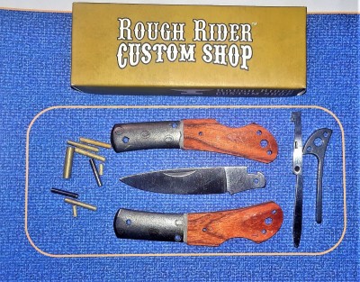

Okay, you guys must know by now I've never made a knife in my life. So I decided it might be fun
just to order a knife kit when I saw this one advertised. Now I know a bunch of you are very
good at knife restorations and making new knives and that this is like comparing a real jet to
just gluing a toy model together, but no laughing, alright. :roll:

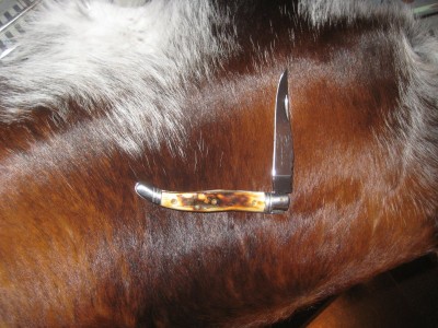

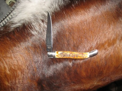

You Can Build a Knife! I built this one from a Kit. Made the Stag handles myself from a piece of Whitetail Antler. Thw whole project took one day. This knife is my EDC!

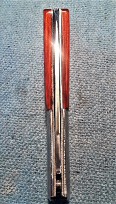

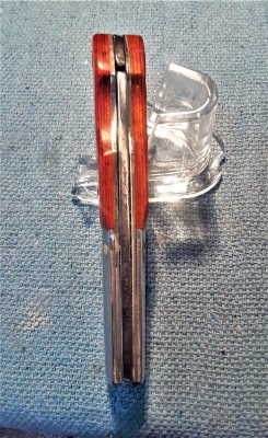

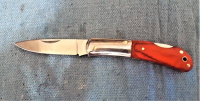

I'm a knife maker!!! ::rotflol:: ::rotflol:: ::rotflol::
You can all stop laughing now, I know I'm not a knife maker, but I had fun putting this knife kit together.
I should have taken pictures as I went, but I just got all wrapped up in what I was doing. I can honestly
say it's the best I've ever done...because it's the only one I've ever done! The wood handles had square
edges so I had to smooth them down and blend them into the bolsters and liners. The bolsters were still
rough, so I smoothed and polished them and I got the pins pretty smooth and flush. The blade was finished,
but had no edge, so it took me some doing to get an edge on it, and not draw blood. I'm rather proud of
my first attempt and I plan on doing a few more.

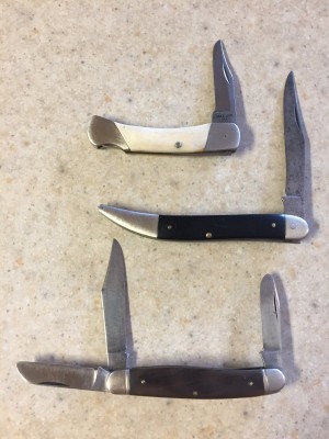

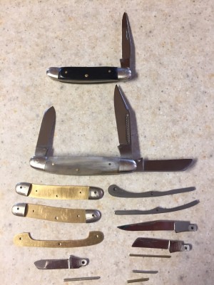

Here are the 3 knife kits that I’ve done so far.
The first one you’ve seen already, a single blade lockback 3 3/8” closed.
The second one is also a single blade lockback with bolsters on both ends. 3 ½” closed.
The third one is a 2 blade trapper, nickel silver bolsters, brass liners and pins. All 3 have wood scales.
On all 3 knives the blades are tight, with no wobble. When opened all blades are secure with no movement and when closed the alignment is near perfect except for the second lockback.
There are still some small scratches in the wood and a small crack near a pin on the trapper.
All blades are still unpolished and have no edge. My youngest son has some professional equipment for sharping knives and I will have him do that task. He sharpens knives for several restaurant and hotel chefs in the local area.
If you’ve never done one of these knife kits, they come with all parts separated. You shape and glue the wood to the liners, cut the pins and when the knife is assembled you grind, shape and polish all the metal, wood and pins to the finished product.
Overall I would give myself a B+ and move on to replacing the scales on a couple of old knives. However I do intend to keep doing some more knife kits.
I have a metal stamp kit that I’m ordering with letters and numbers along with one that has the shape of Texas. I plan on marking my knife kits with my initials and the state of Texas on the tang.
I welcome any and all feedback on my little adventure in knife kits.
