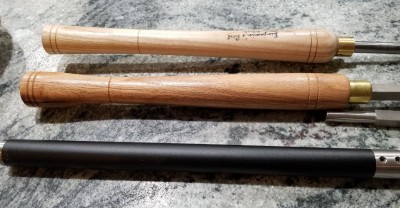

Really enjoying the lathe. I picked up a new live center along with a Jacobs chuck, and some carbide chisels. The carbide set had 4 tools, but only 1 handle. It is a little cumbersome to swap the handle when you want to change tools, so I made my first wooden tool handle (the middle one in the first two pics.) I bought the brass ferrules from Amazon. I will make a couple more so that I don't have to swap handles. I have also been practicing turning some live edge bowls.

I watched a few Youtube videos on making tool handles, and I used the "Benjamin's Best" handle in the picture to copy the design. One of the video's said to drill a small relief hole in the handle to expel the air and excess epoxy when you push the metal chisel into the handle.....as it kind of makes a syringe effect. I thought, nah, I don't need to do that. ::doh:: When I pushed the handle in, it kept sliding back out due to the trapped air. So I did indeed have to drill a tiny hole on the back side of the handle to relieve the air and epoxy. I finally got it seated, and pressed the air and epoxy out of the hole.
And I also clamped it longwise, just to make sure it stayed seated.
Learning as I go....

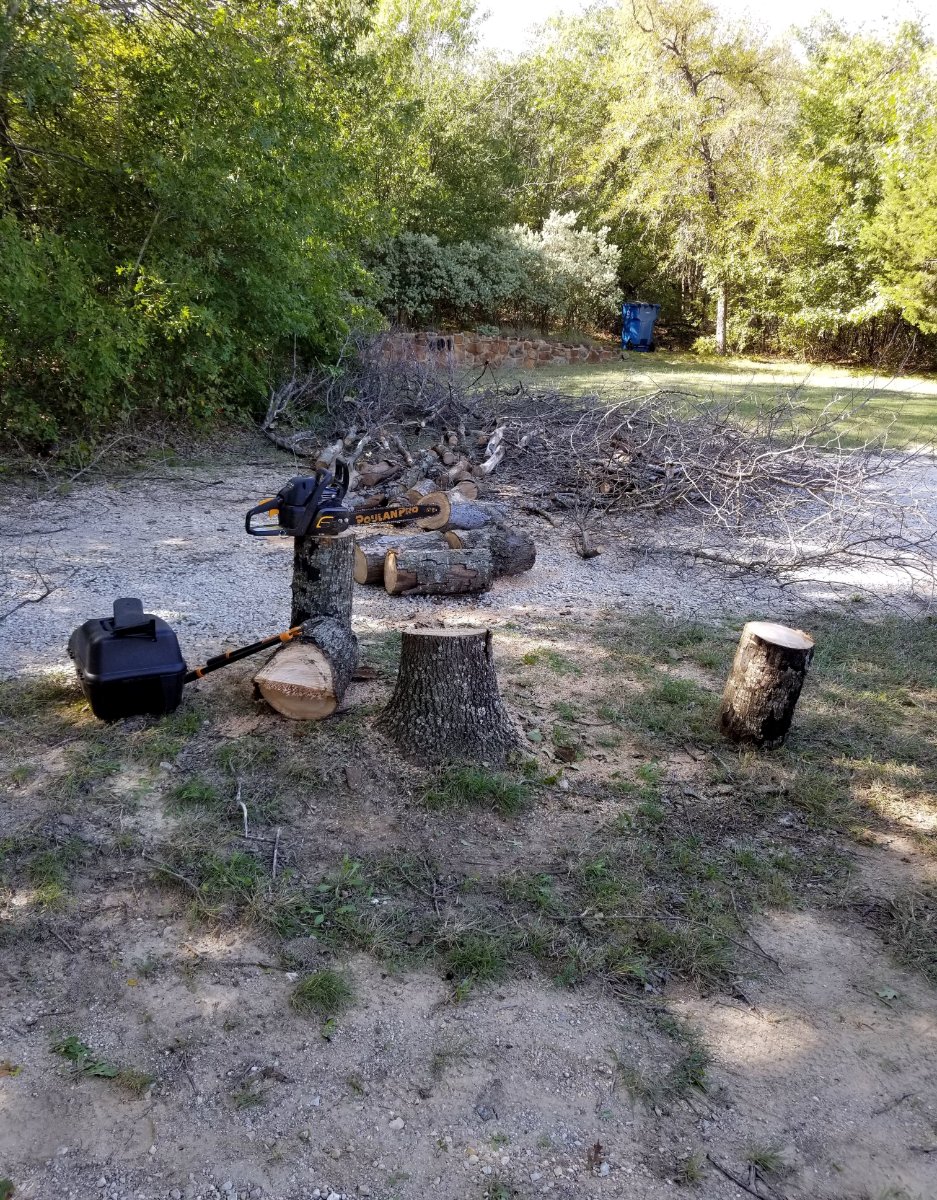

The oak tree I am using died from Oak wilt disease. I took it down this fall. The pic below shows what my bowls and handle looked like a few months ago:

Nice job on the tool handle and I love the live edge bowls. The best wood for live edge bowls is green cut wood that is cut in the winter when the sap is down in the wood, makes the bark stick better on the edge. When I make my tool handles, I buy 1 inch copper pipe couplings and cut them in half, making 2 ferrals.

I checked out a few videos where they made the ferrules out of copper pipe, and had considered doing that. Then I saw these ferrules and I like the rounded-over top. They are pneumatic hose ferrules - Here's what I used:
https://www.amazon.com/gp/product/B00VT ... UTF8&psc=1
