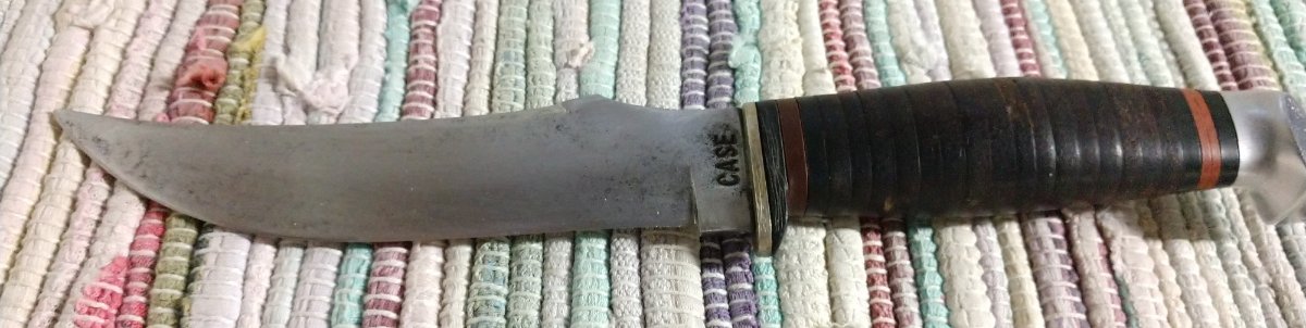

Is this real or fake????
This knife has been in my uncle's possession for more than 50 years. The only stamp is Case....no double XX stamp. Can anyone tell me if this is a counterfeit or real?IMG_20210102_163108959.jpg

Re: Is this real or fake????
It's real. Circa 1950s by the mark. Case used the XX off and on on fixed blade knives.
Thank you KLJ77 and Gunsil, for your input on this knife. There is so much information on the interweb that it's hard to decipher. None of the stamps that I saw looked like the stamp on this knife.
Well, Whistlepost...rest assured, when Gunsil stated that it was the real deal, then it's real. Tang/ricasso stamps can be quite confusing. However, you have to remember that; your knife is somewhere around 65-70 years old, and a lot has changed in that timeframe.Whistlepost wrote: ↑Mon Jan 04, 2021 12:41 am There is so much information on the interweb that it's hard to decipher. None of the stamps that I saw looked like the stamp on this knife.
Most of the Case tang stamp charts are for Case pocket knives not fixed blades, and that mark was not a pocket knife stamp. There are presently no reliable Case fixed blade stamp charts but Brad Wood, the leading Case hunting knife expert has told me he is working on one and hopes to have it published in an article for Knife Magazine. The charts available for Case pocket knives also have mistakes in them, perhaps somebody will come up with better charts in the future. Your uncle's knife would have had a chrome plated blade and it looks like somebody sanded it off, but that certainly doesn't hurt it's usefulness.
Chrome plated to discourage rust. Per Brad Wood article on Case fixed blades published in Sargent’s 7th Edition, chrome plating first appeared in 1934, was apparently discontinued in 1982 -1983.
Made by Case in Bradford, PA. Case had their hunting knives made for them by Kinfolks 1926-1932 and then went back to making them theirselves. They still make their own, at least they still were when I visited the factory for a tour three years ago.
Looks like a model #323 Hunter.
Case fixed blade knives are not faked very often and when they are the attempts are very poor at best. A well done Case fixed blade fake would normally be done on a knife of much more valure than the OP knife.
