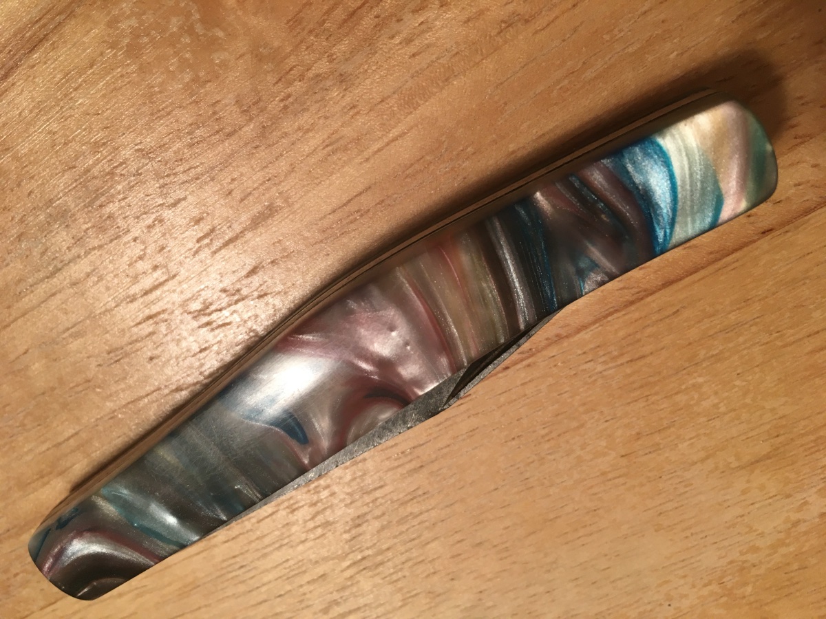

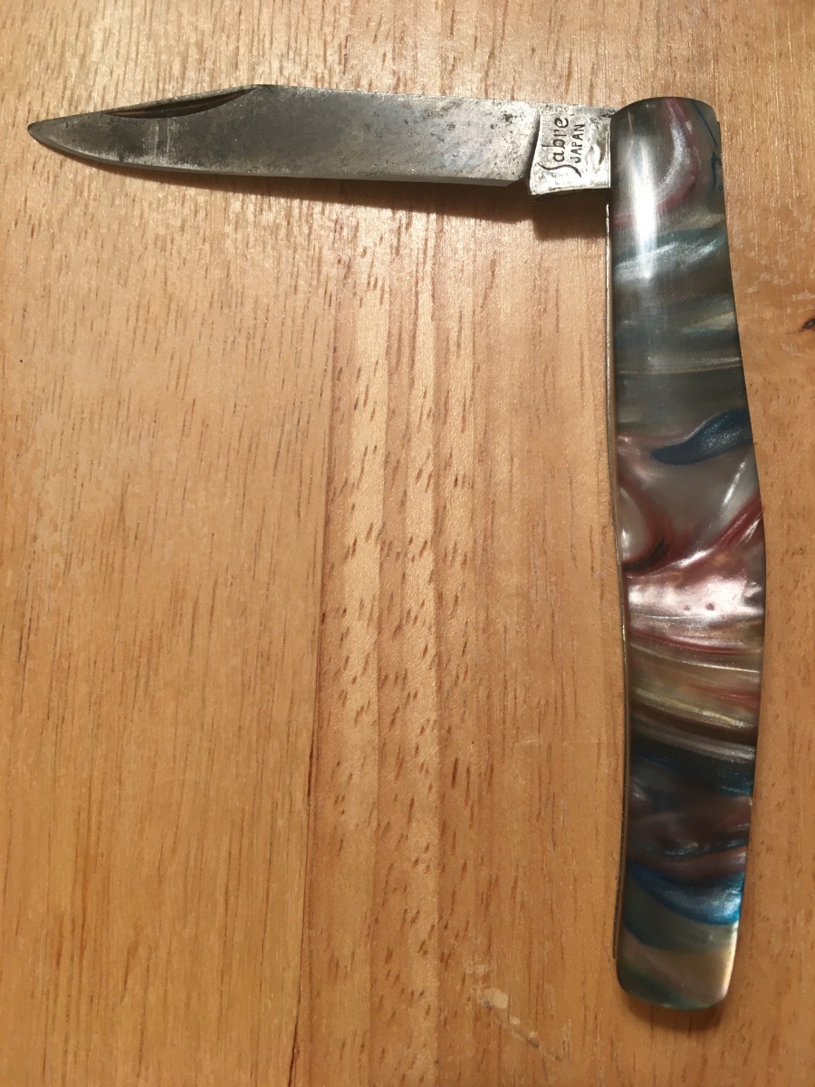

This is my second successful re-handle, and I'm pretty excited about it. This was an old Sabre stockman with a broken secondary blade. I took it apart and removed the two secondaries, the spacer and back spring, and cleaned (and straightened) the remaining parts. It was missing a bolster, and with no good way to make one and no donor knife, I just decided to eliminate them.
The handles are an acrylic from Jantz, which forms easily and polishes up pretty well. This is good, since I'm using all hand tools (with the exception of a Dremel and an electric drill). I suppose some day I'll get a band saw and a belt sander and a drill press and a...
I chickened out and decided to glue the handles on this knife, because I've so far managed to crack almost every handle I try to pin. I'm sure it's a technique thing, but I don't have it figured out yet. Anyway, I'm pretty happy with the way it looks, and as long as the epoxy holds up, it should be fine. It's going to be an EDC, but I'm not too hard on knives, so it should hold up well. The blade took a great edge, by the way. I guess I'll see how long it lasts.

Beautiful work! I really like the way that old Sabre turned out. I used to have the same problem with pin cracks. Finally, I realized that you only need to peen the scale pins down until they are just, lightly, locking the scales down to the liners (Not Any More Pressure Needed). It's just a "touch thing" and with a little practice you will get the hang of it.

That's kind of what I was thinking. Is that also true for the center pin through the spring?herbva wrote: ↑Fri Mar 05, 2021 1:01 am Beautiful work! I really like the way that old Sabre turned out. I used to have the same problem with pin cracks. Finally, I realized that you only need to peen the scale pins down until they are just, lightly, locking the scales down to the liners (Not Any More Pressure Needed). It's just a "touch thing" and with a little practice you will get the hang of it.![]()

The answer is yes and no. The rocker pin (center pin through the spring) is of course critical to holding the spring "loaded" and in the right position, but it also helps hold the middle part of each side of the frame together. But, like the scale pins, if you overdo it you can cause pin cracks in the usual spot between the rocker pin head and the edge of the scale. Or even worse, if it is too tight it can eventually cause that entire little piece next to the rocker pin head and the edge to crack and pop off. That's why you see that little chunk missing so often. So, you want to get it flush, but just tight enough. There are a few tricks which can help prevent cracks or chips in that area. The one I use is I drill the hole in the scale material just ever so slightly larger than the hole in the metal liner, so all the stress from the pin holding the spring loaded and in place is on the metal liner, not the scale. Or, sometimes I just use the burr that I am using to taper the bolster holes to widen that hole a tiny bit. Others might have different approaches. I hope this helps and doesn't just confuse.beresman wrote: ↑Fri Mar 05, 2021 4:58 pm Thanks, fellas!
