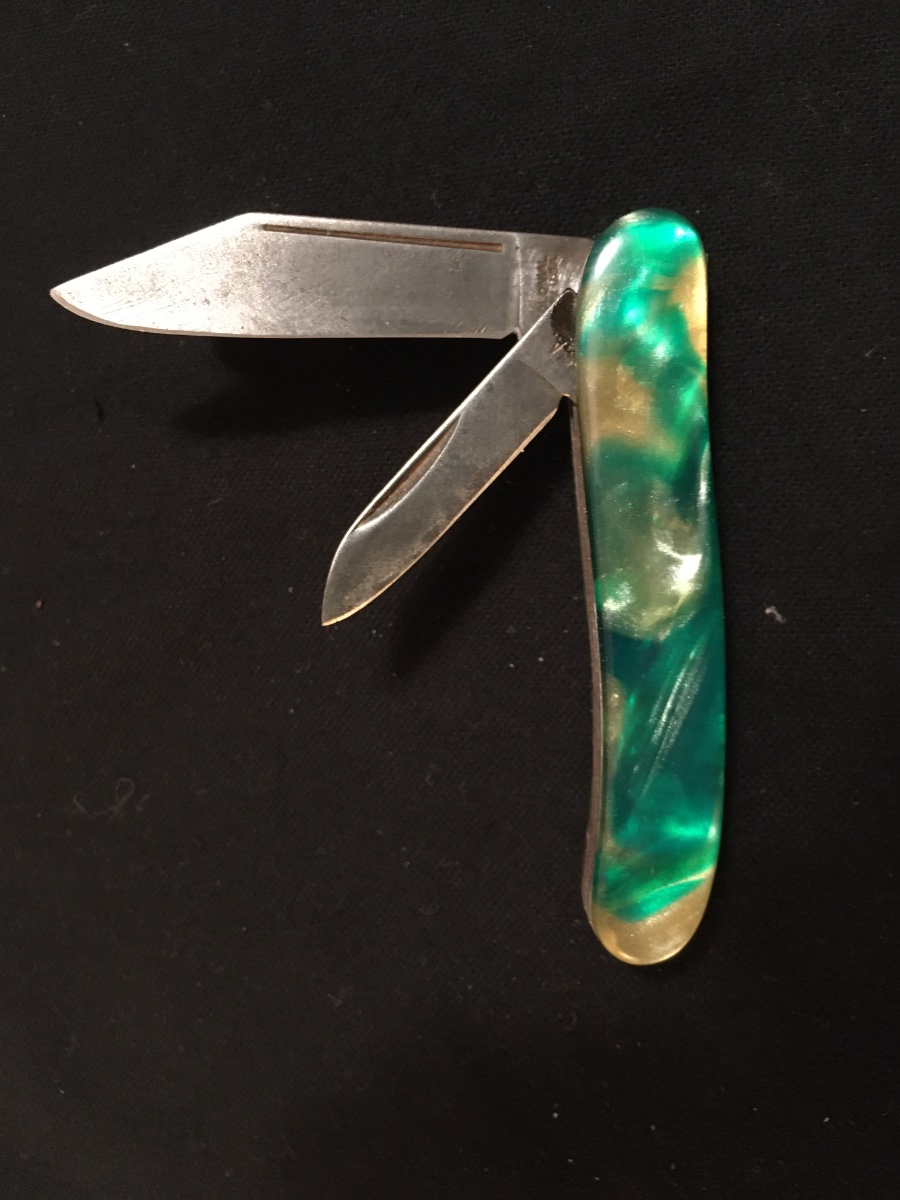

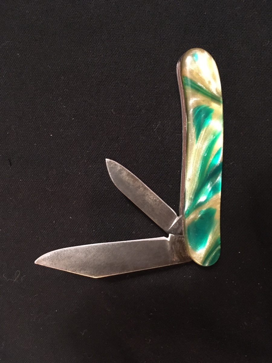

Here's another one I re-handled--this one was originally a shell-handled Colonial, which when I got it did not have any handles. I basically just cleaned it up and cut the material to fit. Glued on again, because I didn't see any point in taking apart a fully functional (though dirty and dry) knife.
The blades had never been sharpened, but needed it desperately. Wow, they took quite an edge!
On to one that I have to pin...gotta get that figured out. Woo-hoo!
Brent

Looks great! What is the material you used?

dlr110 wrote: Fri Mar 12, 2021 2:55 pm Looks great! What is the material you used?
It's an acrylic that I got from Jantz supply. They call it "Fantasy Marble" and the color is "Emerald Light". I've used a couple of different colors of the stuff, and it's pretty easy to work with. The slabs are pretty thick, though, so I cut them in half thickness-wise.

Quote: "The slabs are pretty thick, though, so I cut them in half thickness-wise"
how do you do this and maintain consistent thickness ?

beresman wrote: Fri Mar 12, 2021 11:07 pm
Okay, now that you've said that I do remember seeing that on their website. I was thinking about ordering some, but just haven't done it. Thanks. ::handshake::

kootenay joe wrote: Sat Mar 13, 2021 5:07 am Quote: "The slabs are pretty thick, though, so I cut them in half thickness-wise"
kj
With great difficulty and less success. If I had a band saw, I could use that, but I'm putting them in a vise and cutting through the thickness with a fine-blade hacksaw. I don't do a perfect job of it, so one side always requires more work to shape than the other.
The other thing that's true about this material is that one surface is more colorful than the other (as it is received). By cutting through the middle of the thickness, I get a more consistent color pattern between the halves.
Brent
