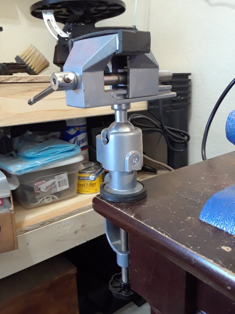

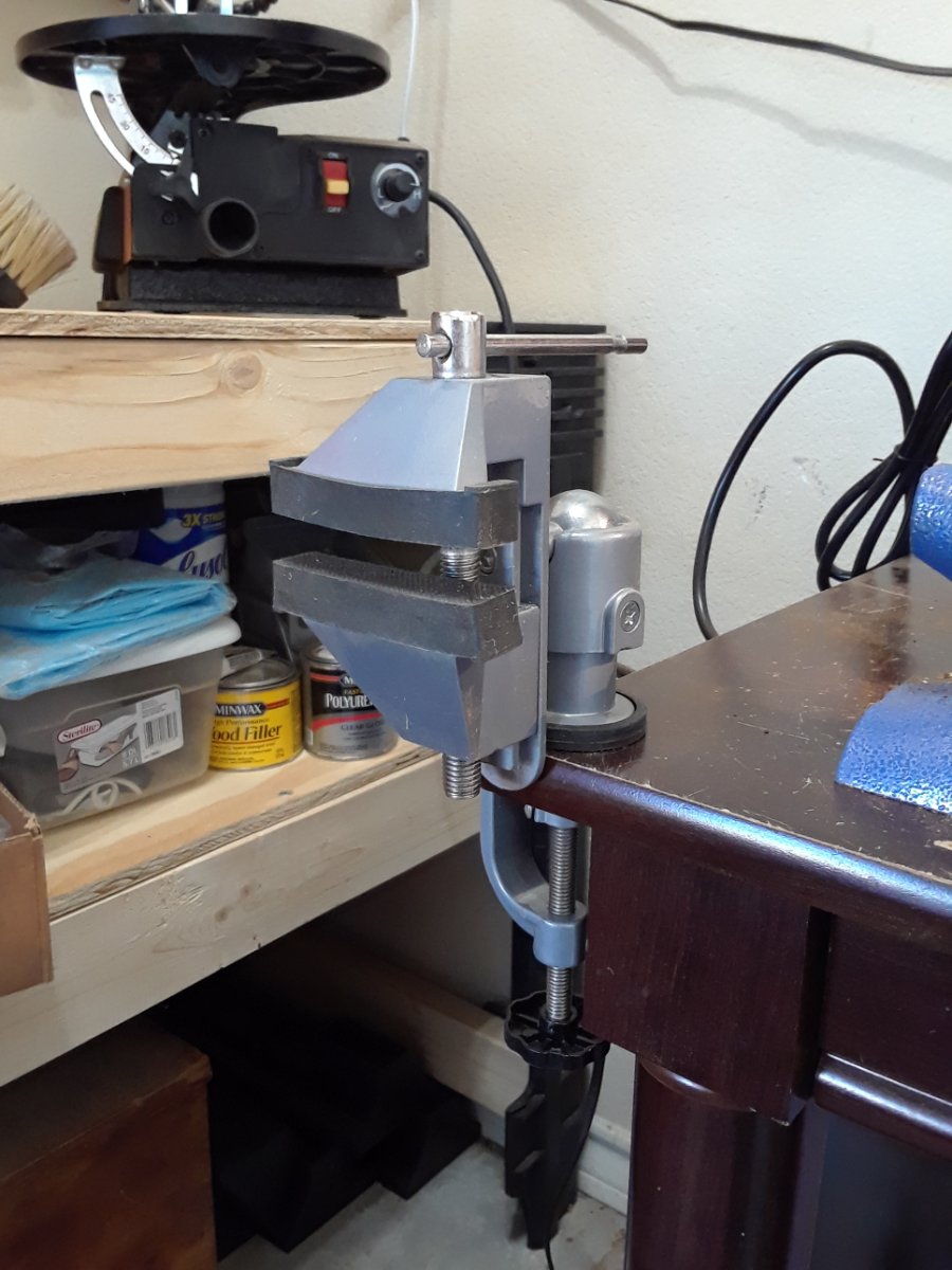

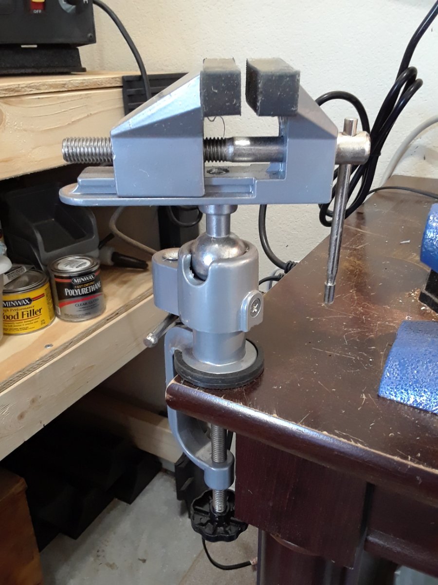

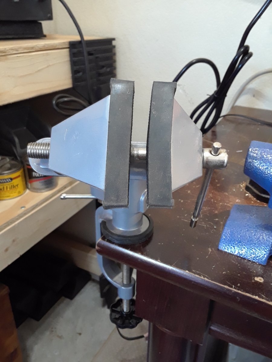

Here is one I just got.
Fasmov Swivel 3" Universal Table Vise Tilts Rotate 360° Universal Work Amazon $18.99
About this item
The Table Vise will not deform even under high pressure, the vise is made of cast aluminum, the jaws are made of hardened high-carbon steel alloy, and the movable parts are made of precision milled heat-treated chromium plate carbon steel.
Jaws are 3" x 3/4" / 79mm x 17mm with a 2" / 51mm opening, the clip has a wide enough opening for any workbench or table.
Adjustable and rotates to any possible angle, rubber Jaws for no scratch and firm clamping, enabling you to lock the workpiece in any position.
Rubber on the jaws can be removed to reveal a cross pattern for use on wire/rods, The overall design of pliers has laid a good foundation for the smooth completion of your work.
Lightweight, small vise, easy operation, Ideal for holding small parts in Jewelry, Hobby, Model making, Electronics and more.

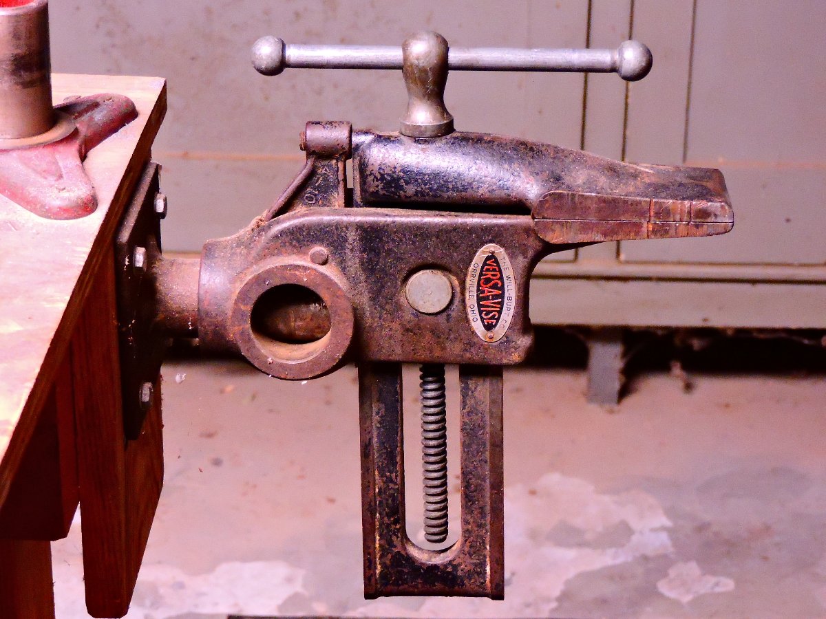

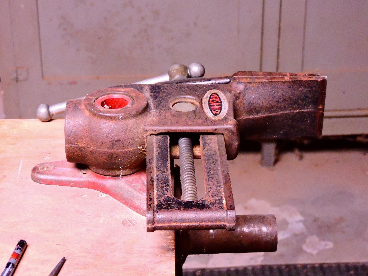

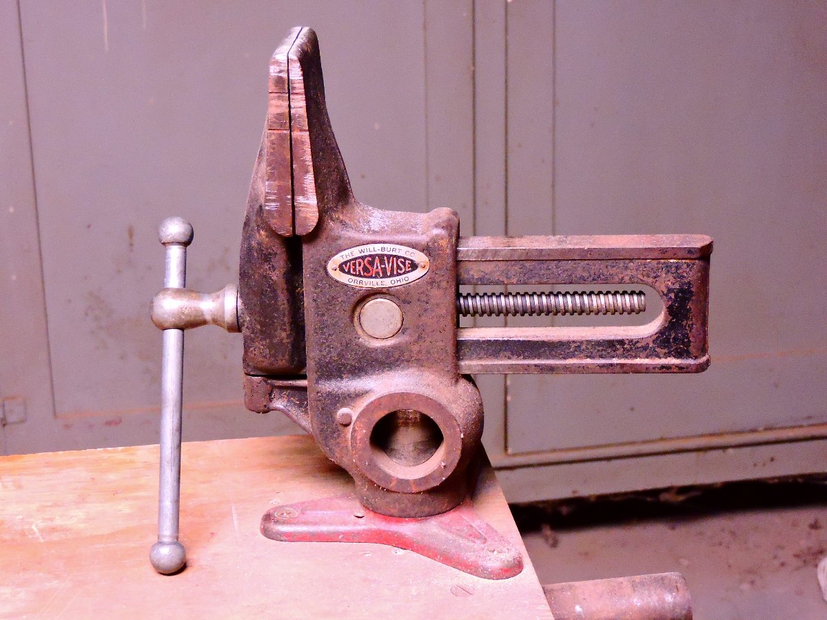

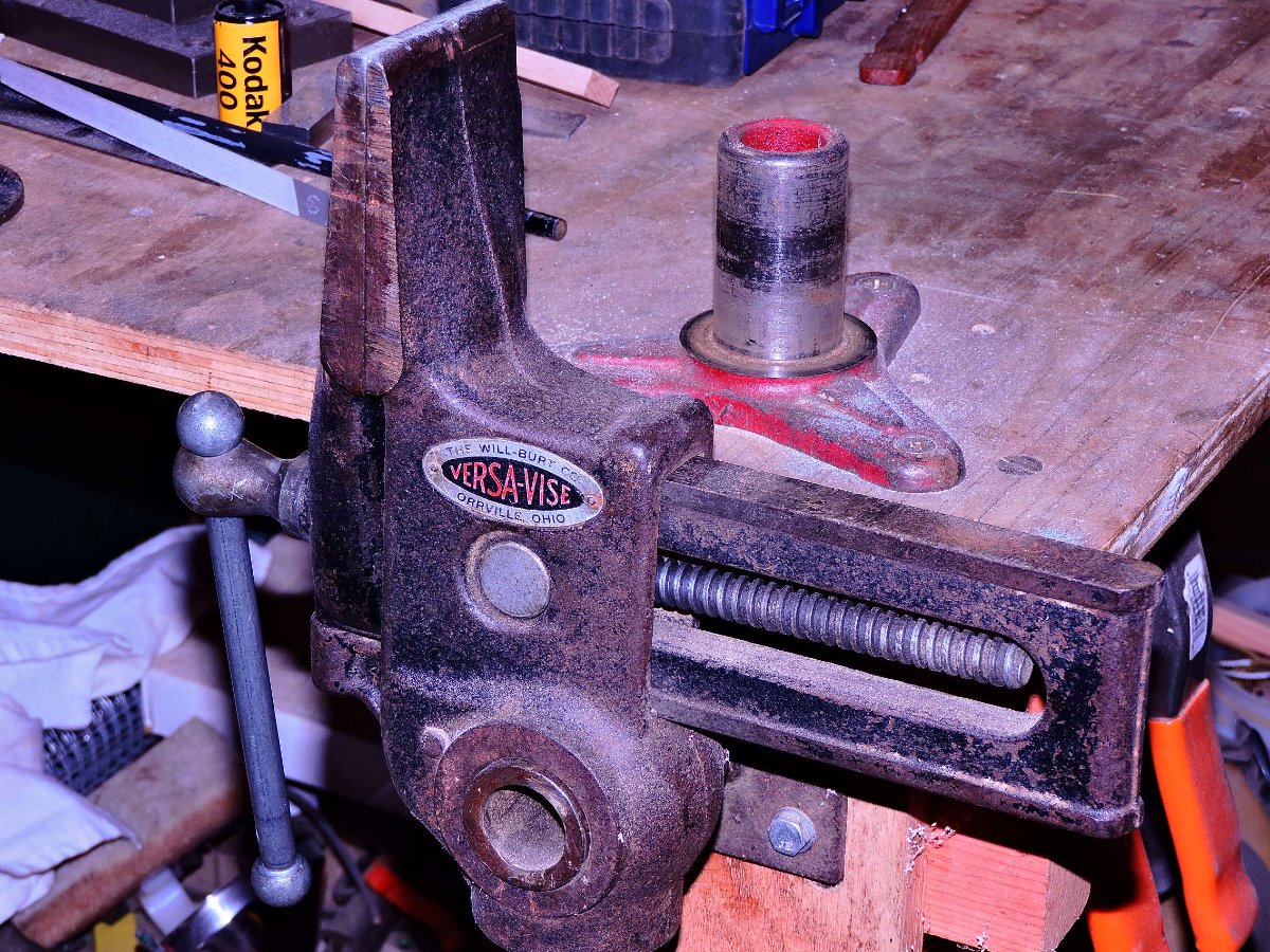

Look at the "Versa Vise", it also swivels and can be rotated up or down on the vertical axis. Wood River Universal Vise is a clone and cheaper. They have steel jaws but you can use brass or aluminum angle iron cut to size as liners. You can easily make plastic liners too. The Versa Vise is much more expensive than the Fasmov, but many times stronger.

I use 2 types of vises. I have a standard Craftsman (I think) bench mounted vice for rough stuff. For fine work like filing bolsters and such, I use a Panavise similar to that shown above. I have that clamped to a section of 2 x 4, and when I need it, I clamp the 2 x 4 in the bench vise.

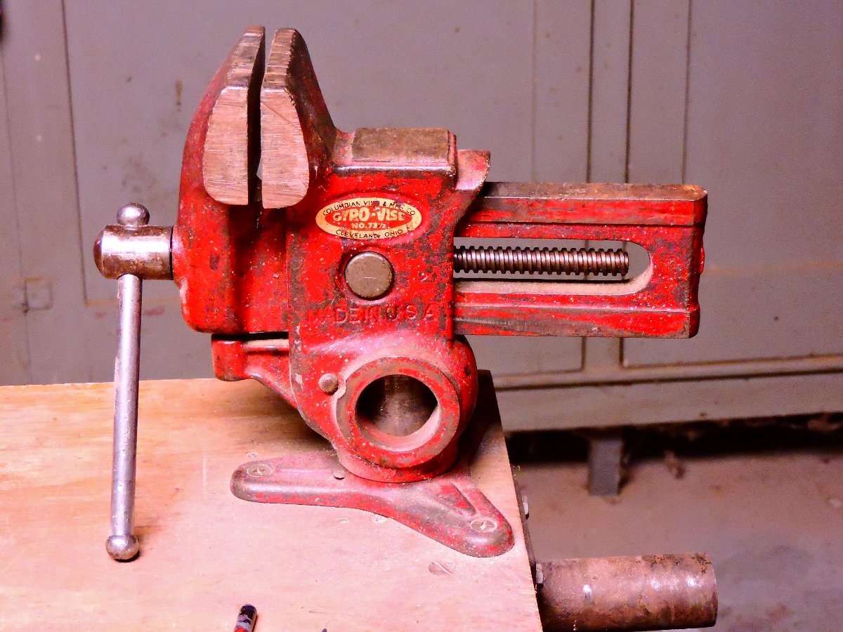

The Versa Vice does not disappoint.
One for metal work; One for woodwork. Life is good.

Nice Joe!! I didn't know they made a woodworker's model. I have the red metal worker's vise like you show, have had it for over forty years, great tool. I mount a jewelers bracelet mandrel in it sometimes and bang hard on the mandrel, never had a problem with it.

Joe, I see yours says Gyro Vise, the sticker is gone from mine but it did say Versa Vise. If you google Versa Vise they do show red metal workers vises that do say Versa Vise. Maybe at one time they used Gyro, I don't know. Regardless of the name on them they are fantastic workshop items, and the originals are USA made.

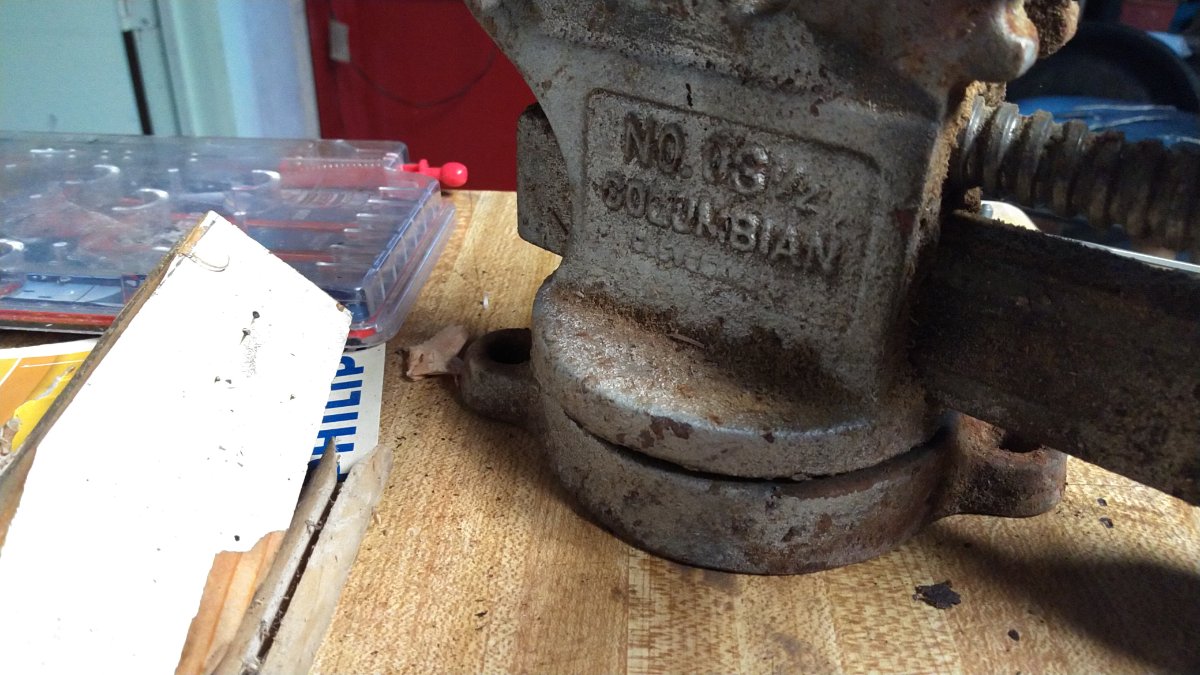

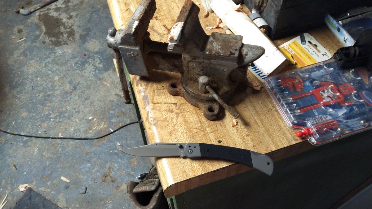

I may have found one that will do. I didn't know existed, and was here all along. In a back room in the basement (originally a coal storage area; from the '50s when the house was built through the 1970s when my folks installed the current oil furnace). I was looking for something else, and saw it in a bucket full of rusty chain.
While not a Gyro-Vise it is made by exactly the same company. Columbian Vise Mfg. Co. of Cleveland, OH. Appears to be a lower-end handyman model; as the finish is a little crude. It is a model 03 1/2, which opens up to 3 1/2". Rusty and dirty, but I think it'll clean up quite well.
So, will this do?

You may be surprised how much you will use a vice that size! That is as good as having a stiddy.

Need some advice with tapping and drilling. One of the pads is completely missing--one screw busted off, stuck inside the jaw. The the other one has an oblong-shaped hole where the screw was, and I'm not sure if a screw can go back in there, even if re-tapped. The other still has the pads, but if I'm replacing one, I might as well replace the other. And the head is worn/rusted away on both screws.

You would be surprised how many broken screws that I have gotten out with an icepick and a small hammer Catch a broken edge with the icepick, and tap the back of it lightly With the hammer until it starts turning.
It that does not work, drill out the broken screw and the oblong hole to a larger size, tap, and use larger bolts.
