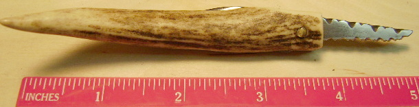

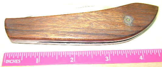

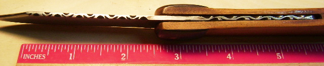

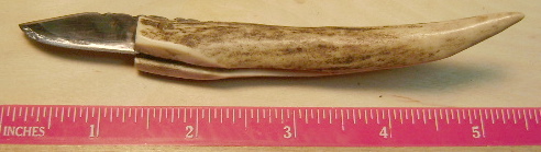

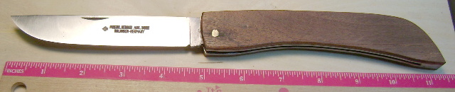

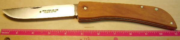

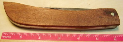

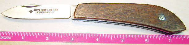

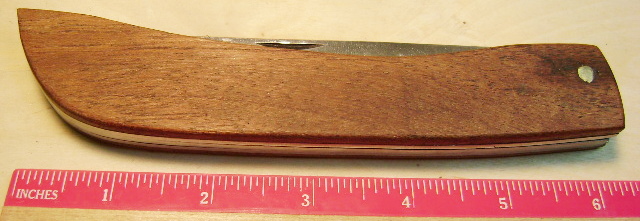

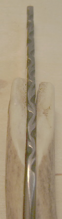

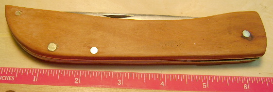

I heard this phrase ( make the knife you carry) the other day and it kinda changed what i was thinking about making a folder. Even not making one nice enough to sell i could at least carry it and use it or give one to a friend. I like trying.
All these knifeblades, except the friction folders, are premade. I can buy the solgin blades for $1-$2 each. The first folder i finished, looked good and i told my wife it even works like a real knife. I have trouble with the springs. The two larger knives were a little harder on making the springs. One is tight and the other is a little loose. One i used scraps; steel for the liner and walnut. The last large folder has brass liners and peruvian alder handles. I hope the pics are decent. I also tried my hand at file work.
I bought my grandaughters a tackle box with fishing stuff in it for Christmas. I made each one a fixed blade for the tackle box.
Use what you make and make what you use. Thanks for looking.

Excellent creations Brent. I really like the mosaic pin inset on the first one.
Why don't you tell us about your spring making adventures? I'm sure somebody will have a tip or two to offer you.
