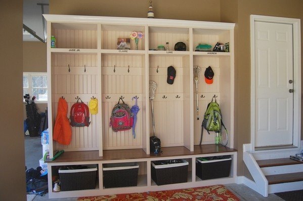

A coworker of mine asked me for help with a project. Mainly cause I've got a bunch of tools. Surely not for woodworking knowledge, haha.
Anyway, he wants to build a unit so his kids have a place to hang backpacks, put shoes, hang jackets, etc. when they come inside. Almost like an open locker with a place for a bin underneath, similar to this...
We'll use reclaimed pallet wood for the rear panels.
He is planning on painting the unit, so the wood does not have to be anything amazing. I was thinking of using furniture grade plywood like they sell at Lowes or Home Depot for the large parts, and regular wood like pine or maple for the trims. Any ideas, thoughts, concerns?
Thanks in advance!

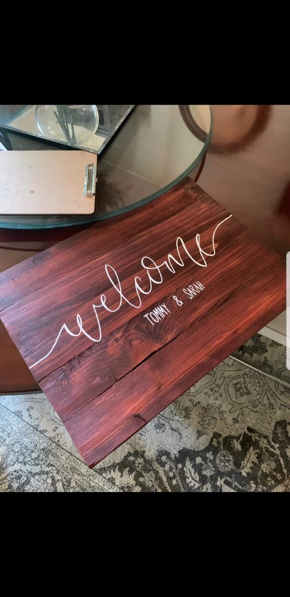

As to the pallet woes, I've been down that road. A couple years back, a few of us guys from work got together and made a bunch of American flag wallhangers from pallet wood. It was brutal taking them apart.

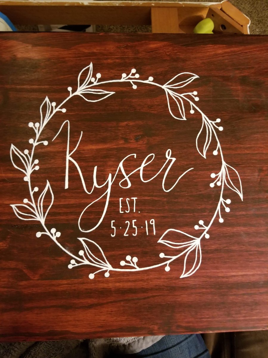

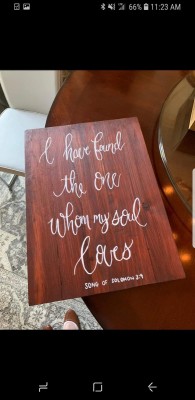

I would echo the difficulty of working with pallets. My daughter wanted some wooden signs made from pallet wood to use at her wedding a couple of years ago. She is an artist and painted them. It was hard to find good usable wood - lots of cracks and knots and soft spots. I wound up having to glue everything as the wood was so soft it wouldn't hold screws. Lots of planing to get the correct thickness (I have a Delta 12 inch planer.) And I was picking splinters out of my hands for weeks afterward.
While the signs did eventually turn out really nice, and were inexpensive, working with the pallet wood was a big PITA.

I wasn't too happy with the results, but then my daughter did her magic on them and made them look nice. She was on a budget for her wedding, as her dad is a tightwad. :lol:

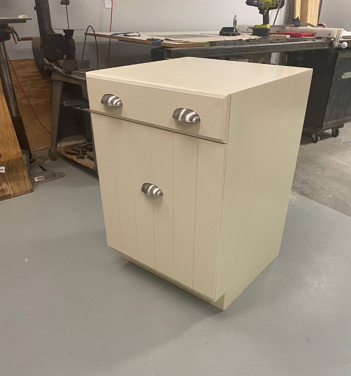

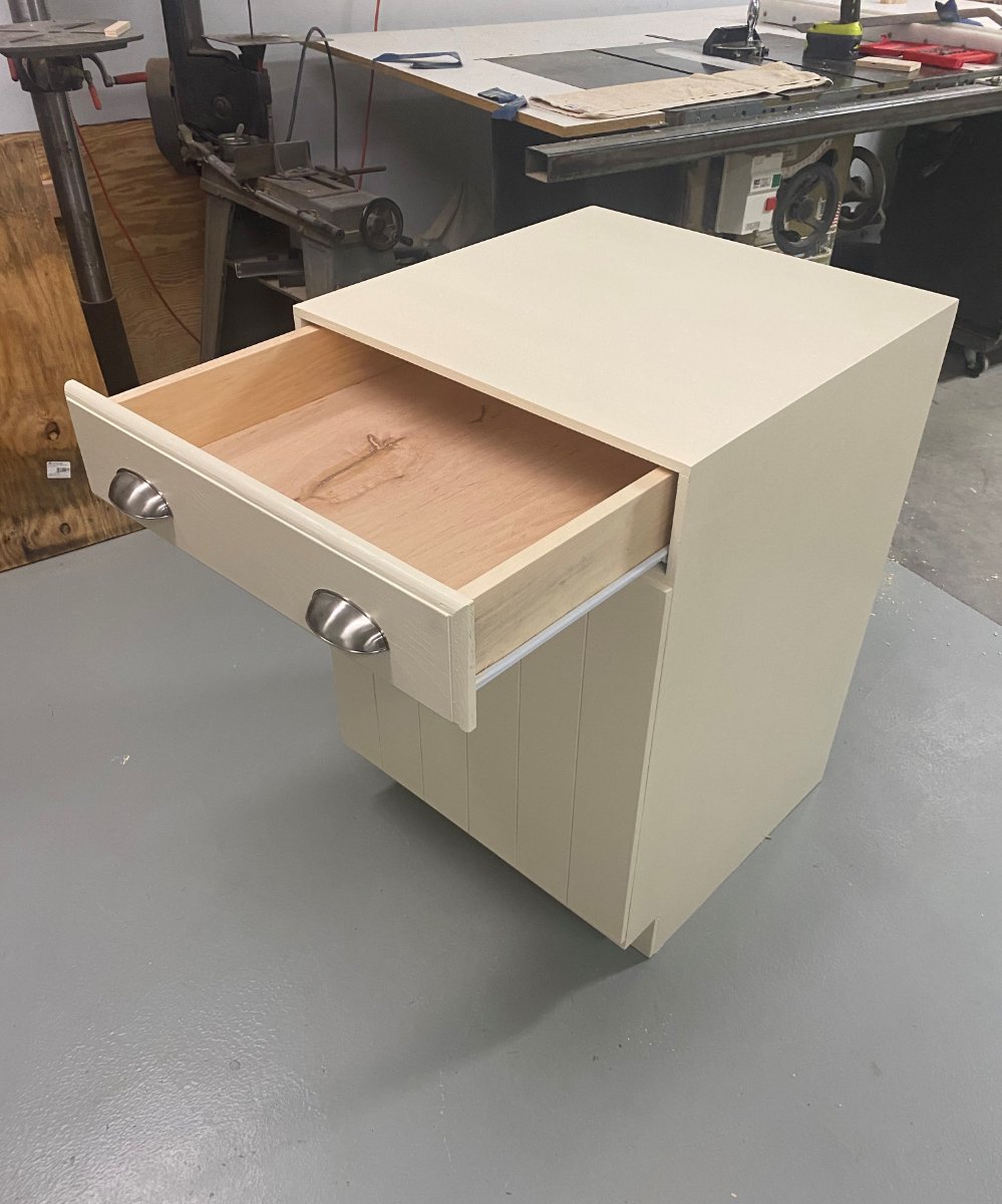

Veneered plywood is a good option but it isn't cheap by any means. I recently made this trash can cabinet for a friend using maple veneered plywood. Was easy enough to paint over without much sanding at all.

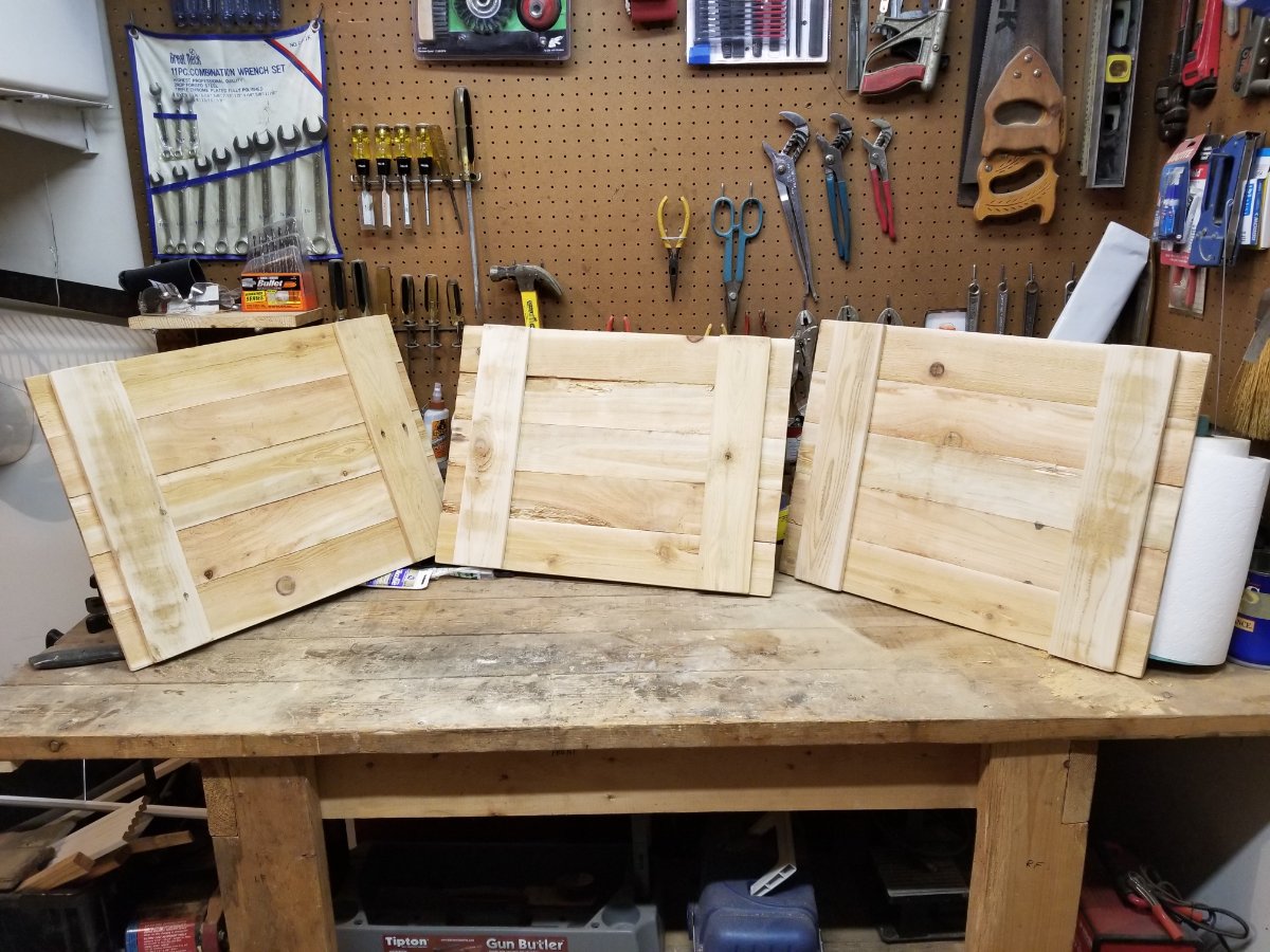

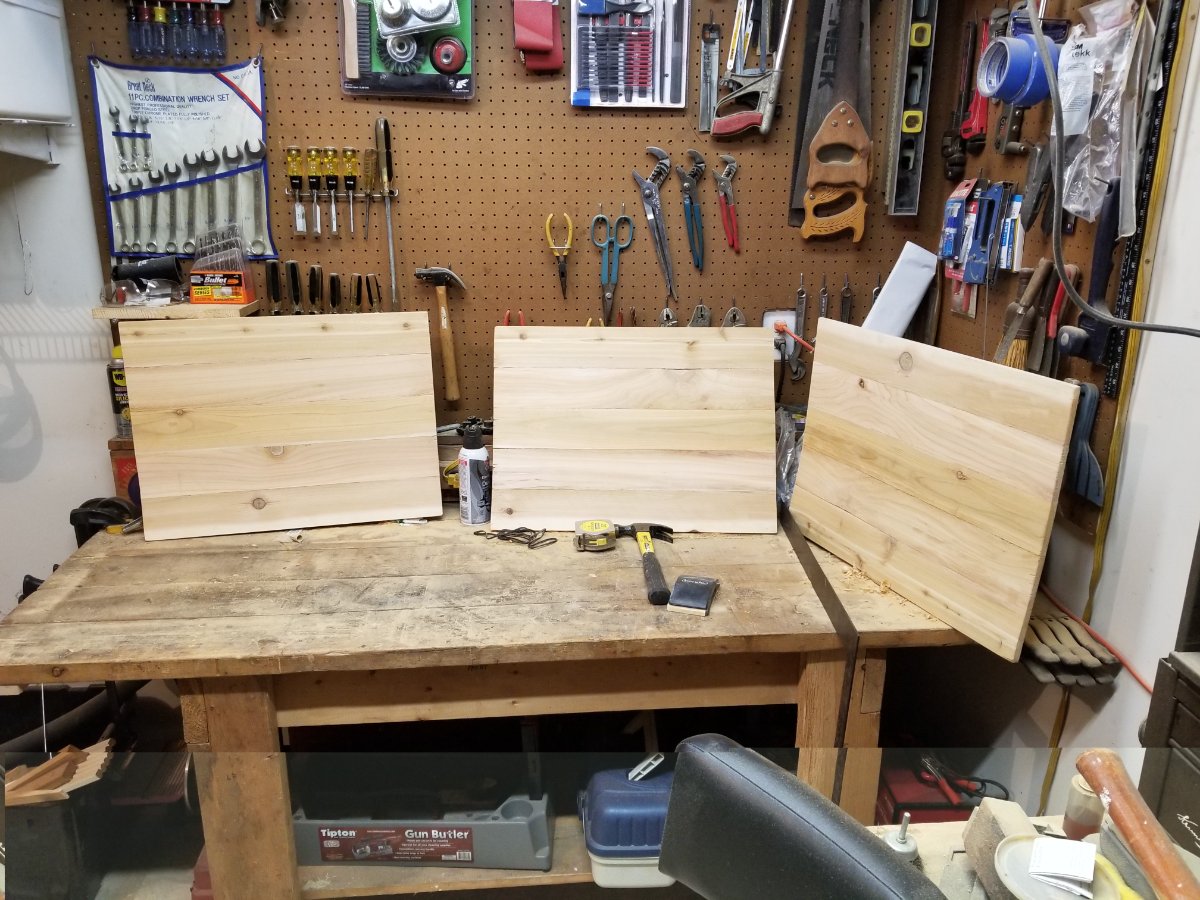

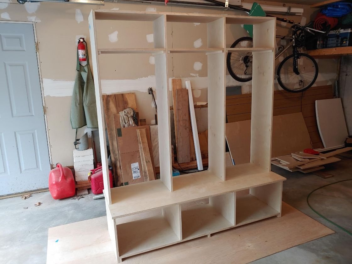

Well, we finally got started on this project. My co-worker opted to go with the blondewood plywood. I wasn't too keen on it, as the veneer seemed a little thin and fragile, but he will be painting everything, so whatever. Anyway, we got about 5 hours into it so far, this is what we have done on it.
We got the poplar hardwood for the edging/molding. I'll get that all ripped and ready once we are ready to install it. We'll install the palletwood backing last.

Looks Good Glenn!! 👍💎👍

Looks good, Glenn. It looks accurate which puts you miles ahead as you must know.
I agree with Dan, working with reclaimed anything can cause you a lot of work you would rather not be doing.
By the way, that red gas can on the left looks like it could use a venting. ::woot::

Looks great Glen!

I think that's an optical illusion (but I'll check it to be sure, thanks!)
