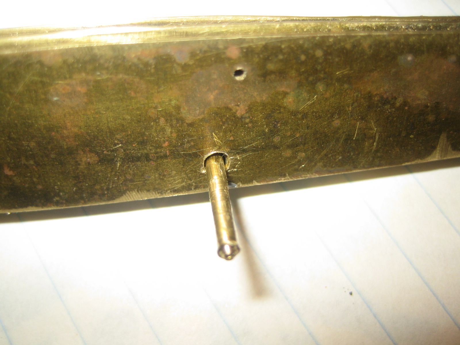

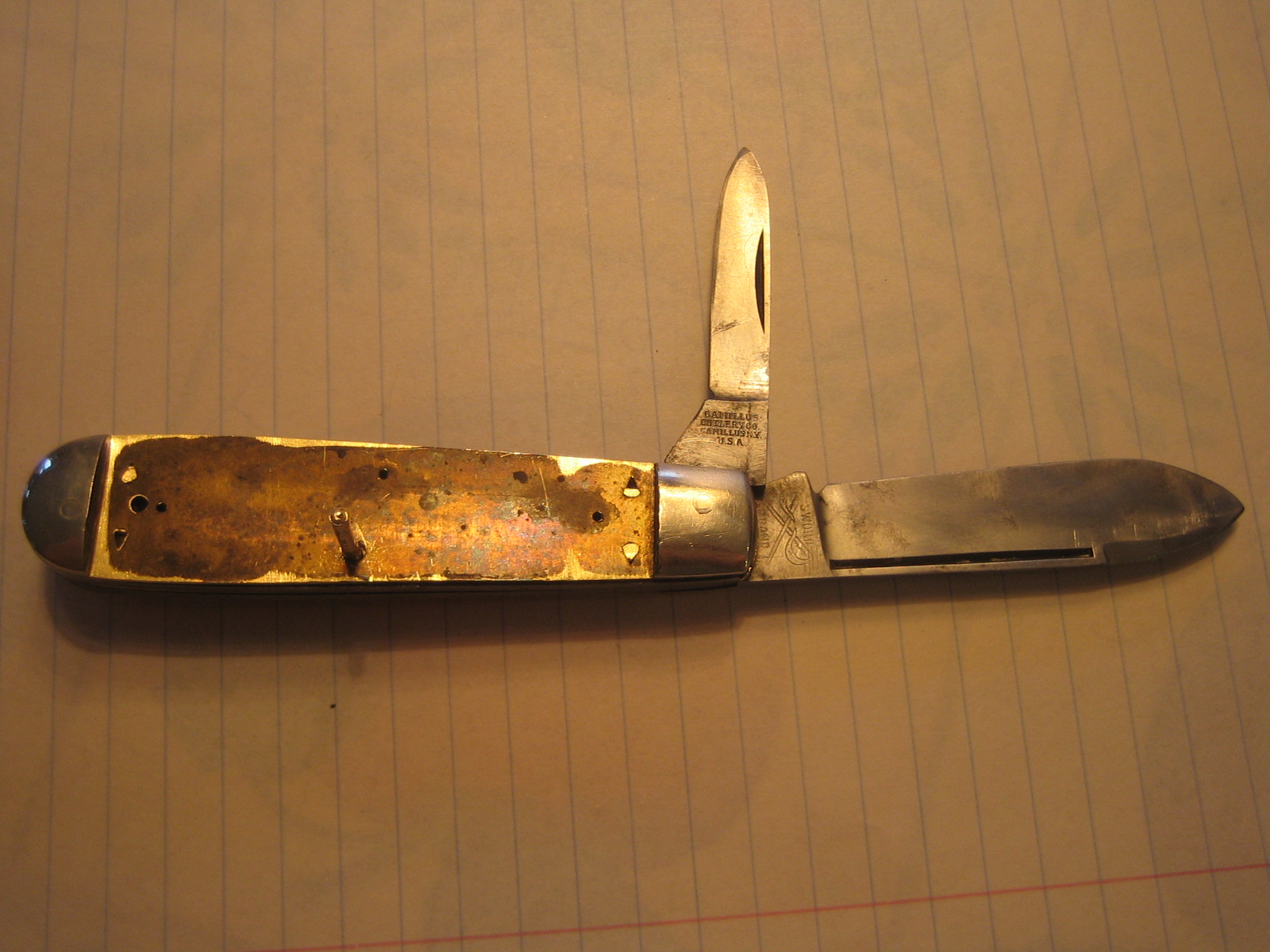

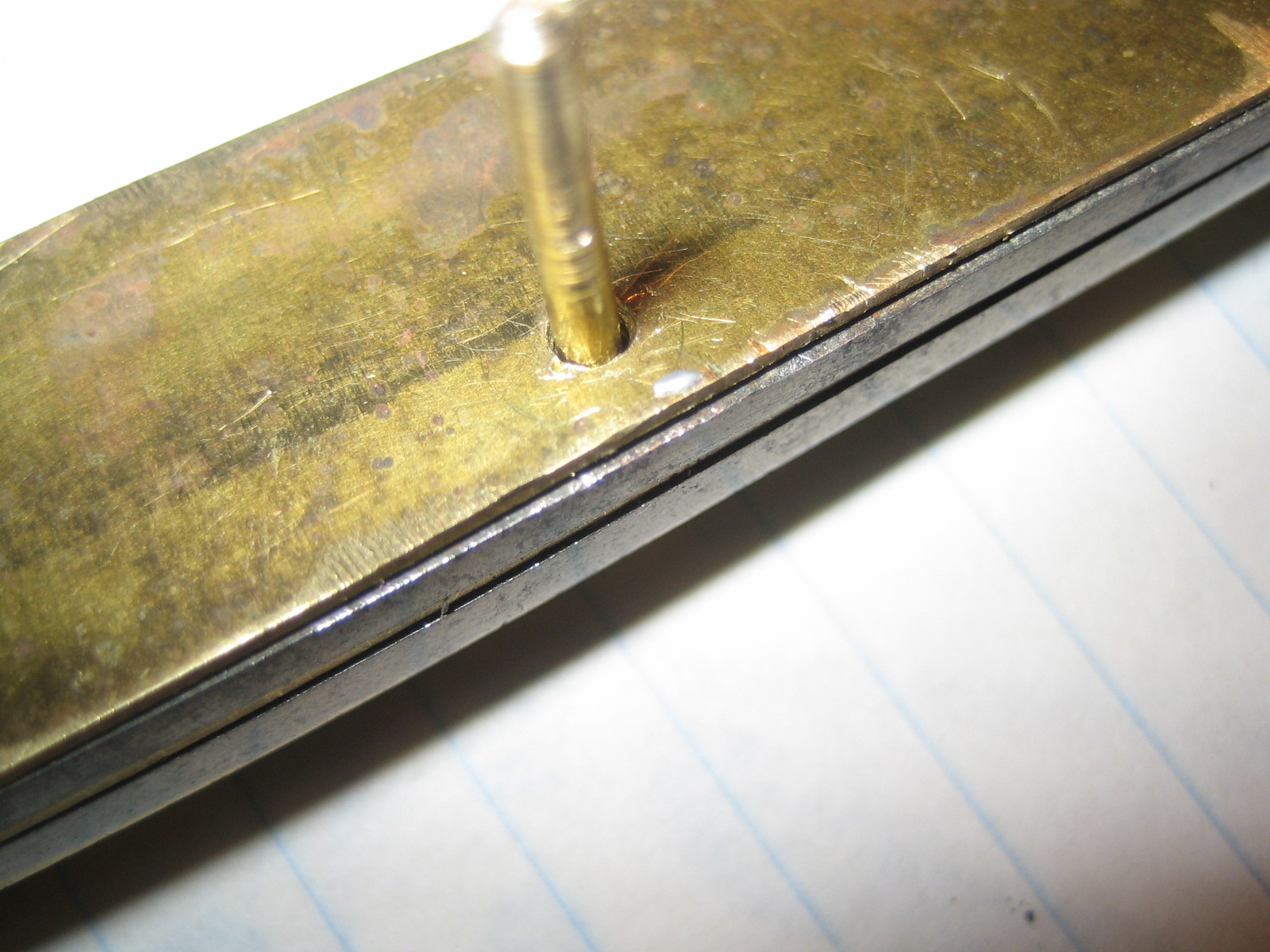

The scales were loose and chipped on this Camillus Sword Brand folder and I thought I'd replace them with antler. I popped the plastic scales off but mangled the rocker pin a little and the brass liner was pulling away from the spring. So I decided to replace the rocker pin....... Couldn't find a proper sized punch so I drilled it out and consequently enlarged the hole in the brass liner a little. See pictures.
Anyway, I've managed to replace the brass pin but small blade has a very weak snap while the big blade is somewhat better. Also the small blade goes too far in the liners so I can't reach the fingernail notch. The springs protrude slightly beyond the brass liners indicating to me that they need to be brought in line. If I solder around the hole while the knife is in a vise will the solder be strong enough to hold? Any other suggestions to improve the weak snap?

Forced in a bigger pin and it cured everything! It's amazing what a slight adjustment will do! Monster snap on both blades! I'm going to epoxy on some antler scales next....
