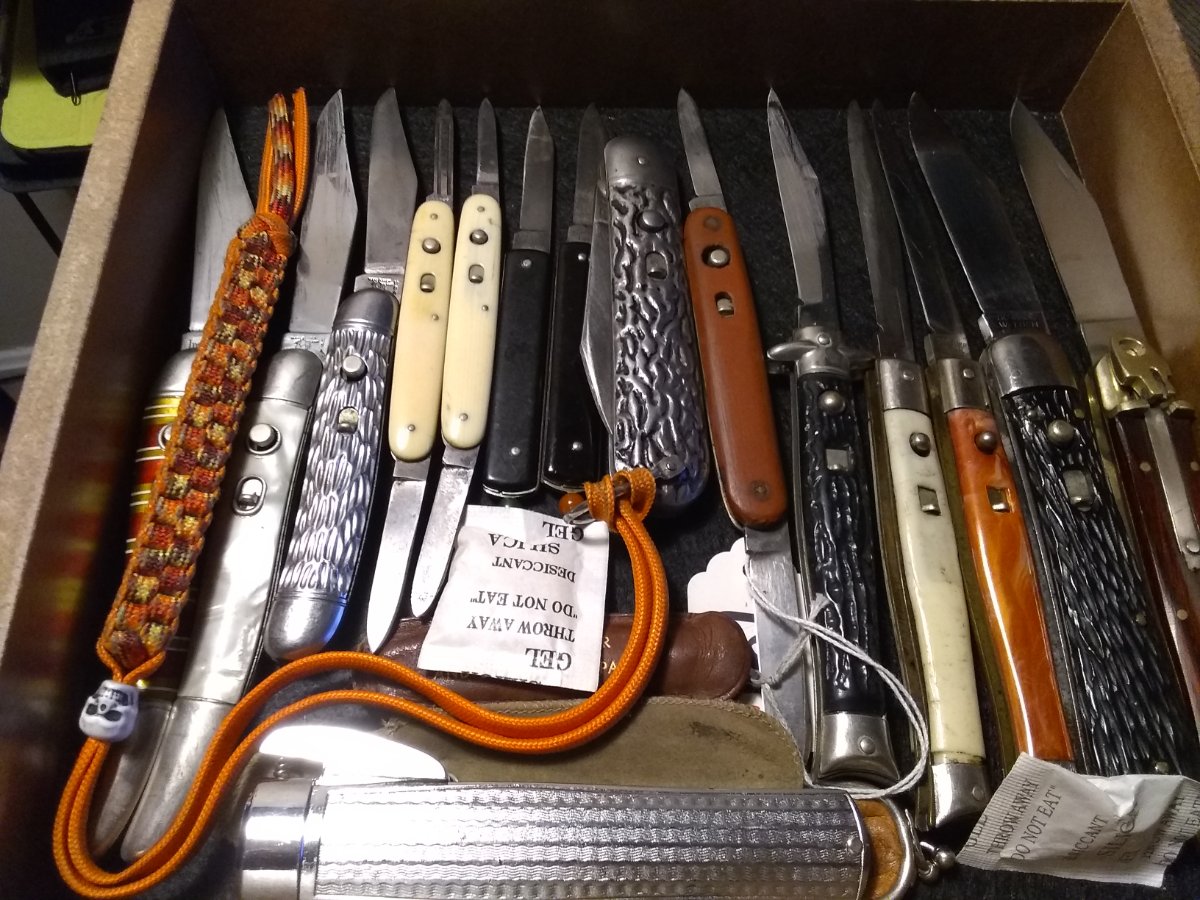

I store all of my old autos open, new or OTF I don't. Nor do I relieve the springs on OTF knives, but it is easily done. The closed Presto had a broken spring and I "fixed" it by jamming a specifically sized piece of spring steel under what was left of the broken piece, so I'm not worried about it.
Just my 2¢.
Just my 2¢.

Very cool little group John!1967redrider wrote: ↑Thu Aug 26, 2021 11:40 pm I store all of my old autos open, new or OTF I don't. Nor do I relieve the springs on OTF knives, but it is easily done. The closed Presto had a broken spring and I "fixed" it by jamming a specifically sized piece of spring steel under what was left of the broken piece, so I'm not worried about it.
Just my 2¢.![]()

Madmarco wrote: ↑Fri Aug 27, 2021 2:35 pmVery cool little group John!1967redrider wrote: ↑Thu Aug 26, 2021 11:40 pm I store all of my old autos open, new or OTF I don't. Nor do I relieve the springs on OTF knives, but it is easily done. The closed Presto had a broken spring and I "fixed" it by jamming a specifically sized piece of spring steel under what was left of the broken piece, so I'm not worried about it.
Just my 2¢.![]()
Thanks, Mark. I figure better safe than sorry.
