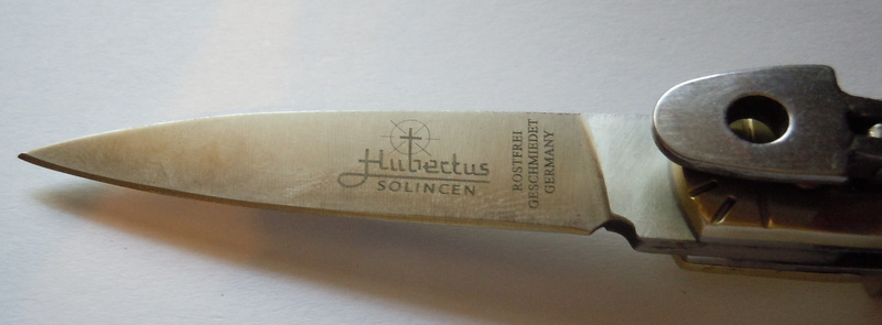

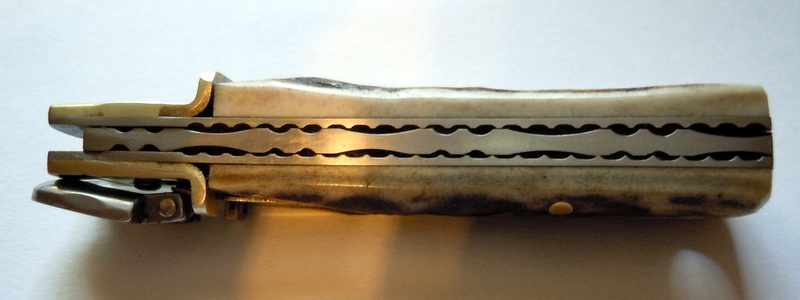

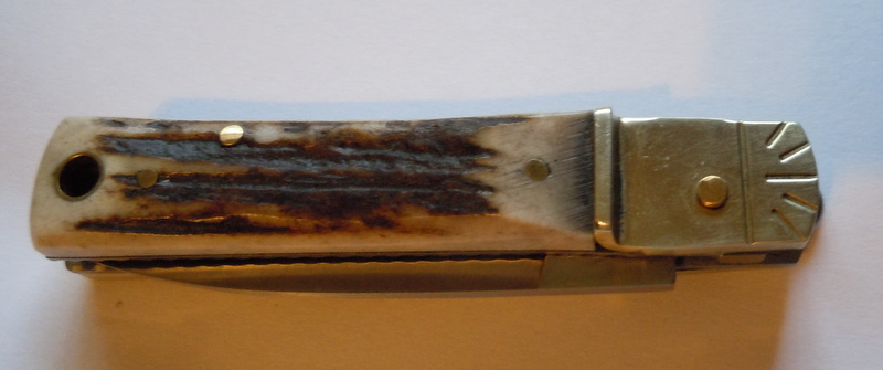

Here is a nice Hubectus a while back from Ebay. I knew when I bought it that it was not real, but at $8.00, I was willing to take a closer look at it. It is actually a pretty well made fake, not good German made fake, but good for a Chinese made fake. The seller was clever and didn't call out the brand name but gave just enough closeup of the logo to draw in the unsuspecting. As you can see, with better photos than the listing, showed it is pretty clear that it is a long way from the real deal.

Hey Maddog! For future reference, you can usually spot a cloned leverlock by the screw in the metal plate that runs down the front handle of the knife. On the genuine article they have a fixed rivet, not a screw. Also, the letter that you think is a "c" is actually the same "r" that Hubertus uses, it's just that the underlining on the fake is lower down from the letters than on a genuine Hubertus, so it appears to be a "c". Great knife for "click therapy"! 8)

I'm glad you did post. I didn't know about the screw and rivet.

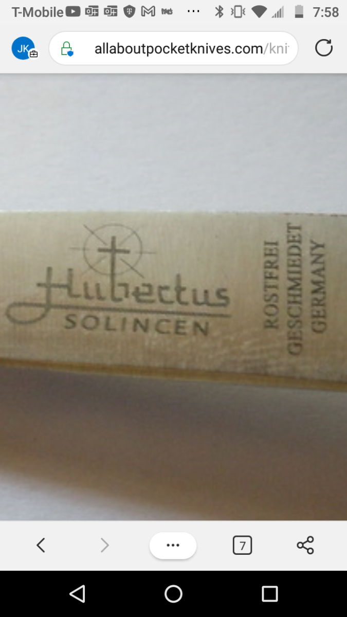

I learned something too, Mark. ::handshake:: As plain as the . . . well . . . you know whats on a Tom cat. ::sotb::

Glad to help John. I too thought the "r" was a "c" until I saw it on what I knew for sure was a genuine Hubertus, and read the information describing the 2 stamps. 8)

Looks like there's a "c" in "Solingen" too. ::nod::

Wow, it sure does! ::nod:: Never noticed that before. 8)
