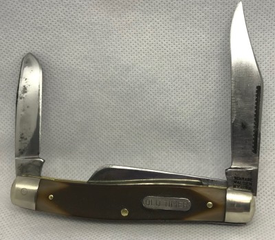

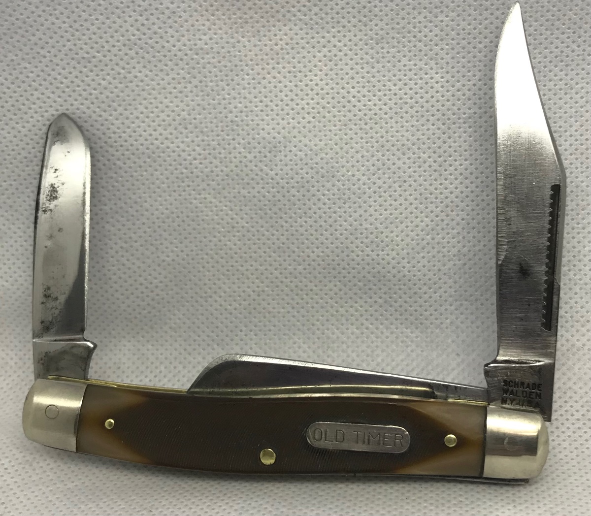

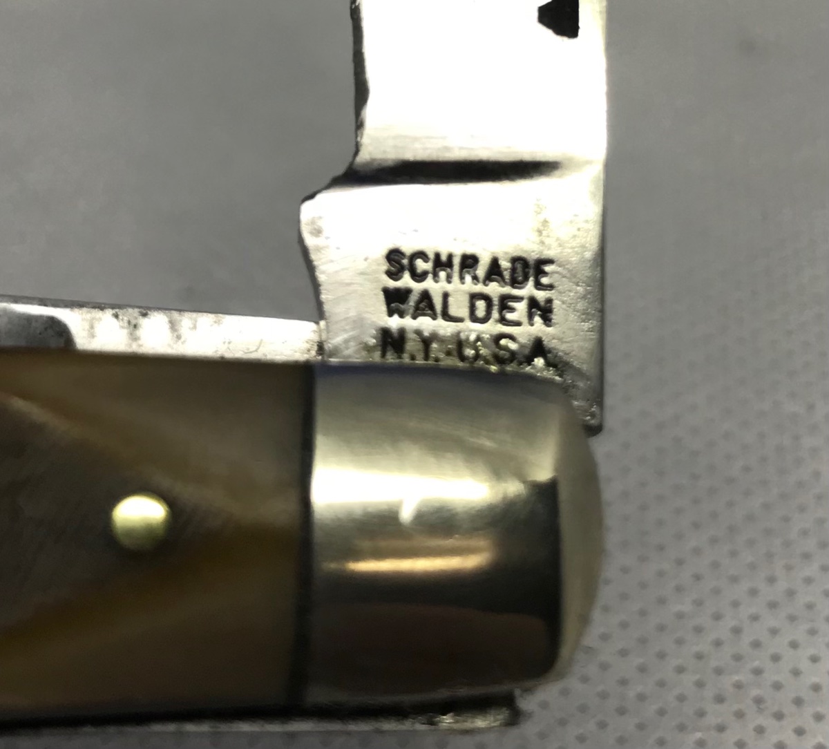

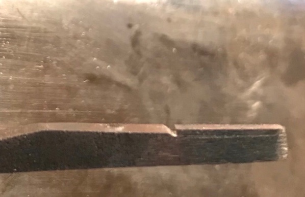

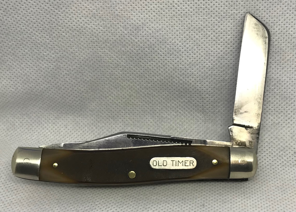

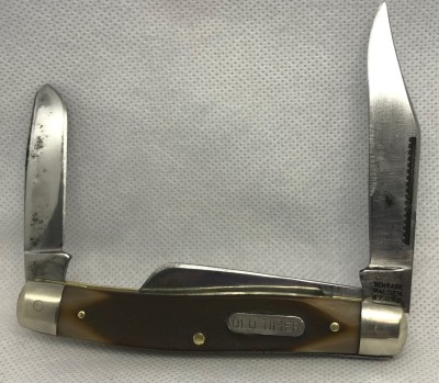

I got a chance to repair this Scrade Walden 8OT today, just in time to give it to my brother for his birthday on Monday.
I forgot to take a "before" picture, but all of the blades were intact, just rusted and worn. It would have only needed a cleaning, had the tang not been worn out on the Main.
I used the method that Olde Cutler showed a week or two ago to "move the hole"!

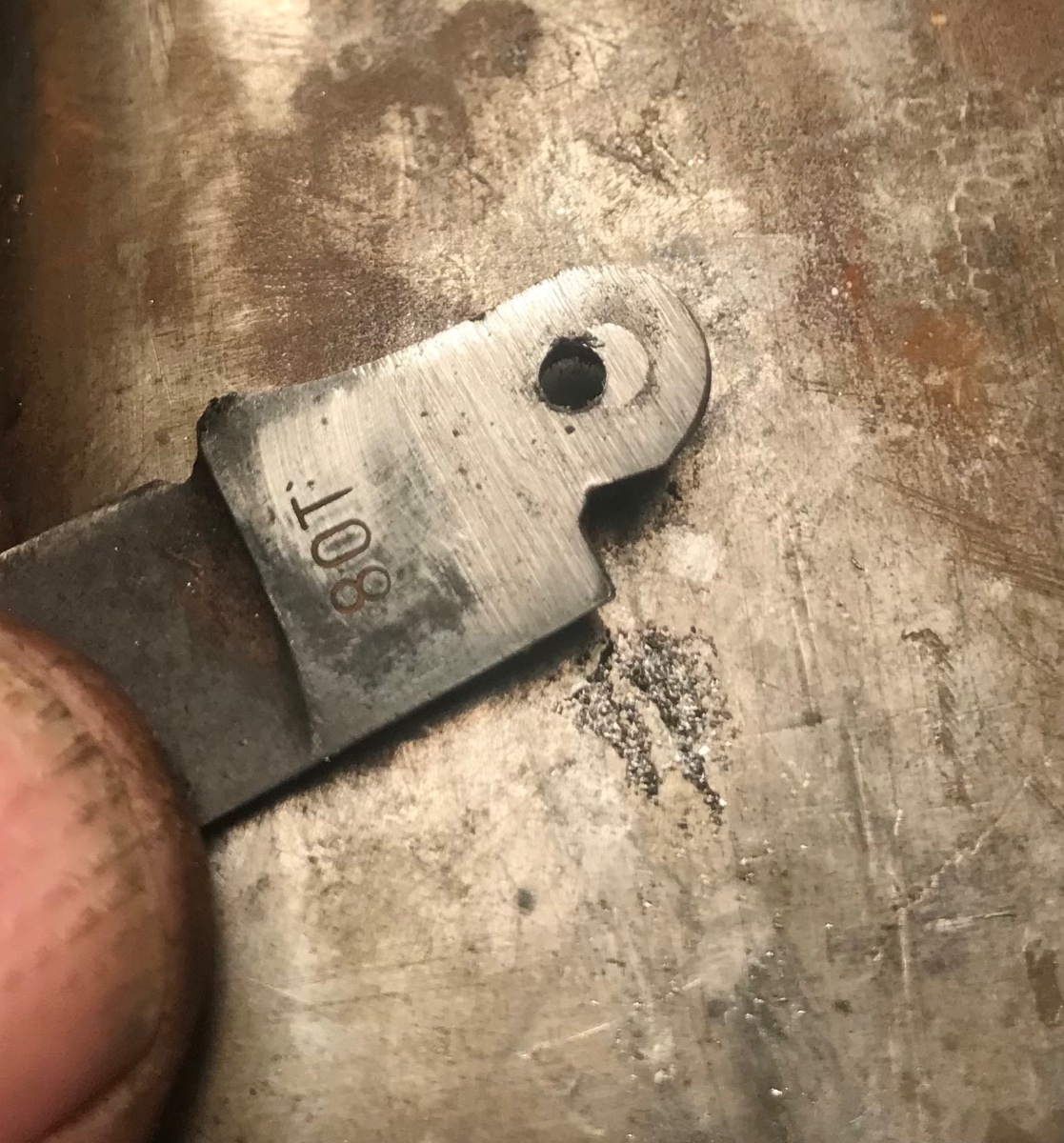

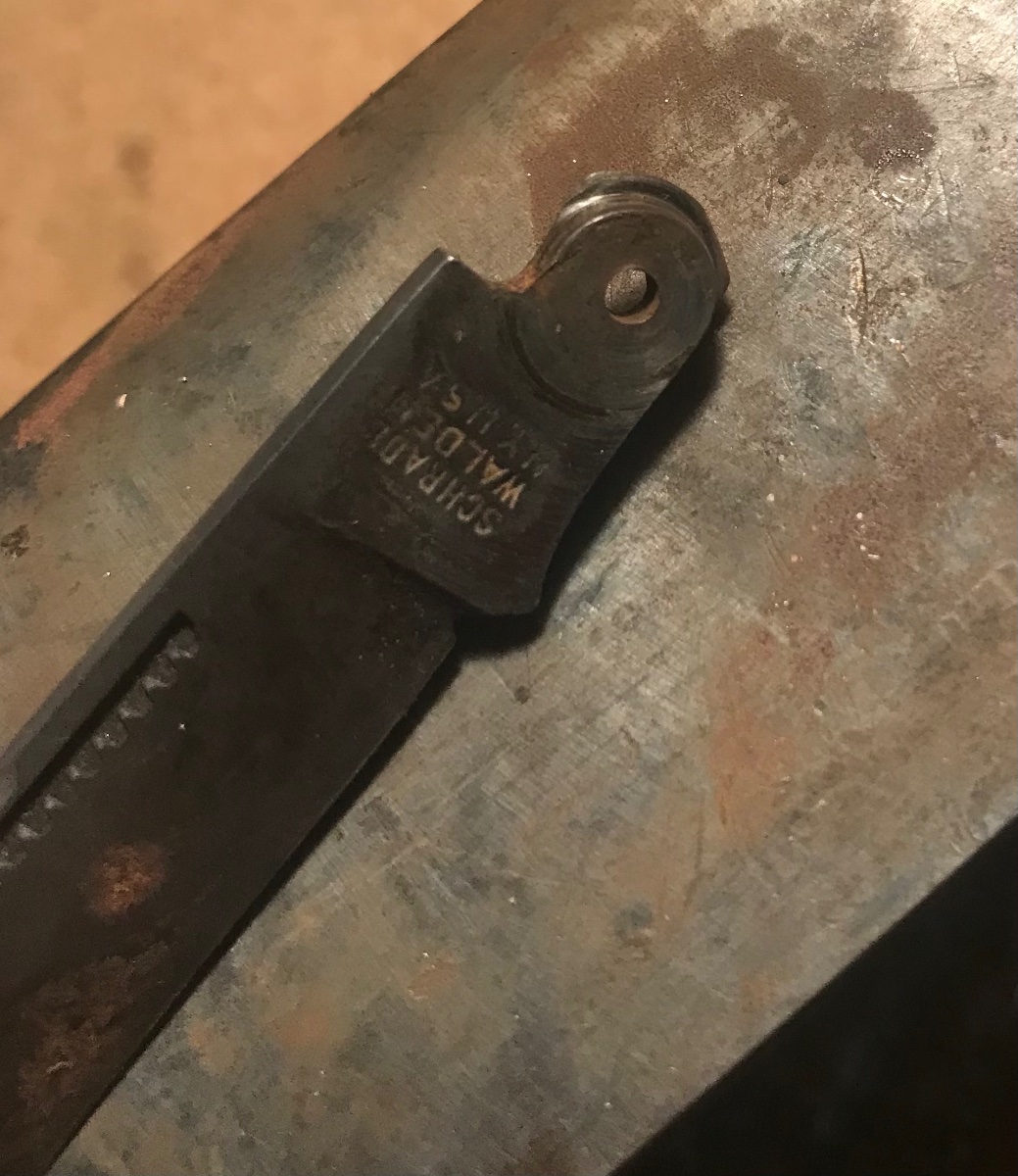

I peened a nail to fill the hole in the blade, and ground off the "halo" and smoothed the tang.

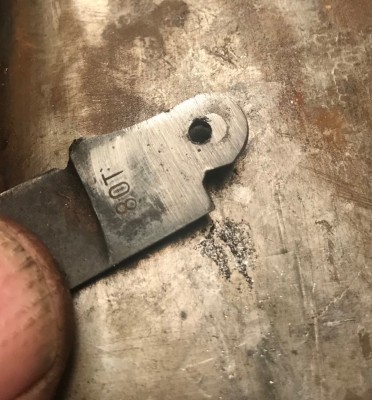

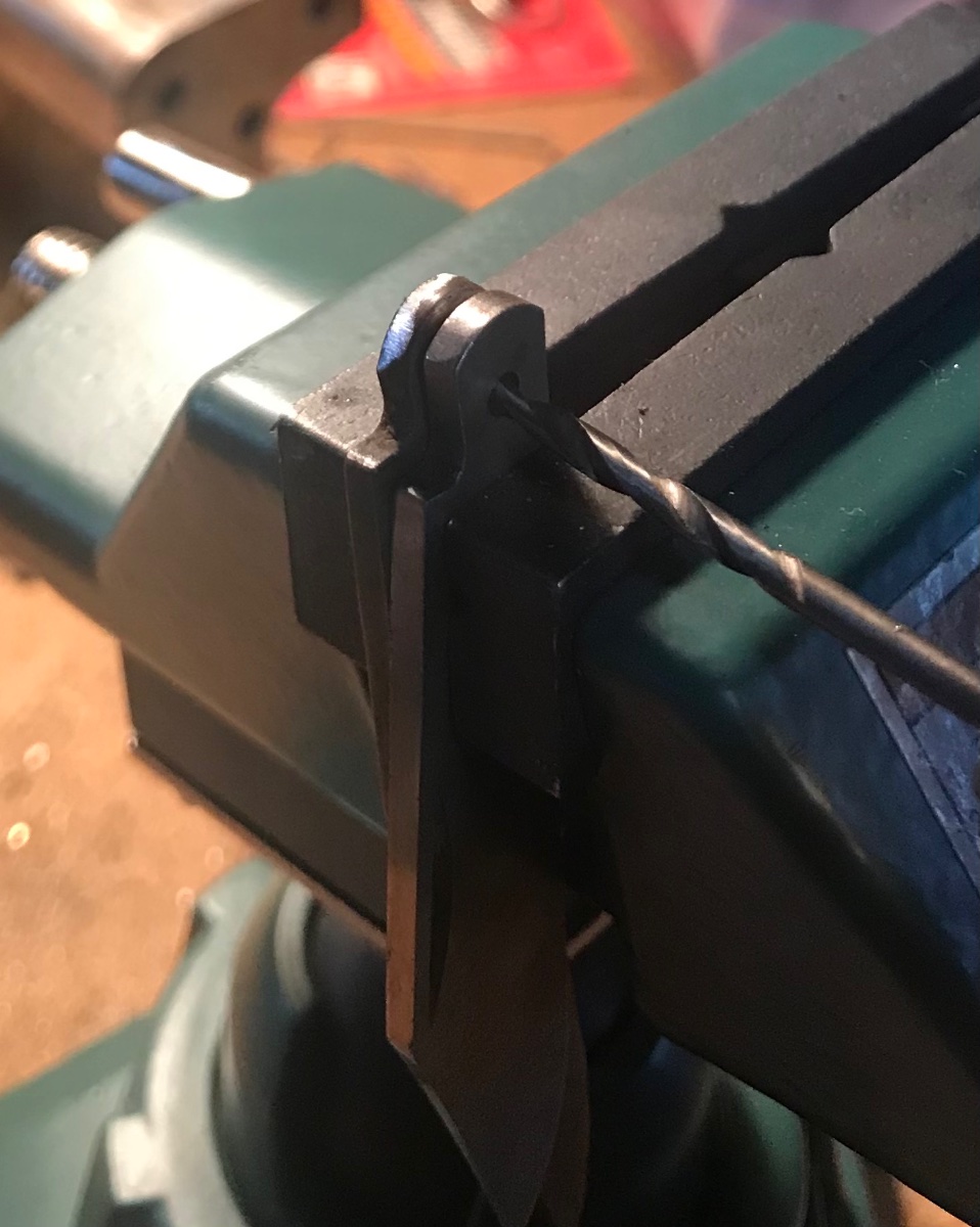

Then I clamped it up against a new Schrade blade to drill the hole and reprofile the back "shoulder" (where it sits against the spring when open).
Then I ground the divot out of the spring, and soldered a piece of hacksaw blade in place to build it back up again.
It now has great walk and talk!
I did not buff out all of the pitting, but still took it further than I normally do, since this is a gift. After cleaning, oiling, and sharpening this knife, it is one that I can be proud of.

I had a friend who was a knife mechanic, and a few years back he showed me some similar repairs. He would plug the hole with Silver solder, and his repairs lasted for years.
The solder that I have is too soft for that. I had tried peening in brass before, but it would not stay in place. I had not thought of peening steel until OC showed his method, and I was excited to try it.
I did not take pictures of the process on my Camillus Tip Top barlow, but I did the same tang repair and it also worked great. I clamped the donor blade against the original broken-off tang and matched it fairly well. It now has alligator snap!
I peened the steel repeatedly on both sides, and it is solidly in place. Even when drilling through the edge of it. I don't really expect it to wear much differently than an original blade, but I will update everyone!
