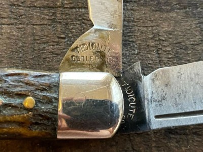

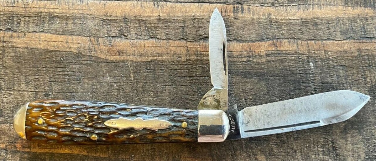

Here is a knife that is bringing in some big bids on the bay. This knife looks to me to have all the characteristics of what we have called a Myrtlefaye, or Myrtlefake special. Named so for one of eBay's most prolific sellers of bad knives from the past.
The first thing I notice here is that the master blade doesn't open to a close to 180-degree flat plane when open. A bad sign.
Looking at the knife with the blades closed it appears to me that the master blade tip will fall far short of the rear bolster. A knife with blades this full should have the master tip reach to and beyond the rear bolster when closed. I doubt the master blade tip would reach the position of the rear handle pin when closed. Not there is no "blades in the well" picture that shows the blade tips when the knife is closed. This for me is one of the most, if not the most important picture needed to evaluate an old knife.

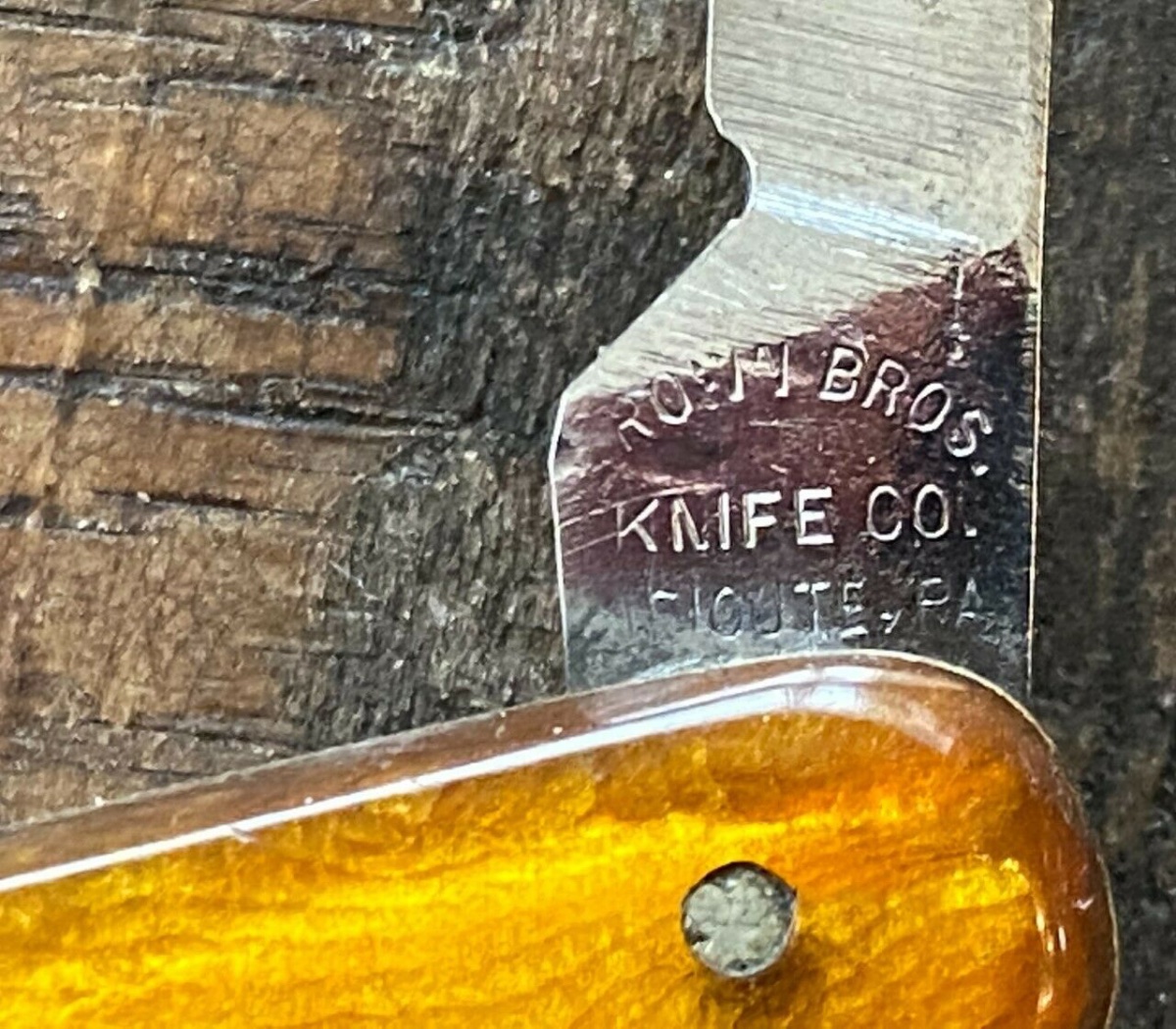

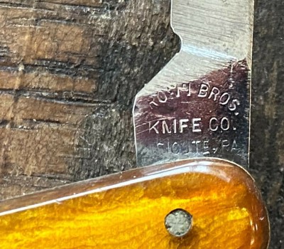

Looking at the close up of the blade stamps it looks to me that there could have been some welding going on.
All in all, this knife doesn't add up for me. Looks like there are enough bidders that like it though.
Other observations and comments welcomed.

That master blade appears to be a good 1/2" short of reaching the bottom pin!
Thank you for your very informative description of what's wrong with that knife Wayne,
I jus' wish everyone was so descriptive!

Thanks Wayne. The same seller has another knife listed, also having the same peculiar looking grind marks on the tang shoulder just above the stamp. I agree this could be indicative of welding to “fix” a broken blade. The weld was possibly put to a grind wheel to remove evidence of welding. JMO

I think you guys have this knife figured out. What I don’t get is if you are going to weld another blade to the tang, why not one that is long enough. Harold
