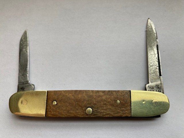

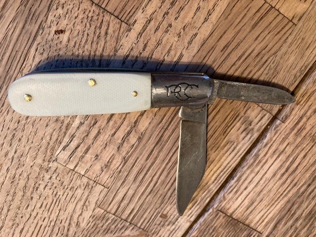

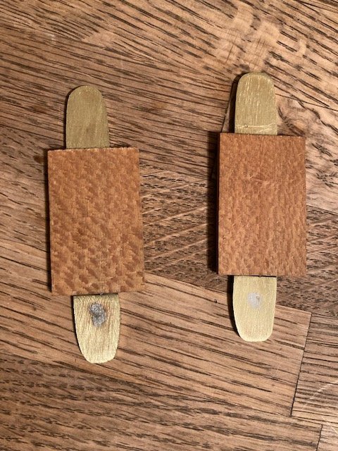

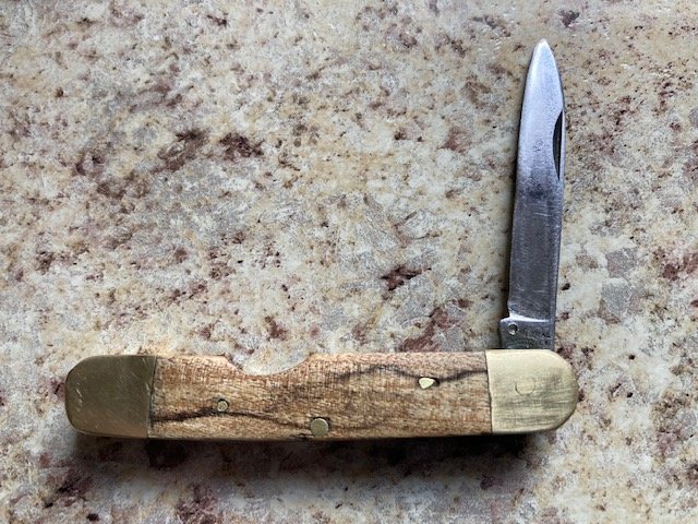

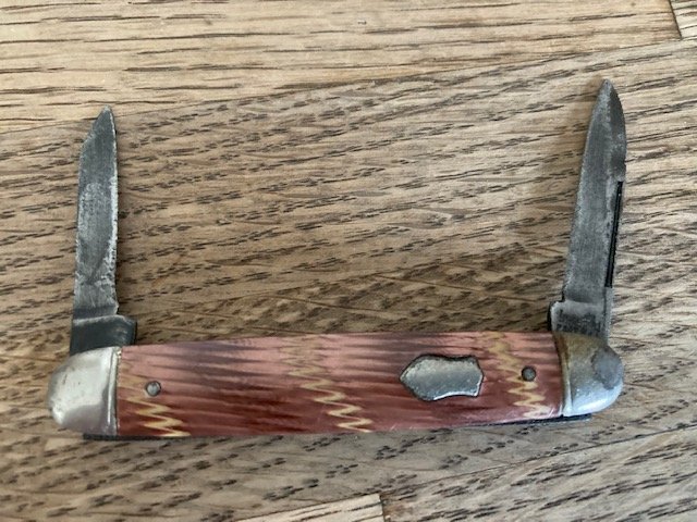

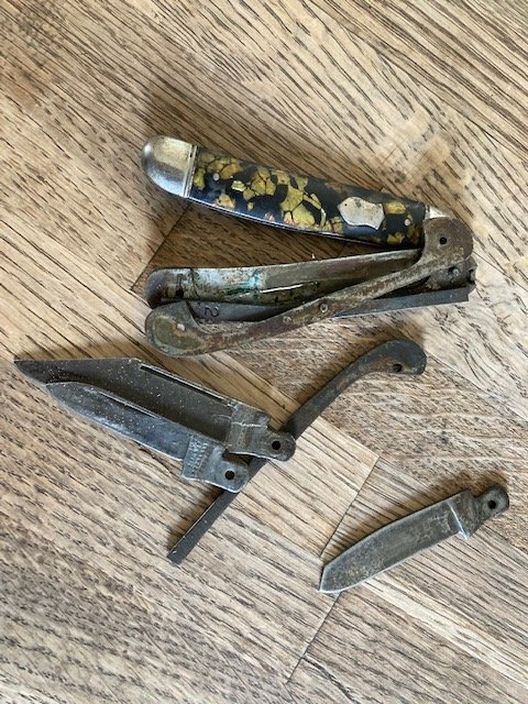

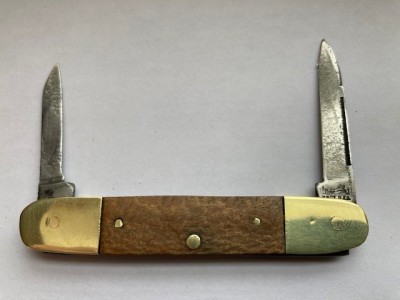

Here is one of the knives Jeff sent me to learn. I must say he sent me a lot of different knives to work and learn on. I would like to thank Jeff publicly for his kind offer to help me learn. ::handshake::
It is a two bladed Imperial shell handled knife.
#1 Removed old handles.
#2 I thought I would get rid of the shell handles so I soldered on some brass to make bolsters.
#3 I them shaped the bolsters to match the inner scales.
#4 I then drilled the old inner scales so I could pin on new scales.
#5 I had some cherry wood I used to make scales.
#6 I cleaned up the blades best I could and sander the rust off the spring and liners.
#7 I added a little bend to the spring to get some snap out of the blades.
#8 I assembled the knife and sanded to clean it up.
Here are some pictures.
Nev

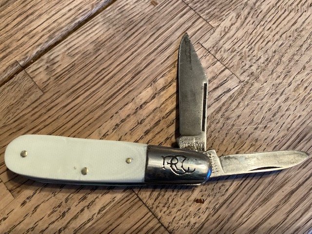

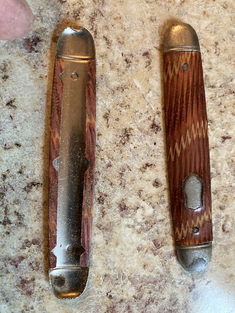

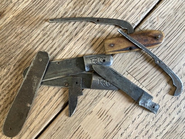

One more Knife.
Jeff sent me a box of beater knives to work and learn on. I took a old Robeson Barlow and a Imperial stockman and made one knife. It was a small challenge. I had to modify the bolster holes and springs to work with the blades from the stockman. It took me all day but I got it done and am very happy with the finished product. I added a green G10 liner and then a white micarta scales to give it some pizazz :D Here are some pictures.
Thanks for looking
Nev

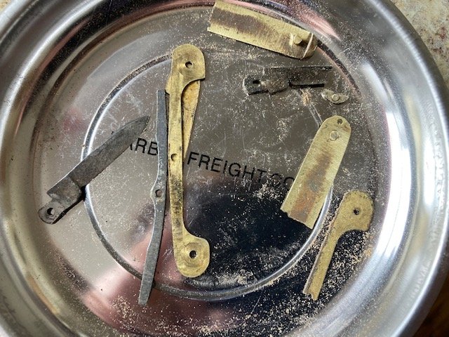

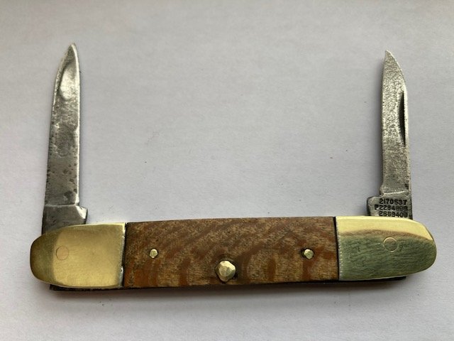

Here is one more parts knife. It was a small Imperial stockman. It had no scales a broken blade and when I took it apart the liners were broken. So, I had some brass stock laying around. Well, I made new liner new bolsters and new brass outer scales. Then I made a set of maple scales and pinned them to the brass. I took the main blade and spring and made a single blade gentleman's knife. It turned out pretty good, but one bolster is a 1/16 longer than the other.and one pin is flat. ::dang:: ::dang:: I did not notice it until I had it all together and pinned up. :oops: It really bothers me, but I am going to use it for a while. It took me almost 2 days to do this knife. So, I will wait.
Nev
