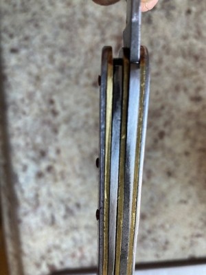

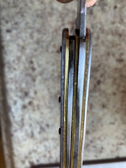

Nev52 wrote: Mon Feb 07, 2022 9:12 pm Here is one more parts knife. It was a small Imperial stockman. It had no scales a broken blade and when I took it apart the liners were broken. So, I had some brass stock laying around. Well, I made new liner new bolsters and new brass outer scales. Then I made a set of maple scales and pinned them to the brass. I took the main blade and spring and made a single blade gentleman's knife. It turned out pretty good, but one bolster is a 1/16 longer than the other.and one pin is flat. ::dang:: ::dang:: I did not notice it until I had it all together and pinned up. :oops: It really bothers me, but I am going to use it for a while. It took me almost 2 days to do this knife. So, I will wait.
Nev
I think you've been pullin' our legs Nev, ::paranoid:: are you sure you don't have prior experience with knifemaking? ::hmm:: When you can start improvising on a build because something's just not right, then there's some buried knowledge there. You're actually a pro and told us you were a novice so we'd let you stay and play with us, right? ::shrug:: LOL! Beautiful work my friend, you brought that old dead soldier back to life! 8)

Thanks' Cudgee and Marco,
No Marco no experience in knife making. It seems every knife I do. I miss something. But I am learning. I was a car and later on in Life a heavy truck mechanic. I also worked on old farm equipment. So sometimes you have to make things to get it going again. I think that's why I can think outside the box and make things. I have a long way to go to get up to the quality of work I see people do on this site. I hope one day I can get to that level.
Regards ::handshake::
Nev

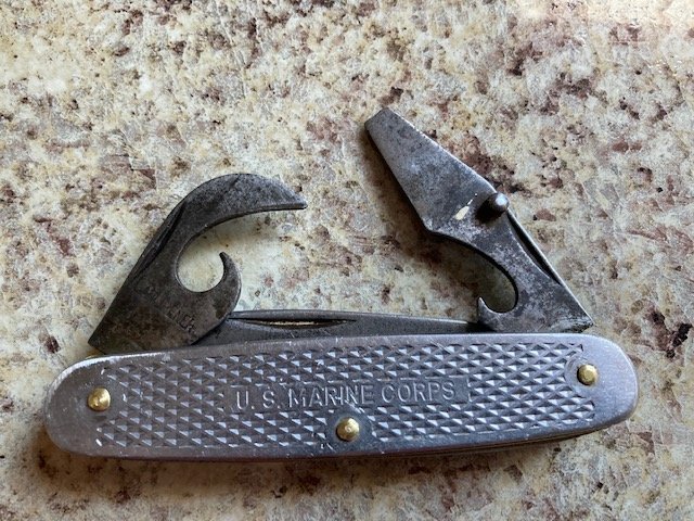

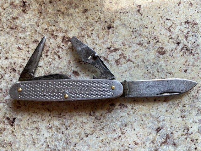

Utility knife
I had this old knife. I picked up years ago it had a broken spring on the can opener. I was fooling around looking for something to do so I took an old mower blade and made a spring. It snaps really hard, it works!! ::groove:: But Later I am going to remake the spring. I just wanted to see if I could use a mower blade.
Thanks for looking
Nev

Nev52 wrote: Fri Feb 11, 2022 3:29 pm Utility knife
I had this old knife. I picked up years ago it had a broken spring on the can opener. I was fooling around looking for something to do so I took an old mower blade and made a spring. It snaps really hard, it works!! ds:: But Later I am going to remake the spring. I just wanted to see if I could use a mower blade.
Thanks for looking
That's a great idea Nev. I've got one of those by Camillus I think is the one, that has a broken spring. I just may have to give that a go when I get set up again.... ::tu::

Thanks David,
It is working so far ::tu:: With the mower blade I don't think you have to temper the spring. But I am not sure on that. Maybe someone on here is a metallurgist and can answer this question.
Nev
Thanks for looking
Nice save Nev, ::tu:: very innovative! 8)

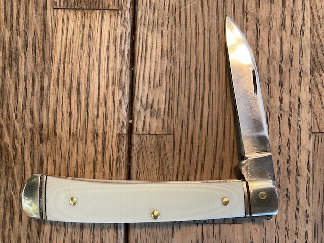

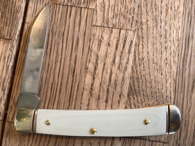

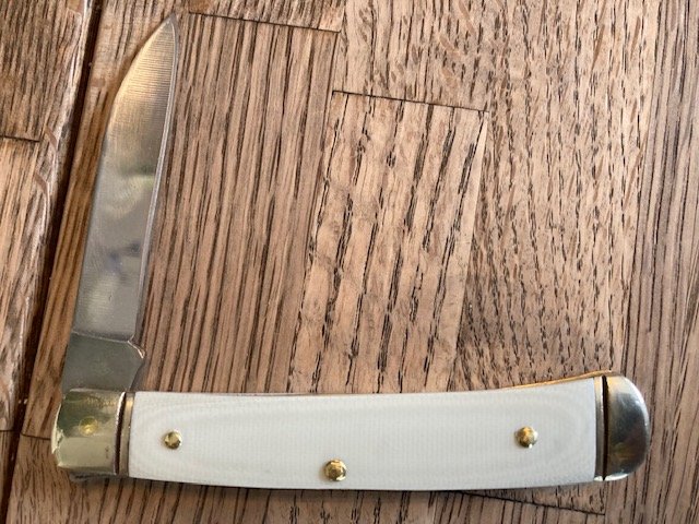

I did not want to make a new post just for this. I made another Wharncliffe single blade trapper with white micarta scales. I think it turned out pretty good. I am really liking the Wharncliffe blade. ::tu::
Nev

Lookin' good Nev! ::tu:: The covers are beautiful and the wharnnie blade just sets it off! ::nod:: Very nice, and not even my style of knife! 8)

Post by Nev52 »
Thanks Marco,
I tried the white micarta again. This time I used a tip from (OLDE CUTLER) He told me to use Brasso and Flitz to clean up the micarta. Those scales were a gray when I got done. Put on the Brasso wiped it off twice. Then hit it with the Flitz polish and presto back to white. ::ds::
Another great tip from a fellow member. ::tu::
