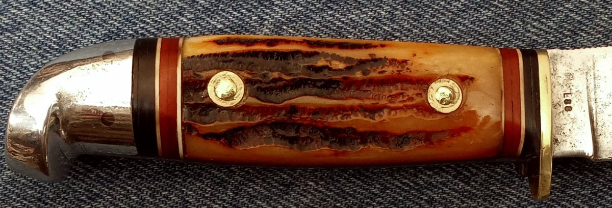

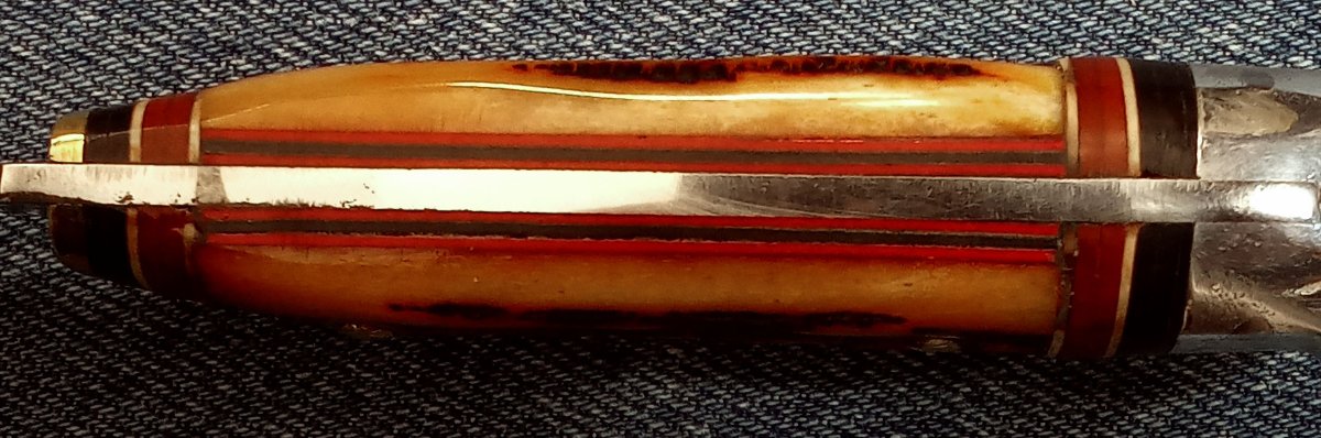

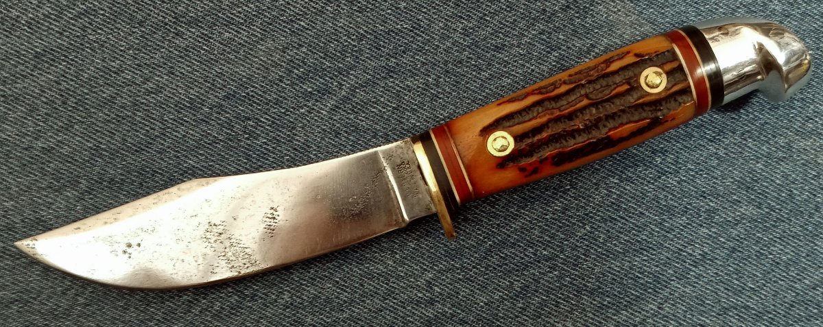

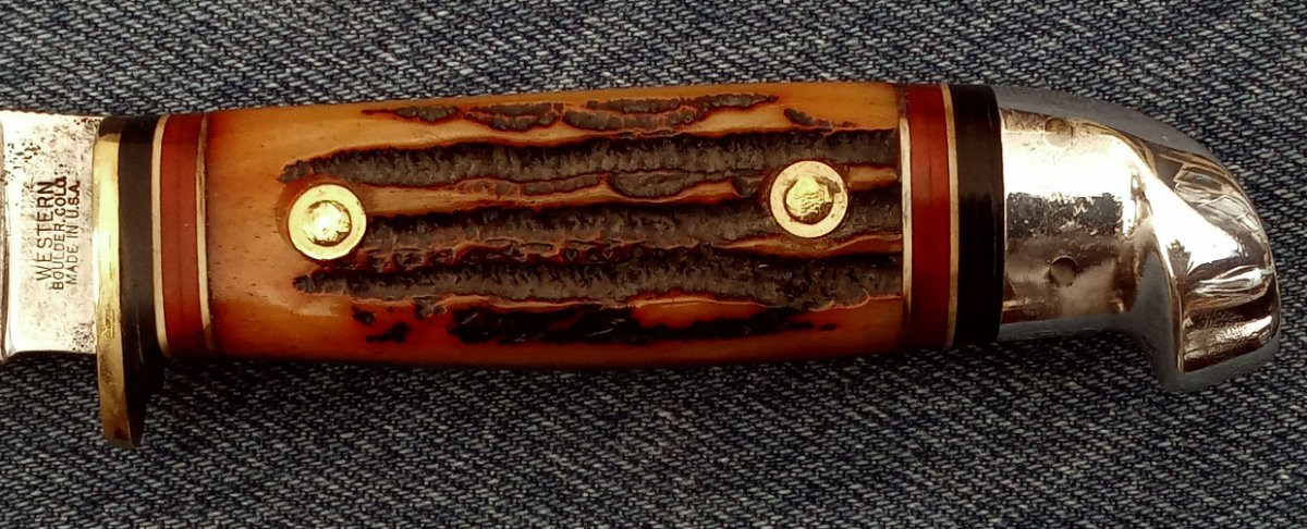

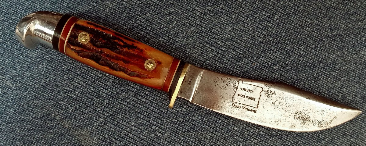

I wanted to post this and see what you guys thought of this pin & handle treatment?
No way to get rid of all the scratches and surface pitting without taking a lot of metal away so I cleaned it up, got rid of the rust, but could not find any cutters rivets the right size. So I did it the old-fashioned way with brass pins and washers, and then peened them into place.
The handle material is Culpepper’s goldenrod CSB. The CSB wasn’t quite thicken enough so I built it up a little bit with some spacer material. I also made the sheath because I didn’t have one that was right for this knife.
I would like your opinion on the old-fashioned pins and what you think the overall presentation. I appreciate the opinions of AAPK members, especially those who post regularly in the Knife Creations and Repair Forums. I know you guys are pretty good judges of knives, and many of you have tried some of these methods I attempt, or maybe now you will try them! I love the exchange of ideas we have in this forum!

Dale, I think it looks real good! Better than new. As a matter of fact, the only problem that I can see with it is that it isn't in my fixed blade knife box.orvet wrote: ↑Sun Feb 13, 2022 11:29 pm I wanted to post this and see what you guys thought of this pin & handle treatment?

Very attractive.
I really like the spacers.

I like everything about it. Its a beautiful knife. The rivets gave a nice throw back old school vibe.

I like the old style look, and the spacers by the tang.

Outstanding workmanship!
I haven had a chance to try any spacer material yet but its on my list. Is the spacer material Micarta or G10?

I love the looks of it. The spacer material is well done and improves the overall look of the handle.
The only minor flaw that stuck out to me is that the peening on the pins looks a little rough in spots.
I have "cheated" on some of my pins and sanded them with a Dremel tool, then used a bullet-shaped polishing bit to polish them.
I have only done it when my pins looked rough, and the rest of the handle looks great.
Then again, the look of your pins show that this was done by hand, and they don't have to be perfectly domed.
Either way, it still looks better to me than rivets.

I really like the look of the bone and black and red spacers. They complement each other. Great choice of colors.
Knife looks Great!!
