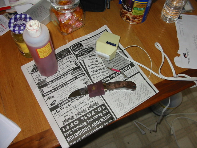

Here I have everything laid out to make the mark. I use an etchomatic etcher and stencils bought from Ernie Grospitch. These are great stencils and if anyone is interested, I'm sure he won't mind me refering you to him. Just give me a pm and I'll shoot you his web address.
The finished mark:
And here is the finished knife.
