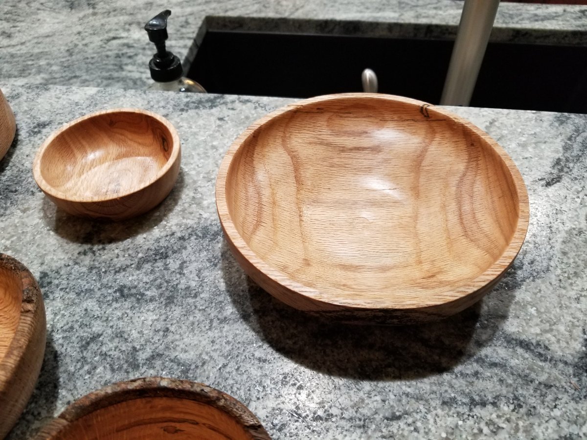

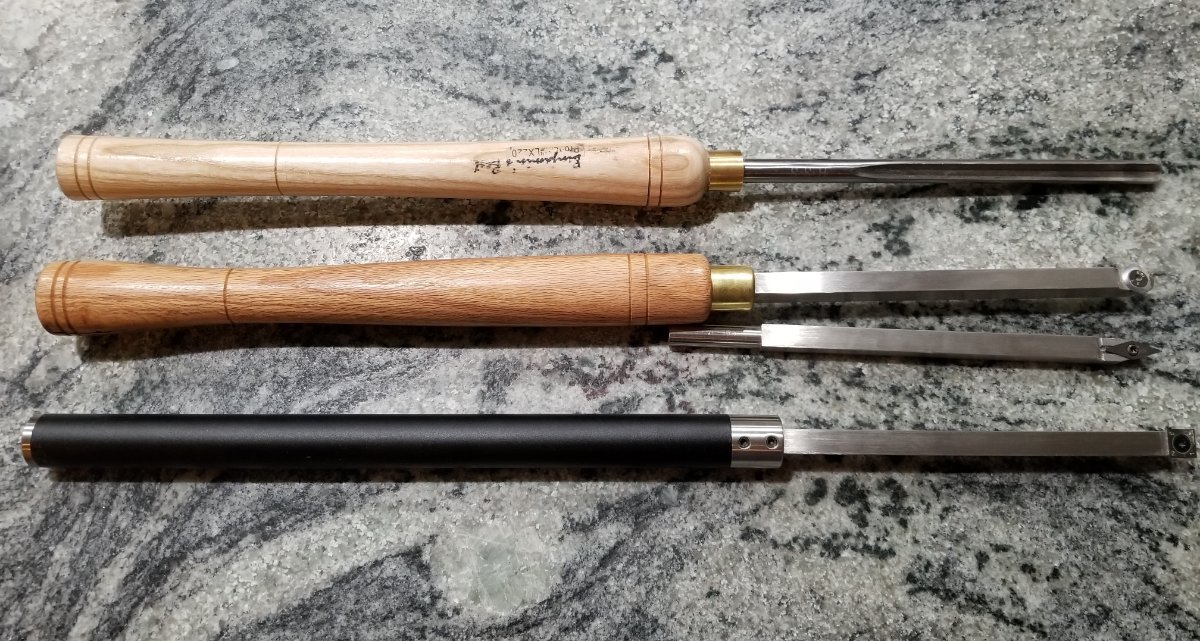

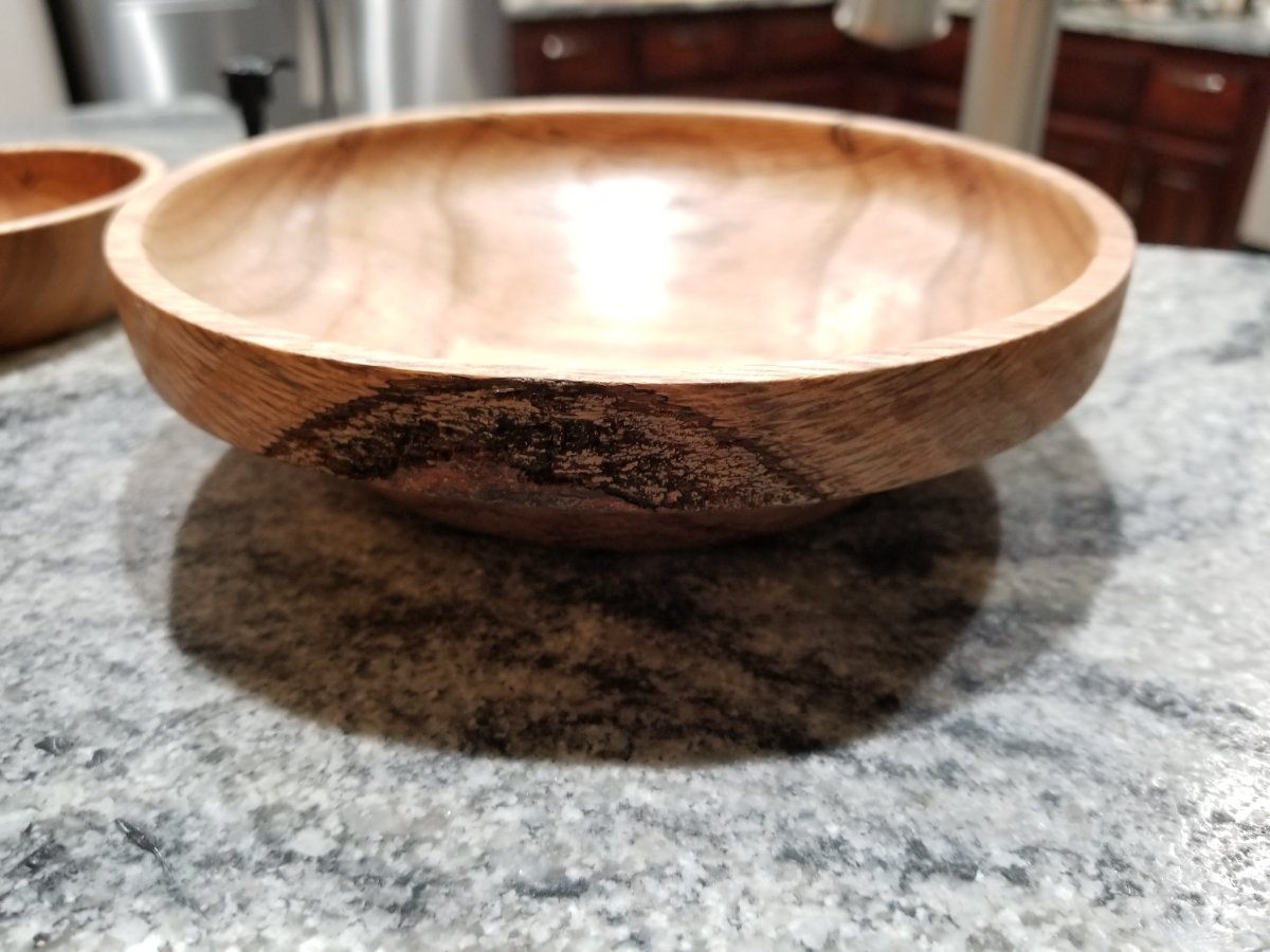

Post by Unk »

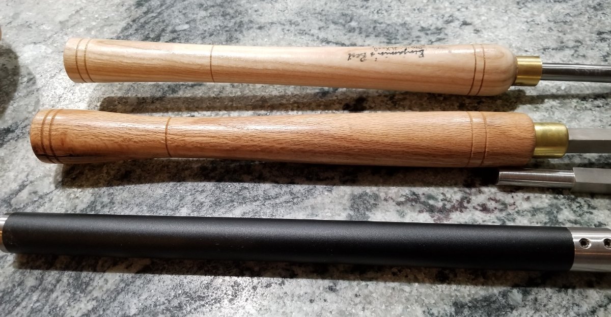

Really enjoying the lathe. I picked up a new live center along with a Jacobs chuck, and some carbide chisels. The carbide set had 4 tools, but only 1 handle. It is a little cumbersome to swap the handle when you want to change tools, so I made my first wooden tool handle (the middle one in the first two pics.) I bought the brass ferrules from Amazon. I will make a couple more so that I don't have to swap handles. I have also been practicing turning some live edge bowls.

Mike, I like!!

Wow Mike you have been busy. First make your own handles for your tools and then turn out some beautiful bowls. Wonderful work and thanks for sharing. ::nod:: ::tu:: ::tu::

Post by Unk »
Thanks guys.
I watched a few Youtube videos on making tool handles, and I used the "Benjamin's Best" handle in the picture to copy the design. One of the video's said to drill a small relief hole in the handle to expel the air and excess epoxy when you push the metal chisel into the handle.....as it kind of makes a syringe effect. I thought, nah, I don't need to do that. ::doh:: When I pushed the handle in, it kept sliding back out due to the trapped air. So I did indeed have to drill a tiny hole on the back side of the handle to relieve the air and epoxy. I finally got it seated, and pressed the air and epoxy out of the hole.
And I also clamped it longwise, just to make sure it stayed seated.
Learning as I go....

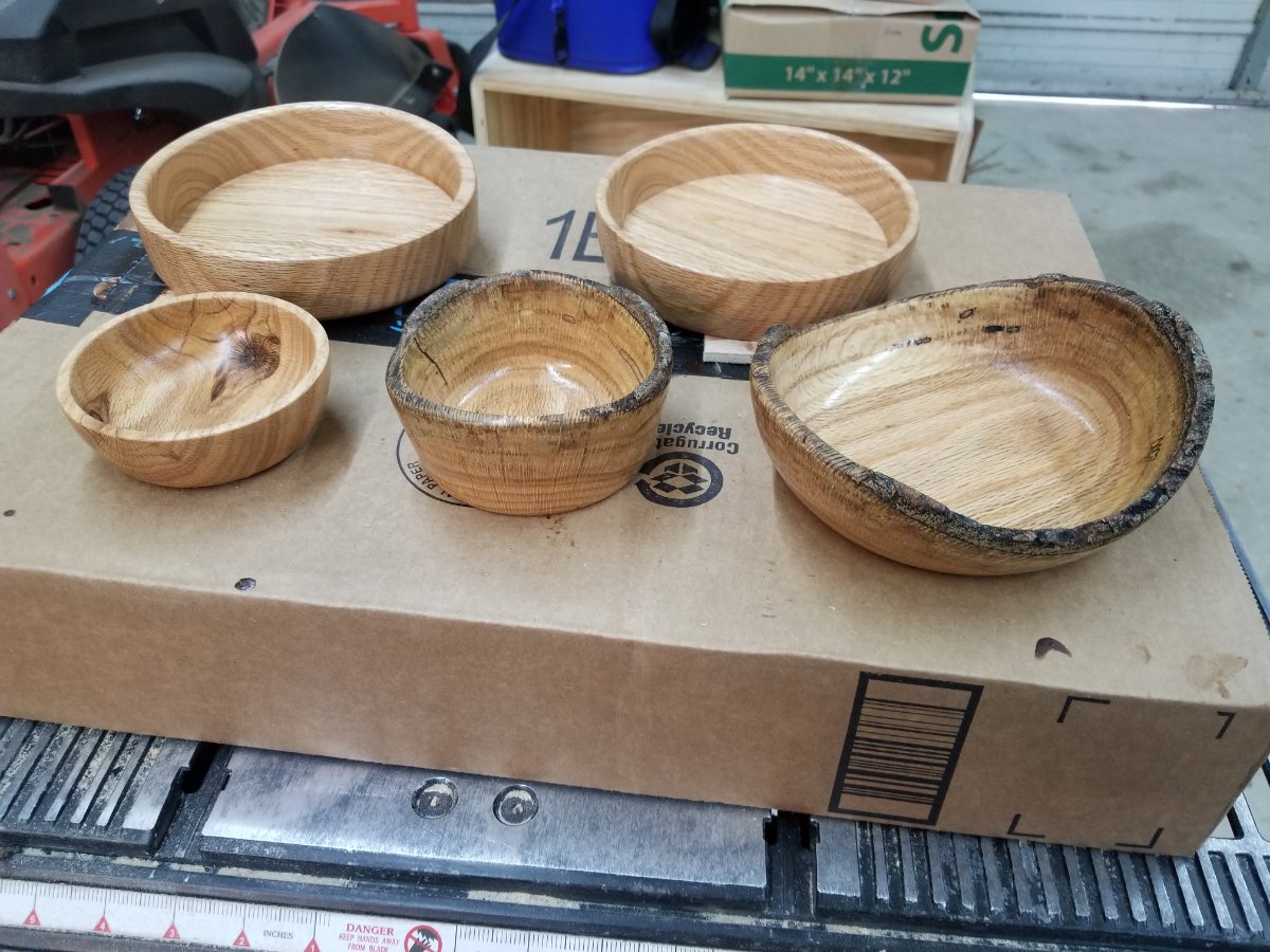

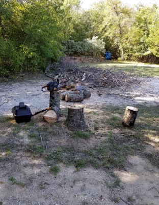

The oak tree I am using died from Oak wilt disease. I took it down this fall. The pic below shows what my bowls and handle looked like a few months ago:

Re: Wood Lathe
Post by keithlong »
Nice job on the tool handle and I love the live edge bowls. The best wood for live edge bowls is green cut wood that is cut in the winter when the sap is down in the wood, makes the bark stick better on the edge. When I make my tool handles, I buy 1 inch copper pipe couplings and cut them in half, making 2 ferrals.

Post by Unk »
Thanks Keith.
I checked out a few videos where they made the ferrules out of copper pipe, and had considered doing that. Then I saw these ferrules and I like the rounded-over top. They are pneumatic hose ferrules - Here's what I used:
https://www.amazon.com/gp/product/B00VT ... UTF8&psc=1

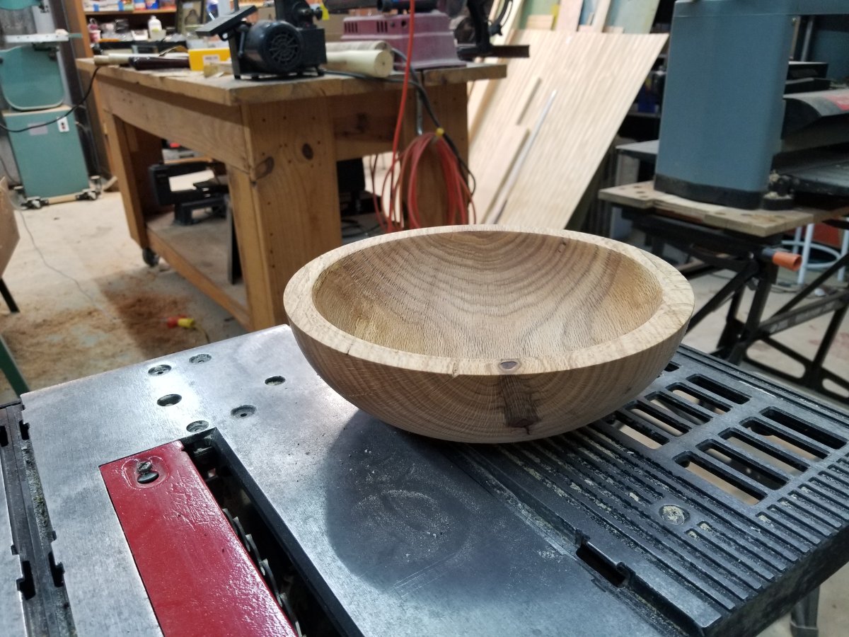

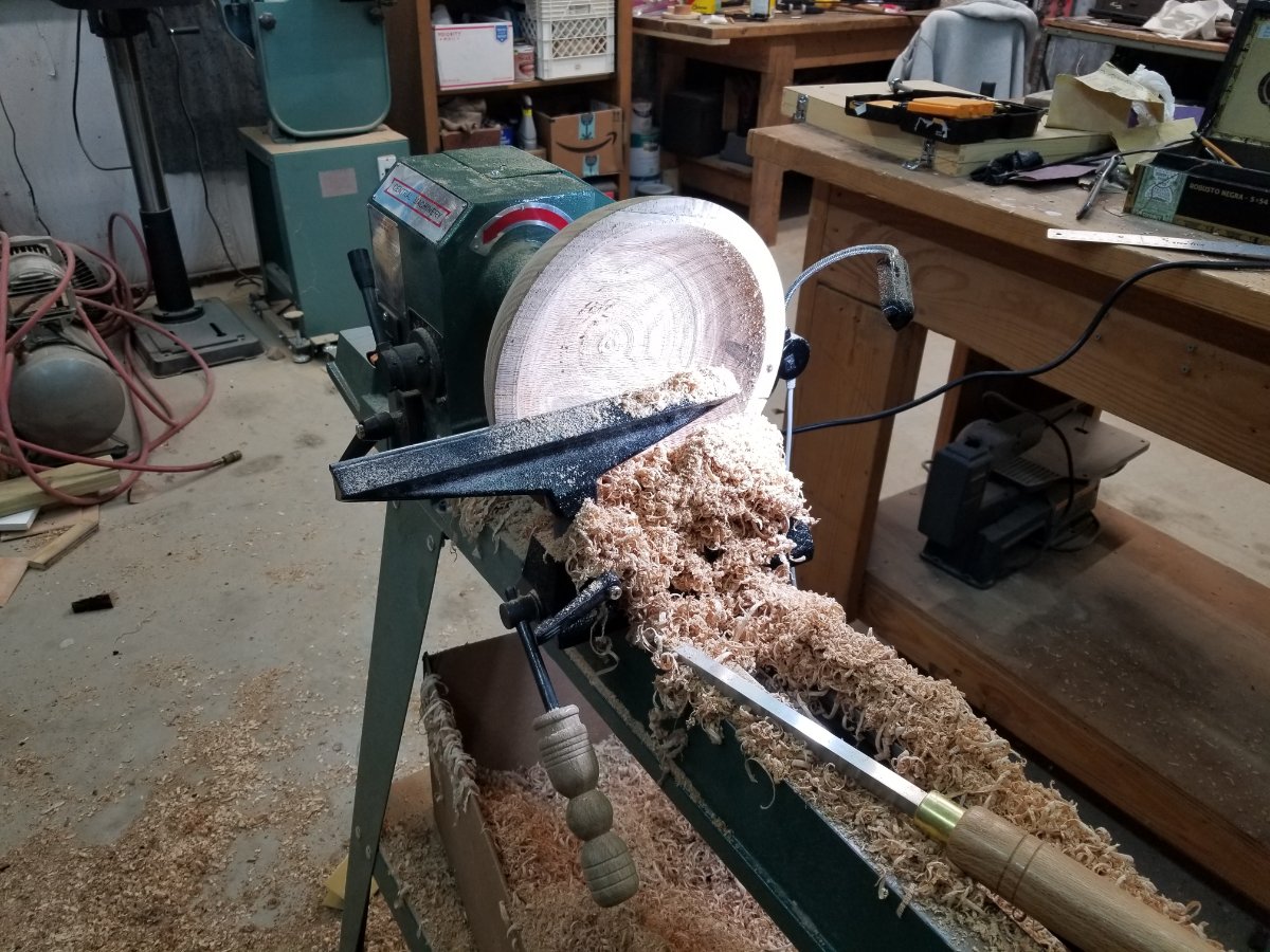

Turnin' and burnin'! :lol:
Rough turning a live oak bowl. I will let it dry for awhile, and then finish it.

You ar a bowl turning machine. Keep it up. I am waiting on warmer weather.

Don't want any trade secrets, but what will you finish it with. ::tu::

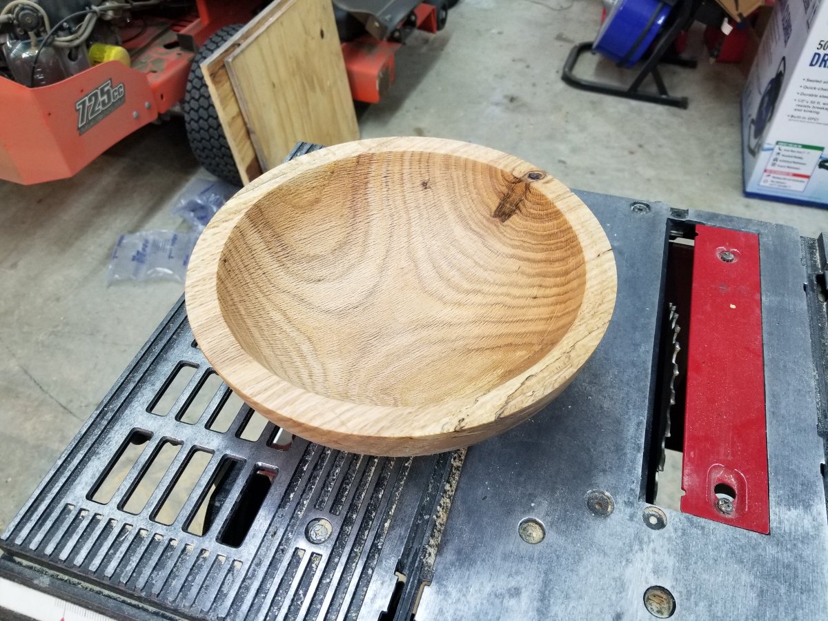

Hi Cudgee
I have been using several coats of Tung oil, and then some wax. I had some old Homer Formby's Tung oil, and recently bought some Minwax Tung oil. 3 or 4 coats over 3 or 4 days, and then some Johnson's Paste wax.
I went ahead and put a coat of Tung oil on the rough turned bowl - hopefully it will help keep it from cracking and warping as it dries. (see pics) I also ordered some Packard's wood end sealer - but it will be a couple of weeks until I get it.

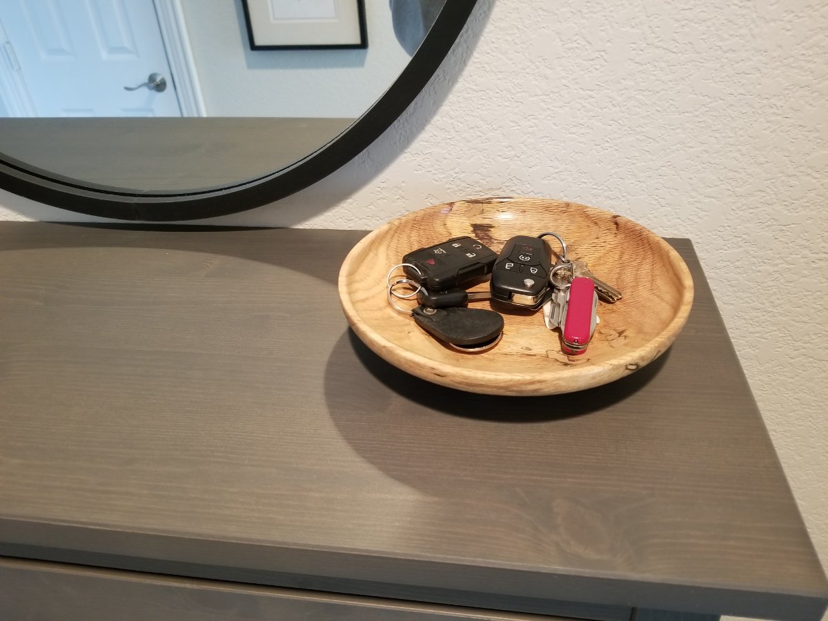

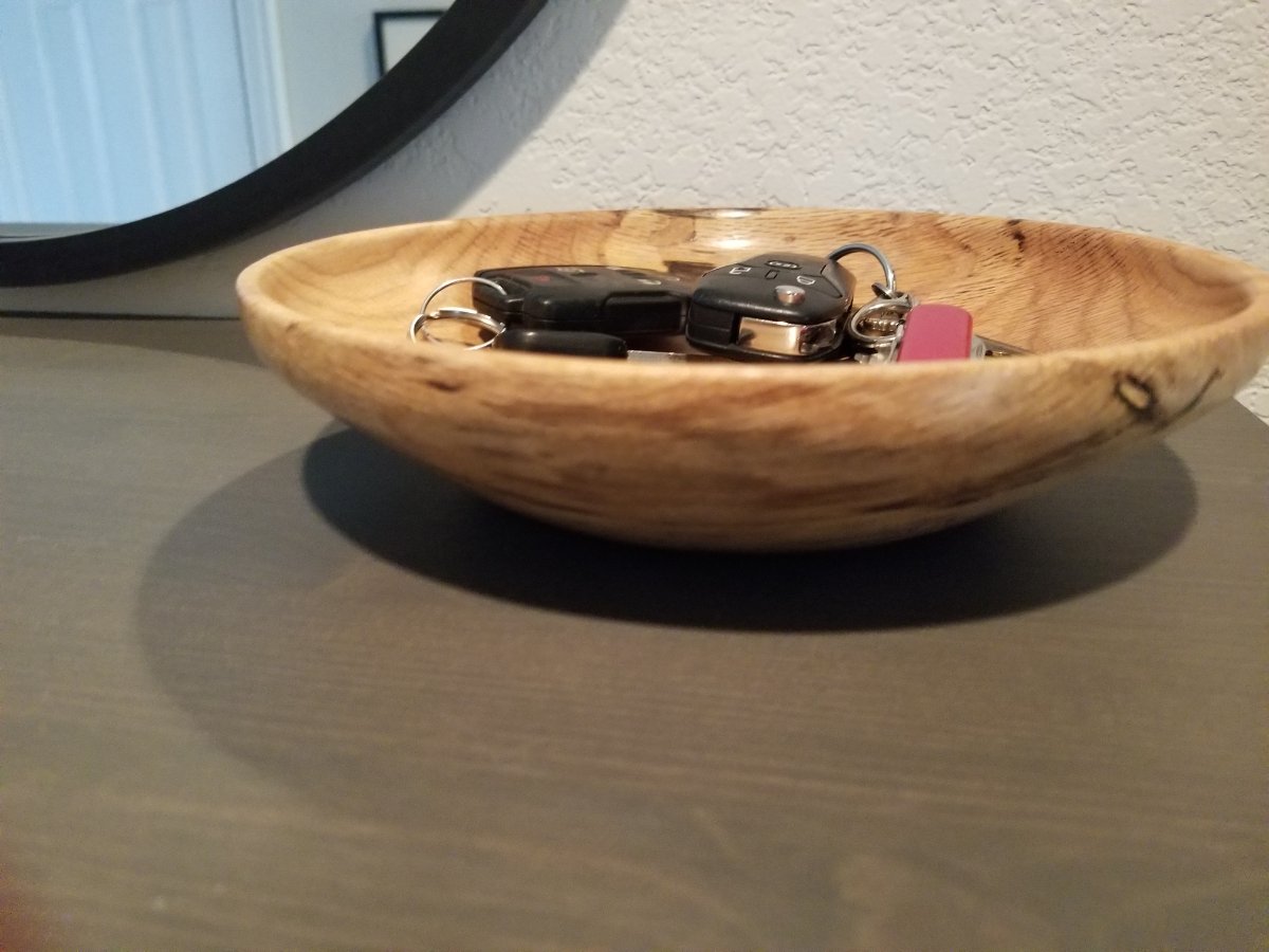

I also turned a little bowl to keep the keys in next to the front door. It has the tung oil and wax finish on it. (see pics)
