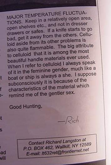

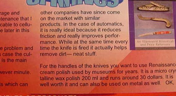

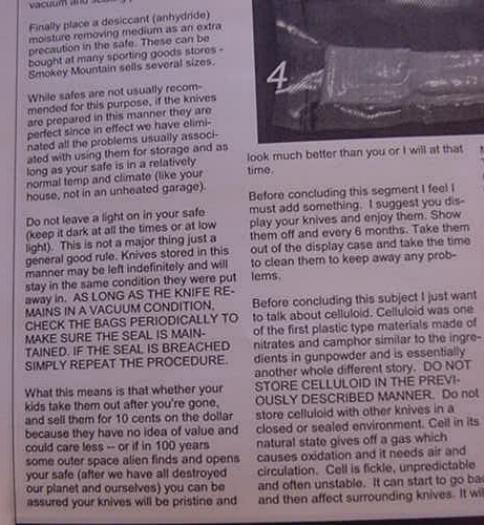

Hey Glenn I do not consider it off topic if You have knives especially those you wish to preserve it is good to know opinions on how to do it and why they can go bad. I am attaching an article I did a couple of years back hopefully it is legable. The end deals with cell and some of the problems it poses. If you need more or something more specific just let me know. Where ya been ? LT Wow what a nightmare to take pics of let me know if it makes any sense. Sorry. Again anything specific i can help with my pleasure. LT PS since after all this picture taking it is just confusing the problem . Cell is made of Camphor and nitrates nitrates are essentially SHI- literaly this is part of what gunpowder is composed of. It is also a favorite product for terrorist bombers. There fore like most of these aforementioned idiot zealots the products made from it tend to be a bit unstable. Celluloid gives off acetylene gas. if kept in a closed area it builds up and affects other artifacts in the area exposed metal rusts other cell starts to deteriorate. Cell can be affected by most any thing temperature, light, possibly even PMS. Often cell not washed correctly when made will all of a sudden start to turn in what looks like a gooey cancer or the picture of Dorian Gray. Keep it at a constant room temperature dark is better than light, sunlight has the same effect it does on vampires. well ventilated DO NOT store in a roll or closed drawer. Try to store cell knives seperate from others when one starts to go either throw it away or get it rehandled but segregate it from the others ( perhapes quarenteen is a better word. ( if i could spell it ) . Then when you have done everything possible just sit back and wait for you next cell knife to simply decide to go It will if it wants to no matter what you do. If I get one on ebay which has the beginnings of the disease I get rid of it. Hey have I sent you any knives recently ( just kidding ). Try and read the article it won't be easy. This is just a cursory explanation so let me know what else you need. Oh yes Highly flammable, old knife companies stored this stuff in special building outside the plant they had roofs with hindges so that the buildup of gas could escape the stuff often burst into flame from just cutting it to quickly. All the companies were used to cell fires . New cutlers would be given a piece and told to make a handle then the old timers would watch him cut it to fast and burn himself ( some joke eh ). it is about the prettiest handle material ever made and the most dangerous . Just like a woman.

Great article LT.
Is there some place I could order a copy, like the magazine it was originally published in?
I didn't see it in the article, but is Renaissance Wax good to use on celluloid? I use it on most all of my knives, even ones I make. I like the fact that it helps to prevent fingerprinting on the steel.

members.aol.com/akaswitchblades This is the site for the outfit I write for you will enjoy it. Use nothing on cell except perhapes carefully a little clear cool water if you must. Other wise apologize for bothering it and let it go back to sleep in the dark room temp. around 70 F. LT Automatic Knife Association

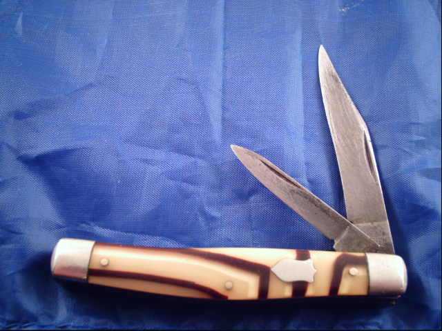

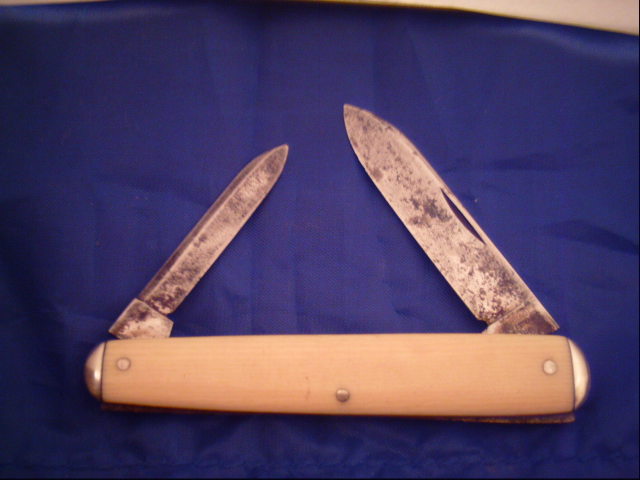

Here are a couple older cell handled schrades I just got home from an auction with, not bad for $10.50 each.
- Attachments
- Schradecut sleeveboard.jpg (42.96 KiB) Viewed 4886 times
- Schrade 234K.jpg (38.21 KiB) Viewed 4885 times

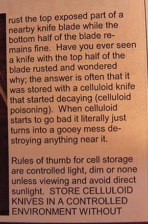

Hello everybody. I have a few knives that I ended up with in a collection purchase that were the unfortunate victims of be stored with celuloid that broke down.
I have seperated all the knives and cleaned well and oiled, removed the bad celluloids to the garage(hate to throw away, were some great knives) and have put the celluloids that have not imploaded in two wood knife cases(far away from my others). But my question is is their a way to remove the surface rust on some of the effected knives? Some of them I can scrape with my fingernail and get off a little bit, I think this is what is refered to as bloom? I have been leary on cleaning with anything abrasive as I didnt want to damage the knives further with ignorance.
I also have some super nice Hatfield @ Macoy etched sets that were involved, etching itself does not have any on it but has small "blooms" just under. Any help would be appreciated. Thanks, Jim

0000 steel wool and oil won't harm them. rub till rust is killed and oil heavily and soak. wipe dry/ that will stop the corrosion. remove all bad celuoid and rehandle or it begins all over. good luck. this is the way i have salvaged a few that were'nt too bad. good luck

All celluloid must be removed from the affected knives for now do not worry about the rust. after the cell is removed put the knives in soapy luke warm water leave about an hour. Then remove and put the knives in a bucket of cold clear water and leave another hour. Then remove in spect for no traces of cell other wise remove and re soak. when the knives are sans cell, dry as best as you can OVEN is good . remove when dry find a gallon jar with a top, fill halfway with Kerosene put all the knives in the jar and walk away. If you have a 8" grinder order a scotch brite 6" fine buffing wheel from Jantz or a similar place of you have a small belt sander order the same kind of belt. When the belt or wheel arrives. Put it on the appropriate machine and then remove the knives from the Kero. Then carefully buff the rust and polish the knife.( This is where I have almost killed my self ) not being real handy, when the knife is buffed oil with WD 40 . If the knife affected is NOT CELL and only the metal is affected fron contagon. Use the same procedure. except do not remove the handles.( caution use extreme care with temp and time for oven dry) If you wish to metal polish the knives dry the wd 40 and use Metal glow or just about any knife polish . Flitz is good but very aggressive. Try a couple see what you like . For handles ( NOT CELLULOID ) I highly recommend renassiance wax. Expensive but excellent . Take your seemingly unaffected cell knives out of the enclosed cases gently wash the handles in cool water dry by hand put them on an open shelf in room temp out of direct sunlight dark is even better but definitely open air then just keep your eye on them do not leave in an enclosed container especially after having been exposed to the other knives. Try not to put them in the proximaty of other knives, After a year or two if they have not gone bad you have corrected the situation ( er maybe) You can wd 40 the steel but try to avoid the cell . If these knives came in a roll unless it is an antique I would throw it away if it contained knives that turned. As far as etched knives well most factory etchs are electro or photo electro. So you have to decide whether to dick around trying to do the best you can, you can live with it or say the hell with the etch and just buff the blade or sell them explaining why you are getting rid of the knives. Depends hpw finicky you are and what you can live with. Regarding the original knives with the bad cell if you wish to rehandle modern cell is sold however you might want to consider jigged bone scales . I do not reccomend plastic or modern materials it just to me never looks right on an old knife. If you are not into rehandling if the knives are rare and you have them back in shape they make great swapping material for old displays and knives ect. Especially rare patterns. Now this is an optimum procedure oil steel wool rust erasures will all work to a certain degree. Of course there is my usual method I get ticked off and take it to an expert who usually is a friend he pours me a drink calms me down takes the knives makes them all better and has me pick them up. I hope this helps LT
