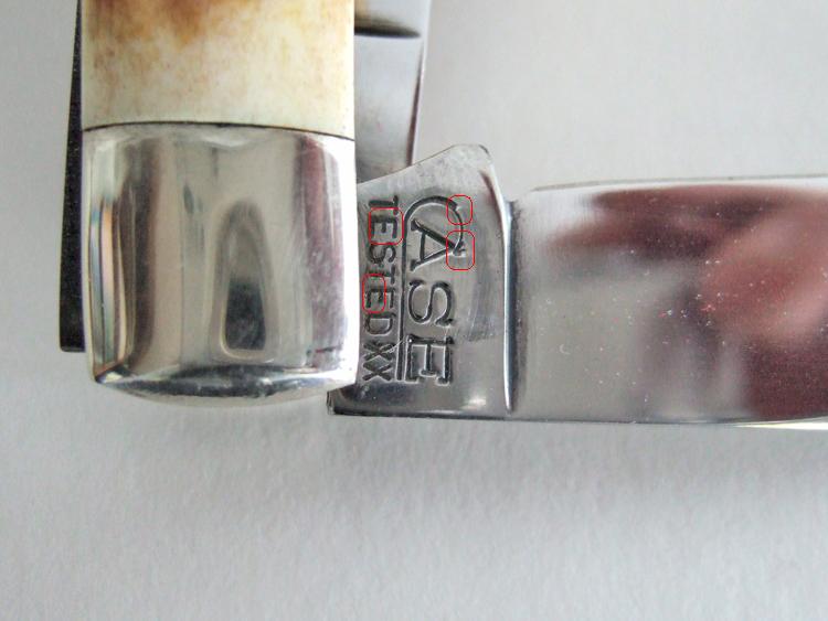

I hate to tell you, but not only is the tang stamp not right, I think the handles are in question now that there are close up pics. Look at the tang stamps on this link. Yours isnt there...sorry.

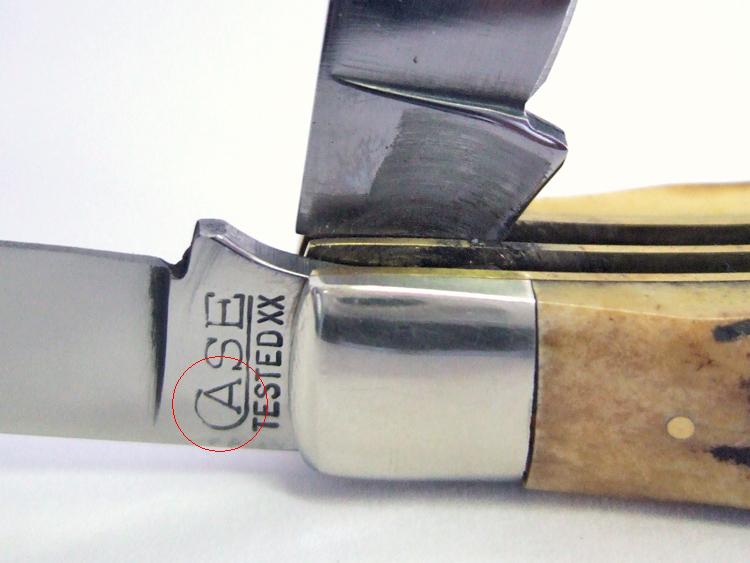

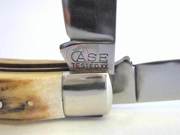

I have highlighted the dead give aways for why this is fake, The C's on the blades are different from each other for one, And the mis-stamp runs the C into the A in one picture. The E's are stamped in funny as well. You would think the knife itself would have the same exact stampings if it was authentic would you not? Oh and I noticed after I posted them, compare the S's in each stamp, they are different as well.
100% FAKE

Sorry Roger I dont see it, the C's on both tang stamps on this knife are wrong, just my opinion.
Little Rock
Posts: 15
Joined: Fri Sep 02, 2005 6:58 pm
Post by Little Rock »
Hey friends, I realize a picture says a thousand words but here are a few to help with the fake stamp.
The stamp on the knife appears all wrong. The "C" with the straight line over "Tested XX" has a definite check mark out the top also the "S" has a small uptick to it. This could be worn but does not seem like it. Also the "E" should be box like with square edges and straight on the top. Also the "Tested XX" underneath the line of the "C" is all out of line. Below the "S" the "E" should be at the beginning of the bottom of the "S" and the right side of the "S" should be over the first "X". Way off.
My opinion and enjoy the discussion.

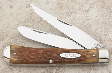

The stag does scream fake, but that aint the half of it. As a long time collector of vintage Case Trappers I can tell you that a tested era trapper should only have one tang stamp on the master blade. They don't even have pattern numbers. Beware of the tested trapper with any marking on the spey blade and that includes a pattern #. The tested trapper has a very striking slim racey look about it with a nice formidable looking upswept blade. Once you've seen one you want forget it. These trappers that are in at least excellent condition commonly command prices in the thousands of dollars. Needless to say counterfieters find them very lucrative. They are also one of Case's most conterfieted knives so be careful folks. Just so Thermageek will know what the real thing looks like I'm going to send Brian a picture and let him size it down. Everytime I send one it's big as the side of a house.
Take Care

Blade Runner's trapper... :shock: ::drool::
What a beauty this one is. Thanks for sharing kind Sir. ::tu::

Wow!!! That is a beauty.
Now I have a question, is that a muskrat blade or is that the regular trapper blade of that era? I still get confused about them.

Hi Joe 62, This is this the usual blade in the tested era trapper. I think it is one of the best looking blades in all of knifedom. In my opinion true muskrat blades are only in U.S.A. era trapper(1965-1969). There are some folks that say a few can be found in the XX era and the 1970 10 dot era, and to be sure there are a couple of different blade widths in these eras one of which is slender. The true muskrat blade sits lower in the frame, which can be best viewed with both blades fully opened. My contention is that alleged muskrat blades in the xx era, and the 1970 10 dot era are not only shaped different but do not sit low in the frame(at least not the ones I've seen to date). If you insist on calling the xx era and the 1970 10 dot slim blades muskrat blades then at the very least you must admit that they are a little different than the true muskrat.
Take Care
Blade Runner
