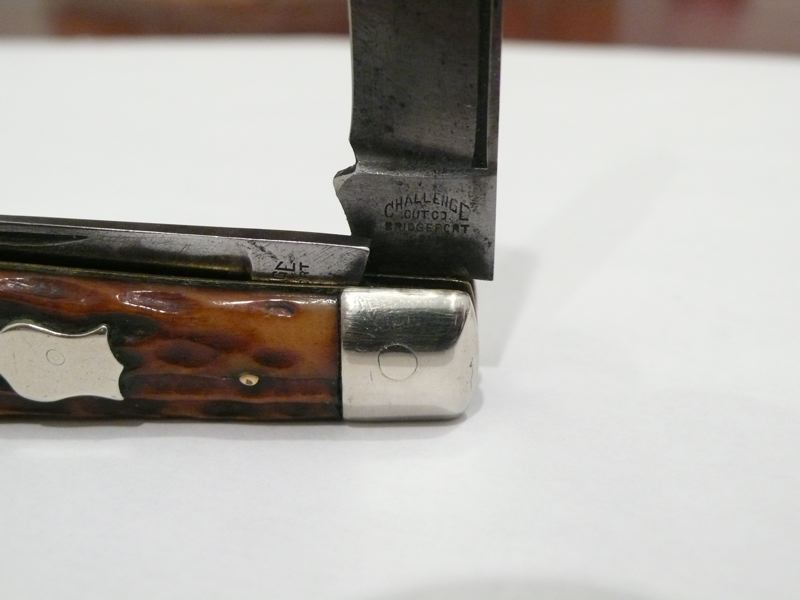

Ok- so I have this Challenge Teardrop Jack. Nice enough knife, except that the main blade has some wobble at full open position. The secondary blade is tight. Perfect, actually.
What does this likely mean? Do I have a broken pin, or is this something that might be fixed with a light peen? If the peening might work, would I peen the mark side or the back side, or does it really matter?
As seen in the photo, the pin on the mark side is actually raised above the bolster- microscopically so, but you can feel it. Seems probable this knife has been taken apart and put back together at one time.
I'm pretty sure I could do the peening without causing any undue heartache, if that would do the trick. Anything else and I'll have to wait until I get to to speed with repair techniques. I've just gotten a few old beaters to take apart and re-assemble, just to get learning.

what has happened, in my less than expert opinion, is something like this. Think of the pivot pin on that side as a T shape, with the vertical part of the T the part than runs through the knife. the cross of the T is the Peened area. this area holds the blades tight. over time, this T ends up looking more like a Y, which allows some side to side movement in the blades. this may be more evident when the blade is open, if the tang is slightly beveled. putting in a very thin shim, or slackener, then peening it back to our hypothetical T would likely tighten up your action.
I'd get some more opinions before you go and take mine though

I think that if the small blade is tight, what might have happened is wear to either the pin or the pivot hole in the big blade....imagine that most big blades get used 2x or 3x to every time you use the small blade. This means that much more wear. If the pivot hole in the blade has enlarged a bit (or the pivot pin has eroded), this can translate into side to side movement when open.
Or, during manufacture, the large blade had a slightly larger hole drilled...resulting in a wobble right from the start.
Or, the large blade has been "pried with", which could raise the edge of the peened pin up a bit. I've done this when I haven't peened very well, and then ground off too much of the bolster and pin during final polish and shaping. (ie the resulting peen is too thin to resist the force from prying) Look at the bolster from the side and see if the pin looks like a cup (like a contact lense sitting on the table). If so, you might be able to rectify with some peening and polishing.
Or, a combination of the above. Particularly if the small blade is just fine.
Is this happening? well, I can't tell you without taking the knife apart. You could always do a very light, repeat very light, re-peen of the pivot pin. (either with or without a slackner) and see what happens. Either the blade will get tighter, or it won't....
If it was me, and I didn't care about the result, but was more interested in experimentation, then I would peen a bit and see what happens.
Orvet?
Muskratman?
Rigwelder?
anybody else?
D

This talk of T's and Y's makes me realize that I might not have the first clue, really, as to what the insides of this part of the knife look like and how it fits together. I mean, I have a gist, but maybe the pin functions differently than i suppose? Anybody have a photo of this end of a knife taken apart, pin(s) and all?

I was just trying to illustrate without the aid of any kind of graphics
It's tough while I'm at work sneaking AAPK peeks on the laptop
When I get home, I'll diagram something up for you real quick that kinda explains how that stuff is laid out, unless someone beats me to it. D and I are both talking about the same thing for a bit, but he does bring up a good point with pivot hole being a bit bigger, or the pin being worn. that can definitely happen
*edit* home now, this should maybe help illustrate what we were talking about

I think Jaye has pretty well covered all of the likely scenarios that have caused your pins to loosen.
I think the most likely possibility is that someone has pried with the blade. That seems to me to be the most common cause of side play in a blade. I doubt your knife has been taken apart, but it is hard to tell, especially from the picture.
