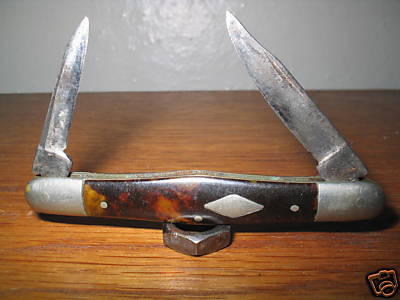

This is the knife I am interested in; touching up the celluloid on; an older Shapleigh DE. It doesnt look like any shrinkage; but scales are to scuffed up; not trying to make them look new; just a little better. Thanks.

careful polishung first by hand then a buffer can make those handles look dang near new.

I agree with MM, just don't let the buffer get the celluloid hot - don't lean into it. I don't like the Dremel tools for this (celluloid), I use my buffer. Dremel tools can make the finish look uneven.
